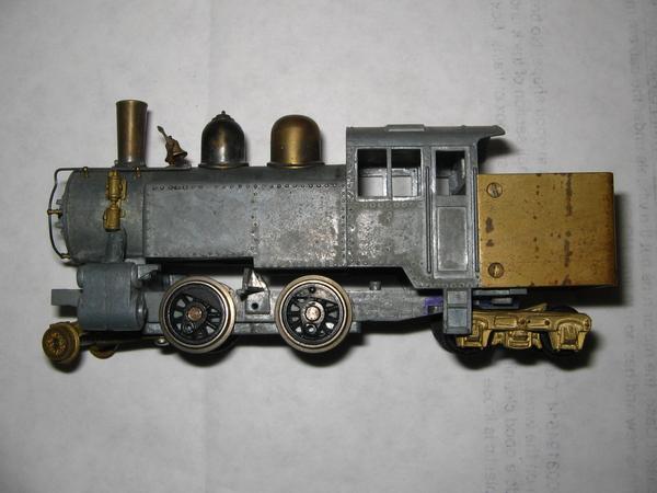

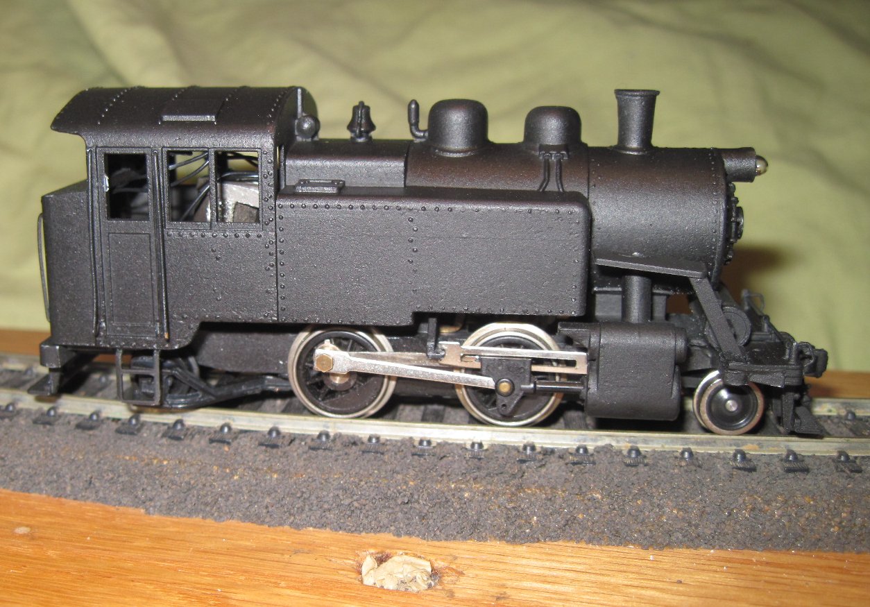

Do not use the standard Mantua 4-6-2 trucks as they are too long. Here is what I have done in the past; I have used the Athearn Little Monster 0-4-2 trailing trucks and a cut down Athearn Genesis 2-8-2 pilot & trailing trucks. The trailing trucks were a little large and required a significant amount of grinding of the Mantua chassis but worked well when done.
Examples below:
Little Monster trailing & Genesis pilot truck / 1 Genesis pilot deck Parts:
Genesis trailing & Genesis pilot truck / 2 Genesis pilot deck Parts:
A kitbash I acquired that is really neat and a 2-4-4 to boot!
The Athearn / Mantua kit bashes I did myself and the total time for each was less than 4 hours on each, start to finish. I started with shifters that already had broken off steps and ground the original pilots down uuntil they were stubs/tabs that I could mount the replacement / extended Athearn pilot decks & steps to. I sold each on eBay. The first sold I think for ~$50 and the other sold for $110 some two years apart. I have plans to make more.

Since I did both, I have to say, yes, Athearn, but the Little Monster trailing truck looks the best. It actually has a thin small frame and was designed to fit under a smaller locomotive. The trailing trucks without an external frame look kind of funny if you ask me.

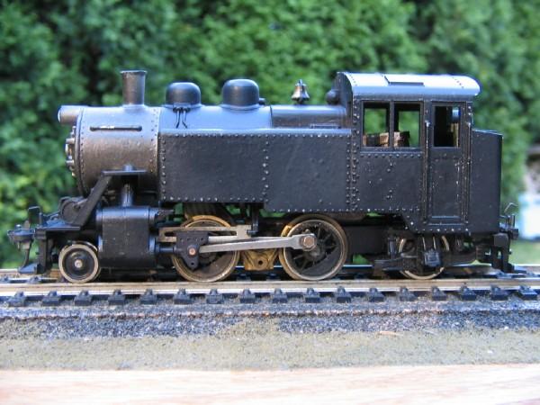

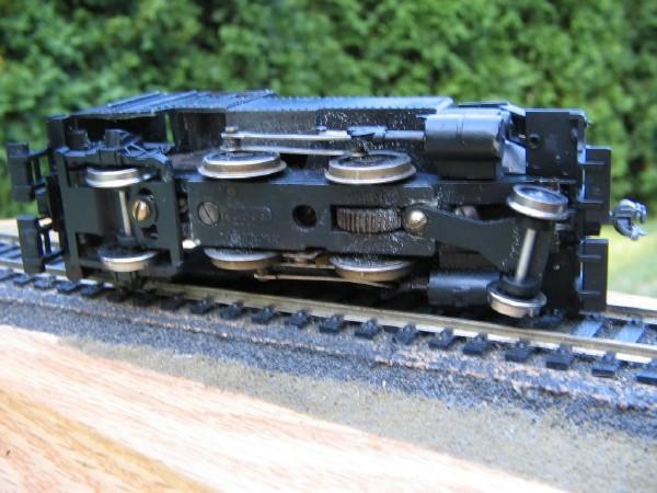

I think most Columbia types had trailing trucks with inside bearings.

my little columbia ken
love this sean simple but nice
