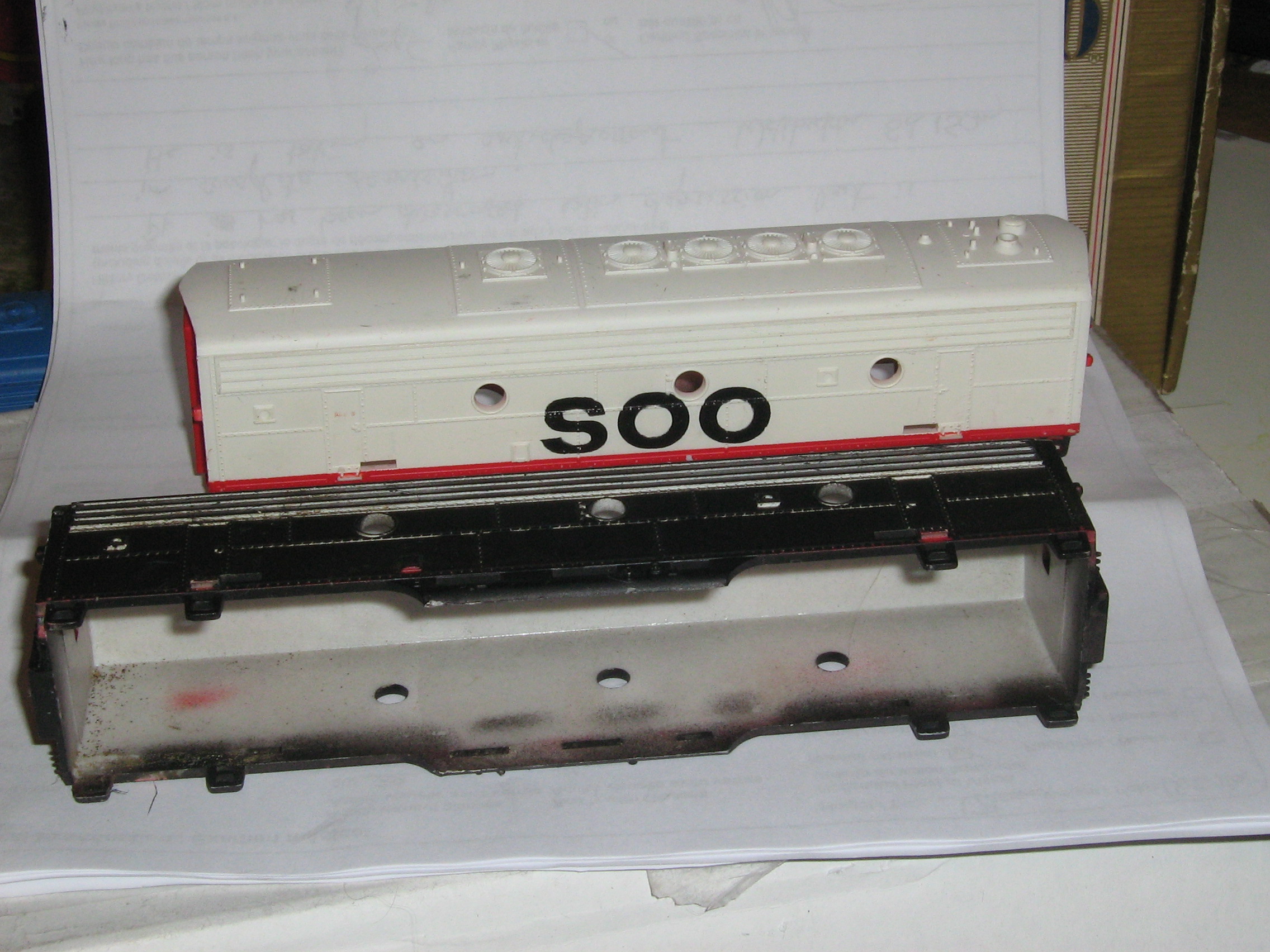

Hey John:
Not sure when the shells date from... the pancake sounds more recent.... I think I have some pics of the two "B" shells...
There you go...

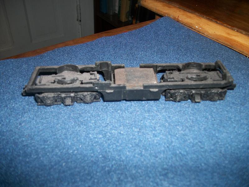

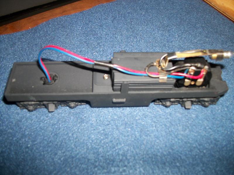

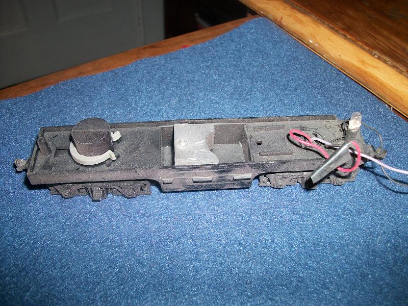

Gareth,
Here ya go to the point of finding the other frame as I have one missing for you to see, (I got to find it!)
^------Powered "Pancake"
^------Dummy, but possible power with DC-90.....
^------"pancake power" era dummy.
I'll post the true DC-90 powered one when I find it! (I alot of times replace the whole frame with an Athearn F-7 frame, which run alot better, except for the Hi-Fi frames......

Gareth,
As far as I can tell with the dummy "pancake" style is the fact that the pancake motor housing is there, but has NO interior to it, its simply holding the wheelsets in place, and they are plastic! without traction bands on them, as the powered version, has plastic drive wheels, BUT have traction bands on them. The opposite truck has metal wheels and pick up power to power the motor.
These frames are identical!
The Ones I have, are of the older type that had the DC-90 motor on them, I have pictured, a "dummy" version of this frame above. BUT those 2 types of frames are pretty much the same, Just the trucks have no gearing, and the motor is missing, and the weight is different sized.....

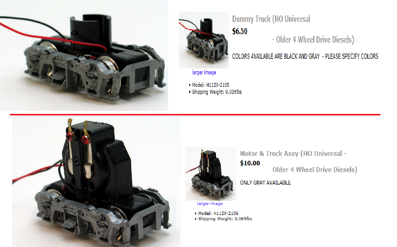

I wonder if the older Bachmann replacement parts will fit these Life-Like engines.
The power trucks are sold out right now. The side frames are better than the originals.
It may be possible to take two dummy trucks and make a dummy engine. Their trucks
seem to have metal wheels.
