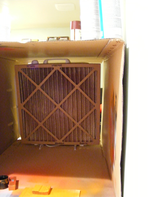

IF the weather outside is right (aka warm enough and not too humid). I'll pull the car out of the garage and spray in there. The floor is pretty messed up so I'm not that worried about overspray. And even with the door open there is no wind or drafts that come though. Once done spraying I take the part into the basement to dry and leave the door open just so the garage vents a little.
During the winter however is when I work on more models, so I have this.
Its a bad picture. But its a box I cut up and fit a box fan in one end pulling air through (on low, if you use high the paint bypasses whatever your trying to paint). In front of the box fan is a cheap 20"x20" furnace filter I had laying around. With the box fan on it holds the filter via suction and takes over-spray right into it. I bigger filter or small box would be a bit more ideal and it would close off the gaps you see. But look way up on the ceiling in the photo. My basement was built as a smokers lounge for the previous owners. Hence they installed a standard bathroom fan down there. After I'm done spraying something I let both fans run for at LEAST 15-20mins afterwards to clear any hint of fumes. Works like a charm!
