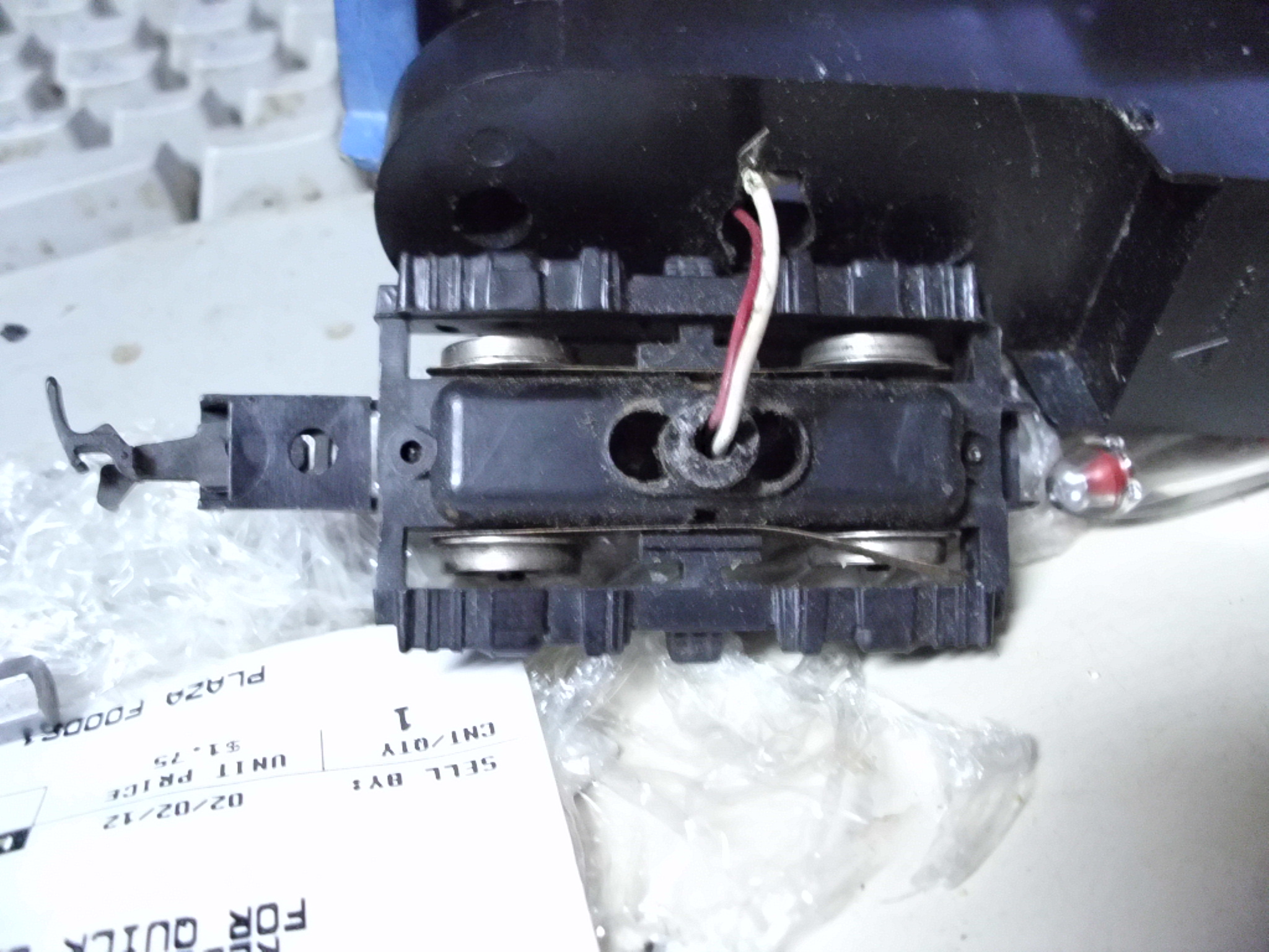

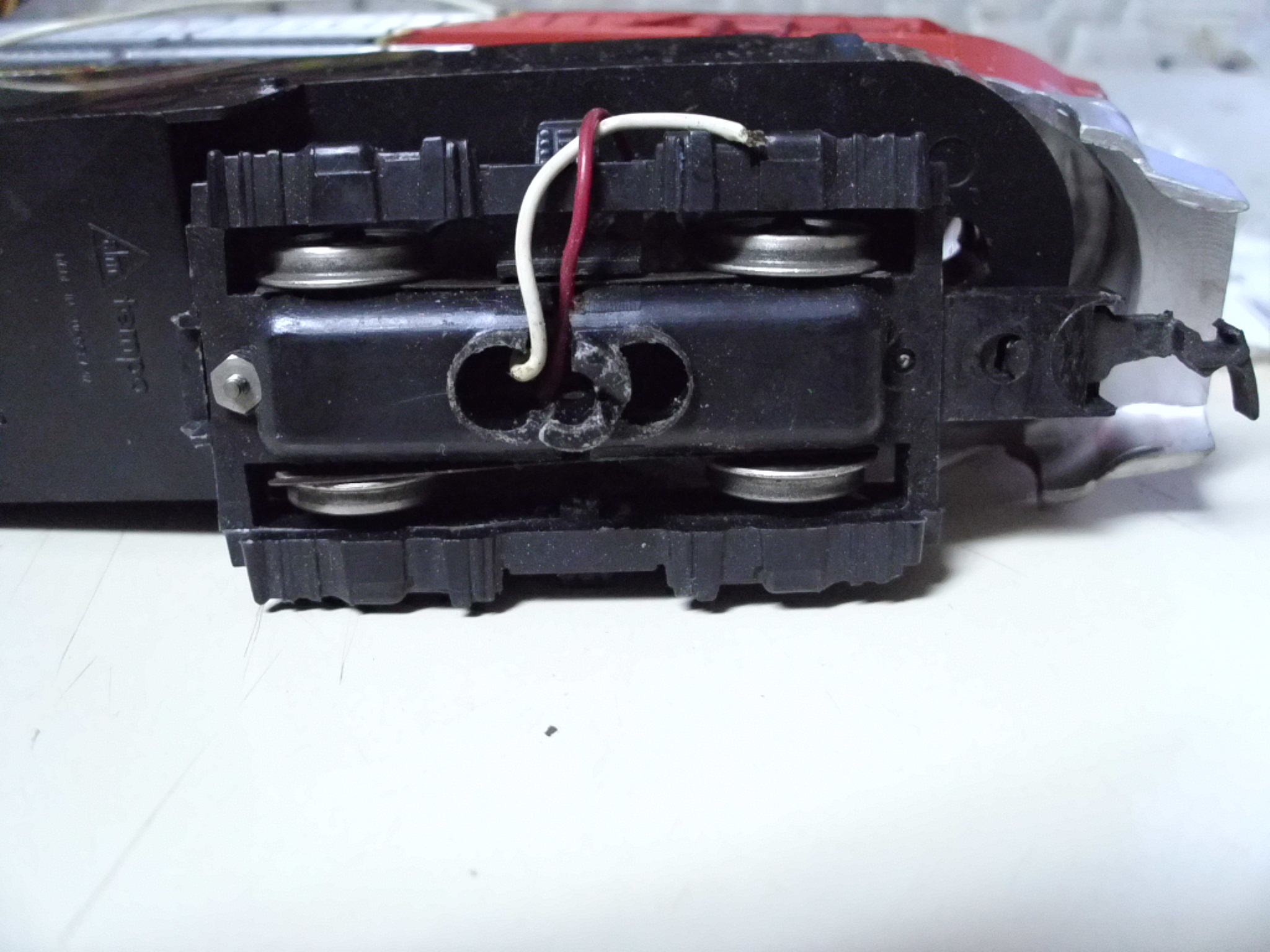

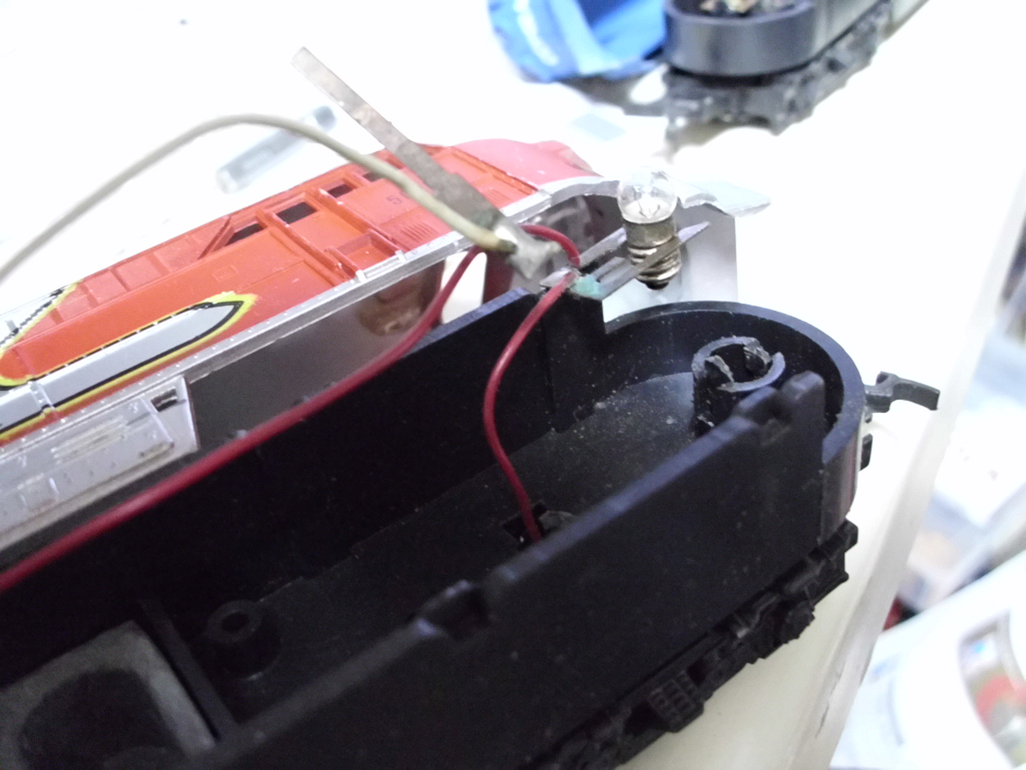

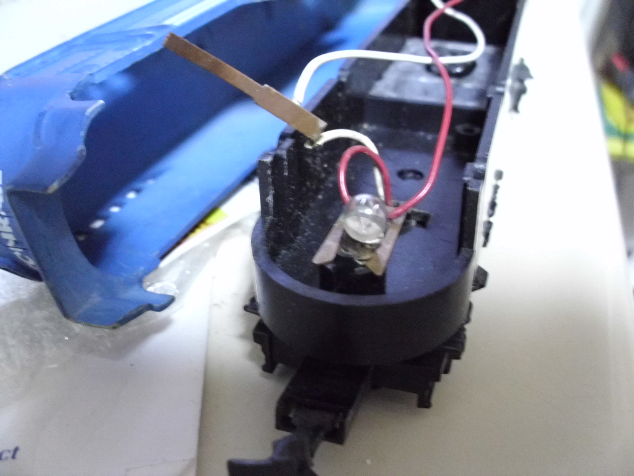

 Posted - February 02 2012 :  9:14:33 PM Link directly to this reply  Show Profile  Add microbusss to Buddylist
oh I'm sorry shoulda posted pics
I need to know where this wire thingy goes
& could use a couple of trucks
Yeah both are pathetic I know
Edited by - microbusss on February 02 2012 10:12:12 PM
 Posted - February 02 2012 :  9:53:41 PM Link directly to this reply  Show Profile  Add Redneck Justin to Buddylist
Ahm's RS-series share the same parts. Like the front truck etc etc.
 Posted - February 02 2012 :  10:23:23 PM Link directly to this reply  Show Profile  Add Redneck Justin to Buddylist
Also, those wire thingys have slot in the bulb holder's base.

 Posted - February 02 2012 :  11:27:28 PM Link directly to this reply  Show Profile  Add NickelPlate759 to Buddylist
Ben, you have the two most common problems with those: a broken crappy bulb socket, and broken crappy truck tabs. If you're up to it, you could make a cross piece out of scrap plastic to replace the tabs, and put a decent spare metal bulb socket into the plastic one.
You also need to put that wiper on one of them back behind the wheel.
 Posted - February 03 2012 :  07:53:35 AM Link directly to this reply  Show Profile  Add microbusss to Buddylist
or replace bulb with a LED instead hehe
Yup saw that Will fix that too
