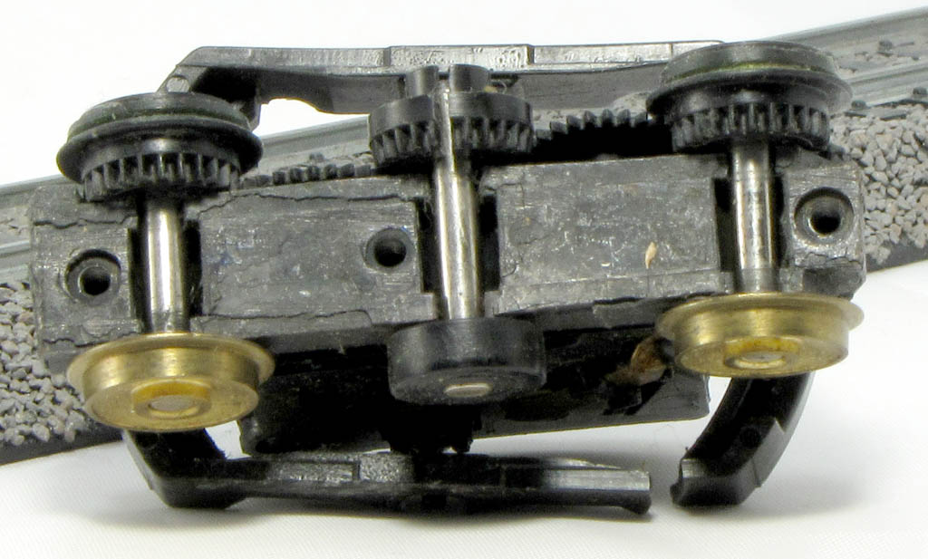

My 3 PT steamers (2-8-0, 0-8-0 X2) finally came in. The Clementine was in better shape than expected! Now, the fun..... The Powertorque was worn out the commutor had a orange glow til I cut it off! Then, while doin' PT swap (my easier ones), I found these shavings from the axle journals! Now, I've seen corroded,crack and bust blocks, never one PT like this one!Maybe I'll get a video of it!

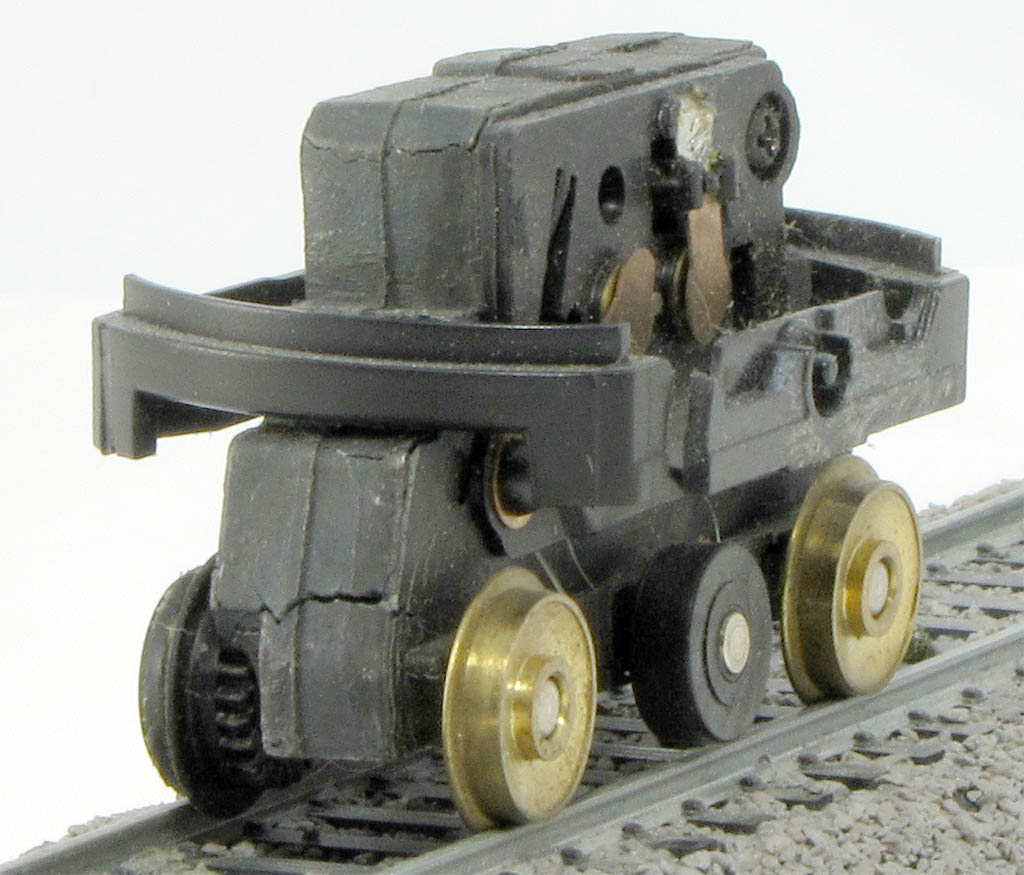

Ha ha, this could be a fun contest... who has the absolute crappiest failed PT... and who has the crappiest that runs?

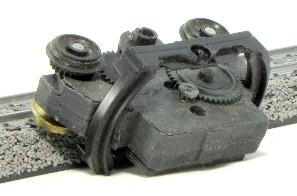

I have a PT whose block swelled and cracked in a manner that defies description... it's almost as it it "balooned out". It warped and cracked the plastic gimbal rings which couldn't be turned as a result. Came out of a Midnight Special Shark, IIRC.

Interesting, Tony. I've never seen a PT with zinc rot. It seems like later Tyco had tighter QC in that regard, but I guess everyone could end up with a bad batch of metal.
Originally posted by NickelPlate759 - January 27 2012 :  6:31:36 PM
The horror!

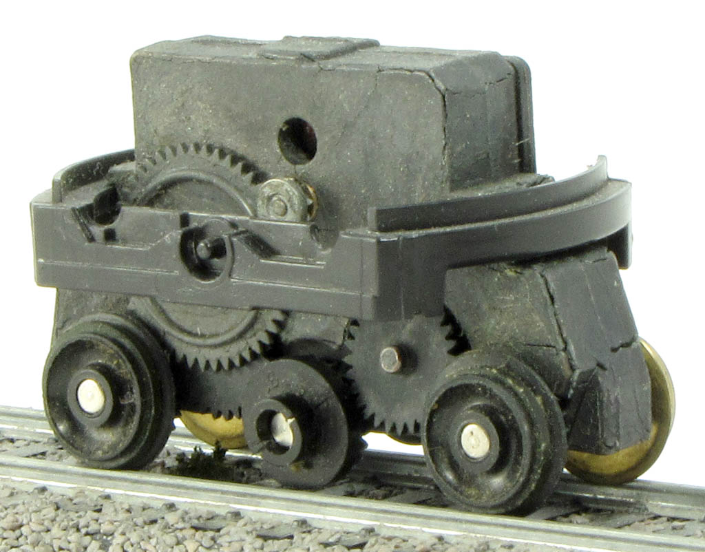

Yeah... check out all the hairline cracks, and it's like literally bursting at the edges and seams... never quite saw pest like this.
I was going to make a "trophy" out of it using this huge bolt. For kitbahsing insanity and general screwyness. George Bennett gave me the idea (and the bolt, LOL)
 Posted - January 28 2012 :  1:37:33 PM Link directly to this reply  Show Profile  Add NickelPlate759 to Buddylist
Very funny, Tony. Although isn't a trophy supposed to commemorate some sort of achievement? A PT and zinc rot are neither.
I've seen that type of cracking before in the old Rivarossi C-Liner trucks... very common. Many don't disintegrate, they just craze along the edges and swell a bit.
Anyone ever seen an MU-2 truck with zinc pest?

That's definitely a "rotter", Tony. Wow. Never seen that on any of the PT motor housings I have, either. Pretty ugly, but I like your DD trophy idea. The " You're Screwed " award.

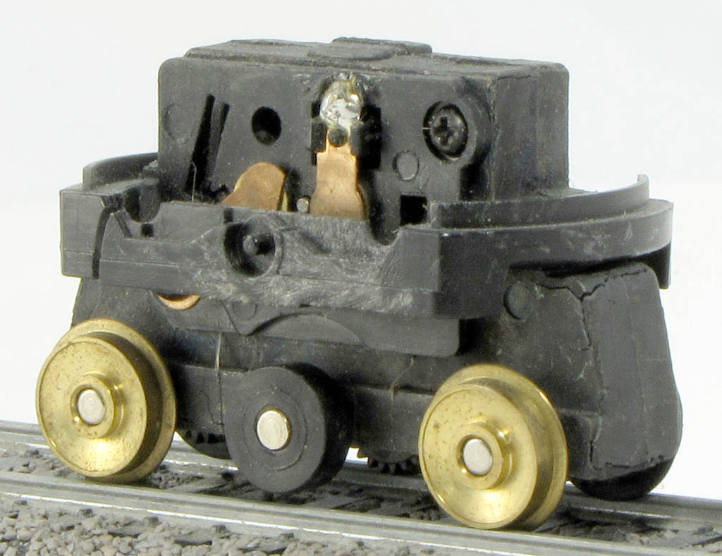

But seriously What is the cause of zinc rot? age? bad casting, exposure to weather or what?
 Posted - January 29 2012 :  6:18:31 PM Link directly to this reply  Show Profile  Send AMC_Gremlin_GT an AOL message  Send AMC_Gremlin_GT a Yahoo! Message  Add AMC_Gremlin_GT to Buddylist
ooo
Originally posted by microbusss - January 29 2012 :  12:52:18 PM
impurities in the metal itself. Over time, because of the dissimilarities in the impurities and the magnesium itself, the metal crystalizes and starts cracking. Probably due to different expansion rates when temperature changes, the metals then expand and contract at slightly different rates, causing the cracking.
