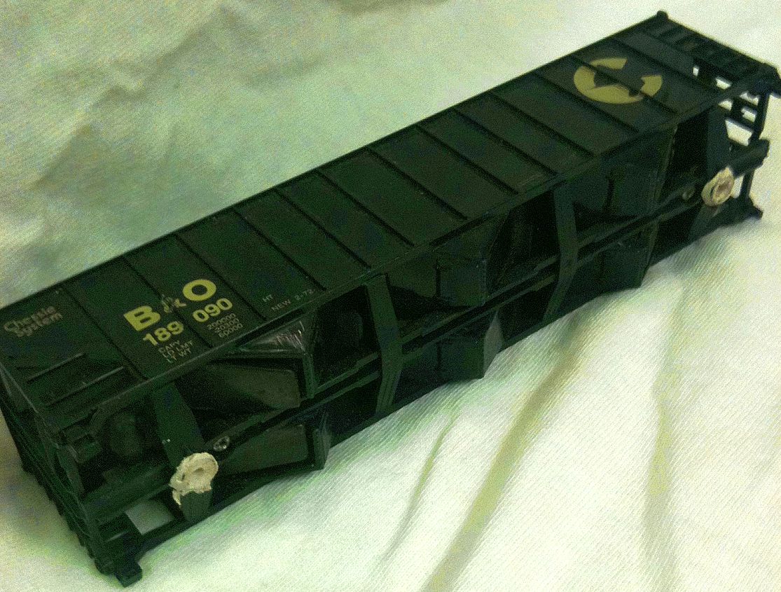

Since I model the Chessie System Railroad and we all know that it was primarily a coal hauling railroad, I have been working on a project the last few years to save money. Also, the Bowser 100T hoppers weren't out at the time I started "upgrading" the "toy-line" of Life-Like hoppers. The open 100 ton hoppers are some really nice base cars to start off with and an be found at $2-$5 each. I start off by removing the trucks, and then filling the holes with styrene cement (or whatever your preference may be). I then let it dry for 24 hours and once dry I drill and tap to use screws left over from Athearn kits or and any other kits I may have screws leftover from. I use 100 ton wheels sets supplied by Athearn. I then add washers or the necessary washer to even out the cars height. After doing this I add Kadee #5 coupler and coupler boxes. You don't want the coupler boxes the extend much beyond the frame because the won't be very prototypical. Some of you may ask why not leave the trucks alone and just add Mchenry type (whisker couplers). It tried that in the past and the results by taking this route you get a much better running and prototypical piece of rolling stock. I get LOTS of comments from folks wondering who manufactured the cars because they come out looking so good. I also add metal wheels which improve performance. By using this method it saves me around $7 dollars or so as opposed to buying the Bowser cars (which YES have more detail and its always up to the individual how much and what details to add). Here is a photo of two cars in progress. I use a very thin wash of floquil paint to weather my coal hoppers. I decided to add a touch of iron ore color to the weathering since the line I model carried quite a bit of ore in the 100T open hoppers. I will post again in a few days of some more cars as they are finished if anyone would like to see a few. This first photo is the car NIB.
This image is going through its trucks be swapped out.

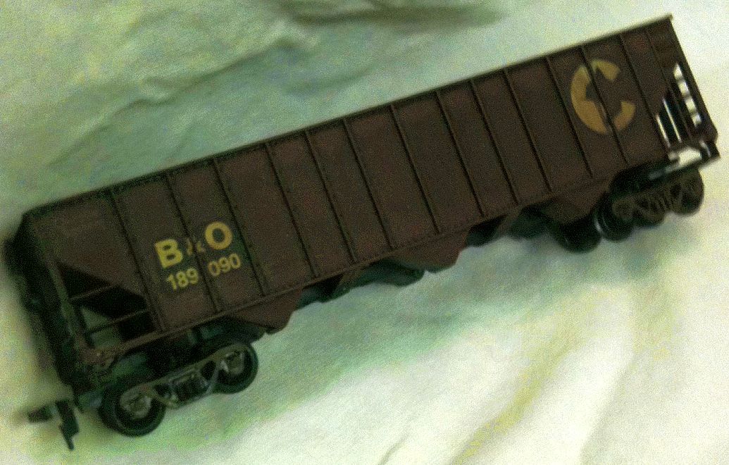

Heres one ALMOST ready to hit the rails

P.S: The bottom picture still has the LL trucks and Talgo couplers just to give you guys an idea of what the finished product looks like.

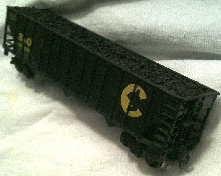

Here's one of the finished hoppers i have been reworking from the old Life-Like line. I added a coal load in this one too. Im going to finish a large fleet of these then is when the renumbering process will begin...
