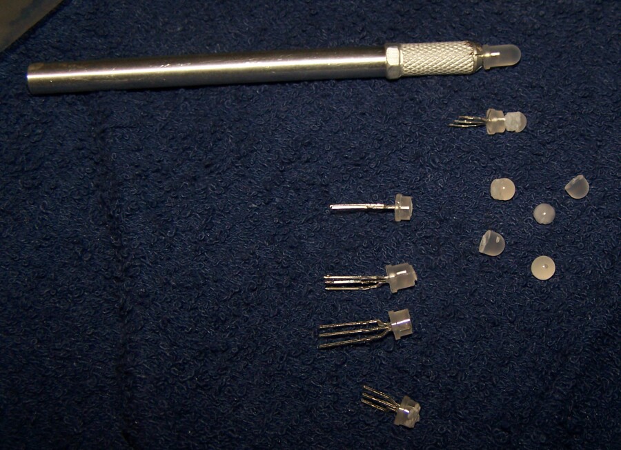

While working on Tony Clark's F7/MU-2 Mantua to rehabilitate it from non-functioning to road-worthy status, I had a brainstorm last night. I had more than a few bad bi-color LEDs at work, with a white housing. I thought, Hey, wonder if I could make a headlight out of the front LED half for these Tyco F7's? So, while at work, I rigged up an LED holder using an Xact-o blade handle, and with a Dremel and cut-off wheel, I proceeded to cut the front half of the LED off some bad ones. After a trial fit on my own F7 shell, I realized it'd have to be trimmed down some to fit the hole. So, back to the bad LED bin. Chucked in a few more, and made a cut behind the front lense part, then skimmed plastic off with the wheel back of that point. Once I'd done that, I cut it off a bit more than 1/8 inch long. Not much there! After some trial and error, I finally got one that fit, but it was bulging out too far, so I cut another one, less than 1/8 inch long. THAT one looks more realistic, sunken into the hole some. I cut a red LED up as well, figured I might as well have some fun with it. See Traindolph below.

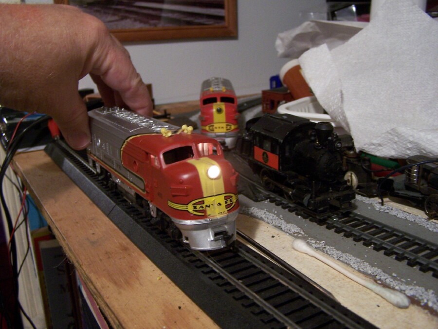

Got home tonight, and finished Tony's train repairs, and reassembled it with a new light bulb, and mounted this LED lens up front. Here's what it looks like :
The light bulb shines thru the LED plastic, and lights up nicely. Whadayathink, Tony? Do you like it? If not, it's easily removed and returned to stock, I didn't bung up the hole, I just used some Walther's Goo to set it in place, so it will be easy to return to your original state if you don't like it. I just thought a light bulb shining through an open hole didn't look good.

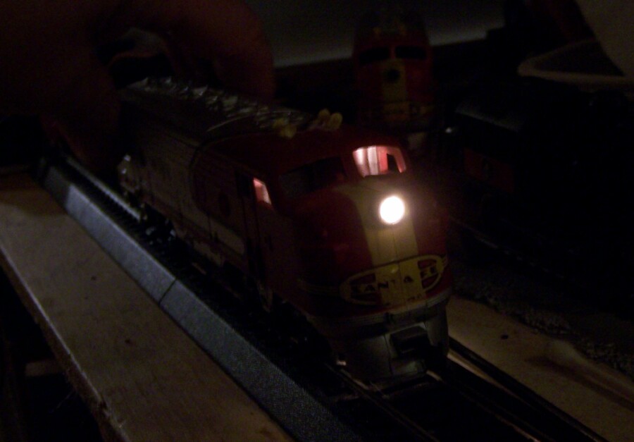

Here's a night shot of it, upstairs on the test track -
Has a nice shine to it when dark, diffuses nicely with the LED lense in front.

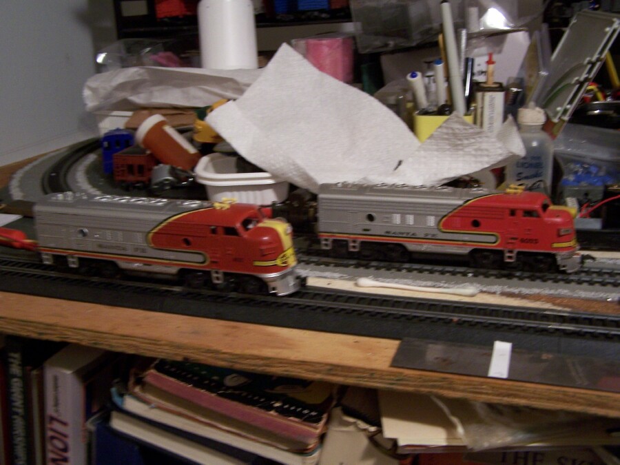

Here's a daylight shot with my Santa Fe F7, and cheesy plastic MU-2 motor drive ( doesn't work ) -

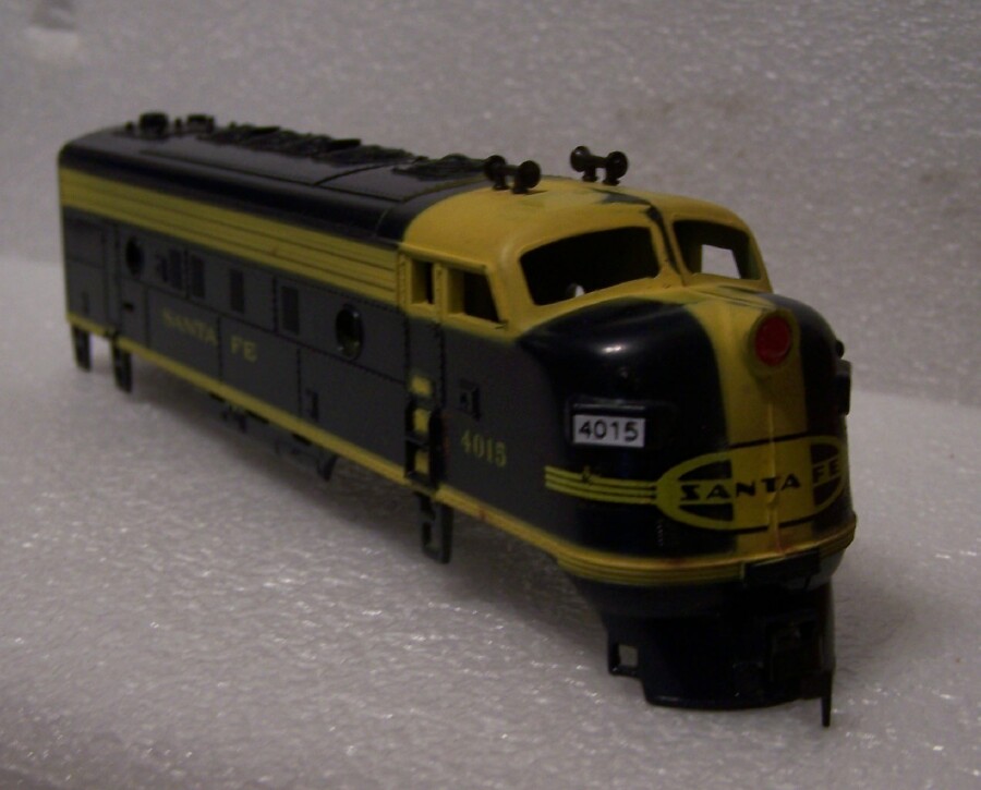

And, I'm creating a Christmas Santa Fe, this one is called Traindolph the red nosed Train, dear. I've already created a song for him, too. -

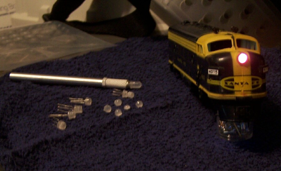

Here's some updated photos of Traindolph and the LED trimming I did to make Tony's headlight lens.
I think this will work well for filling in that gaping hole Tyco left. I have more bad white LEDs I can use for these projects, too.
I have a super-brite LED flashlight inside the engine, so the red looks more pink than anything. With a regular bulb, it should be more reddish. I think I'm going to use a red Santa Fe for Traindolph, the blue and yellow looks great, but not Christmas themed.
