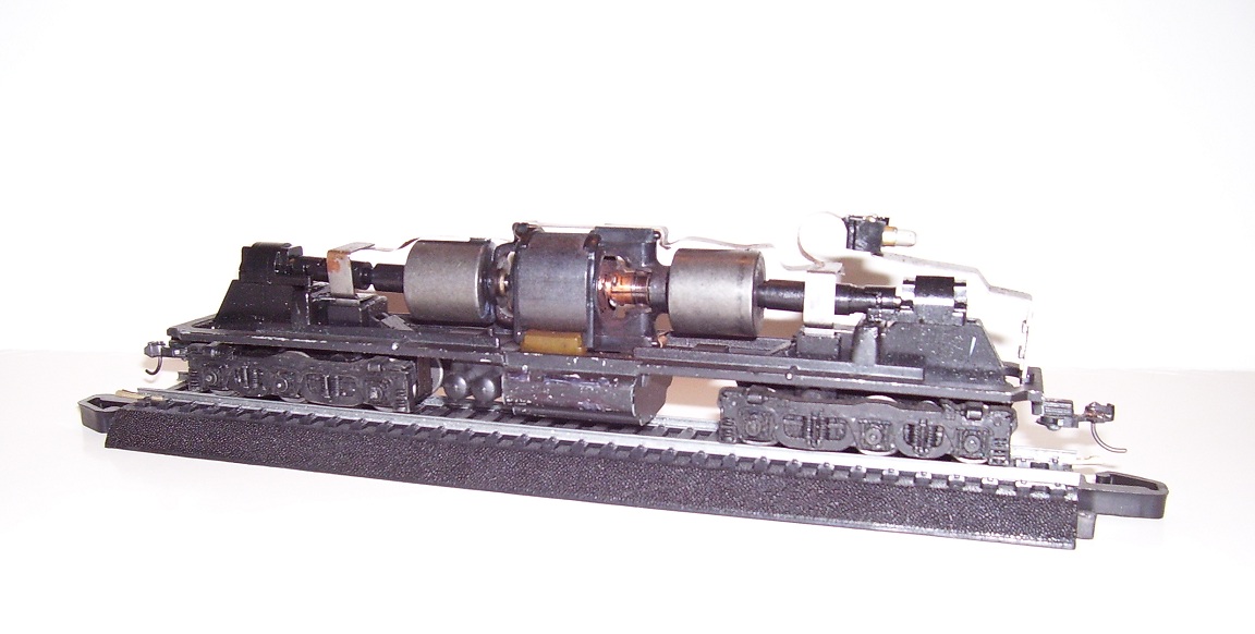

I posted the loco with the shell on in LotW but I thought the old motor and the huge flywheeles were interesting.
 Posted - December 11 2011 :  4:16:45 PM Link directly to this reply  Show Profile  Send catfordken a Yahoo! Message  Add catfordken to Buddylist

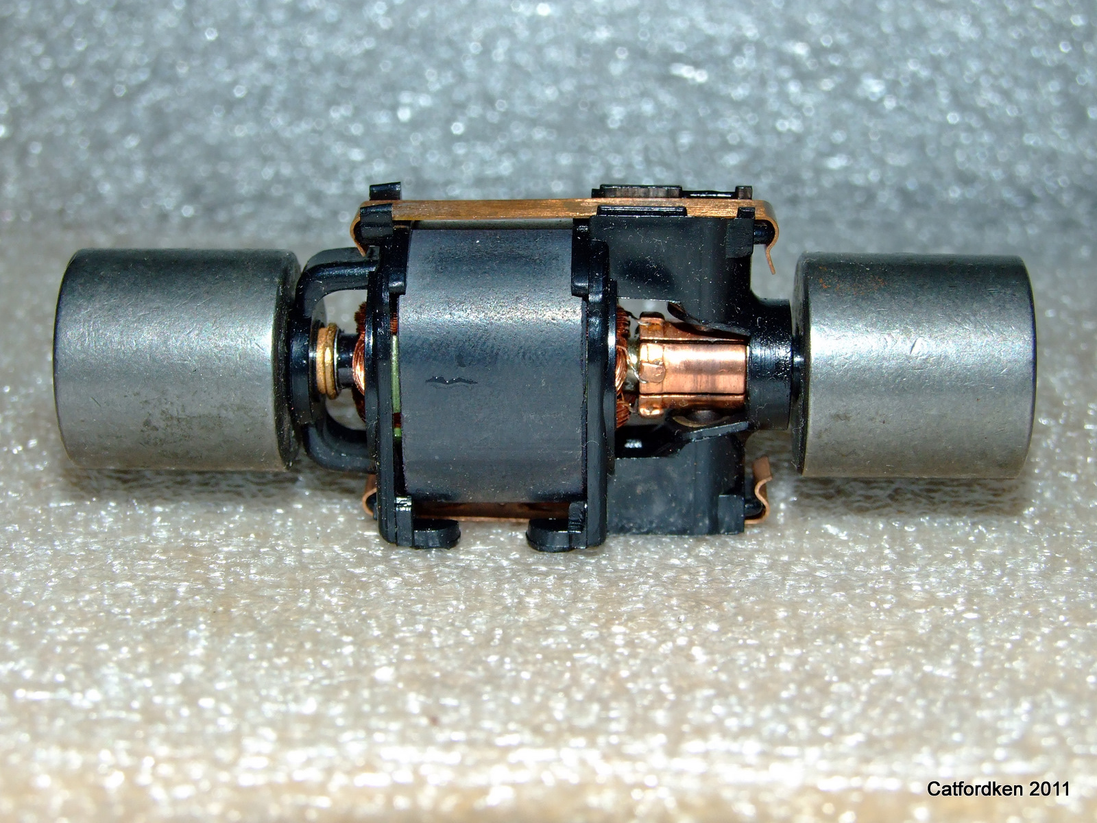

they are fair motors,but later version is much smoother in my opinion,i took this one out of a pa1 it was very stiff, ken
