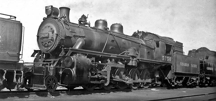

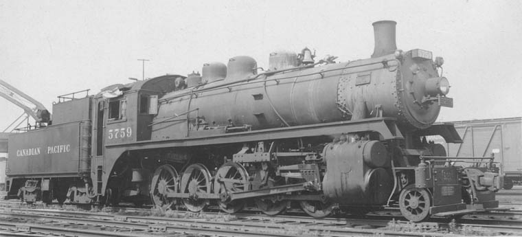

* Here we can have a place for sharing information on possible kitbashing projects. A project you thought of, but because it wasn't related to the Railroads that you model, or just dont have the time to do, You would like to pass on to another person that can complete the task of building the model. Like maybe you seen a photo of a locomotive with similarities to a locomotive that has been produced and it readily available. I have seen such a engine. It is a decapod, 2-10-0. The locomotive hasn't be mass produced for the train market. It may have been made in Brass. The reason I won't be making the model is it is of a Canadian prototype . I notice the photo, and made some mental remarks on what it would take to do it . It would be a good project for one who modeled the Canadian Pacific. Also not a very complicated one. A replacement of a cab. Changing the steam and sand domes type and location. And some work on the pilot. The tender will need some structural changes also.
* Here is the photo I found in a very old railroad publication.
* As you can see it is very similar to the Russian Decapod the Bachmann makes. Having the working drive without any modifications is very time saving. The cab can be cut off of a Junker Triang - Hornby Pacific, or a Kemtron manufactured on e found at a train show or on E-Bay. Kemtron had made them in Brass or plastic. A front pilot can be acquired from Bowser. The domes from Tyco 2-8-0s. You will have to change the tender side walls, by cutting them to their new shape and making a new tender deck and coal bunker. More structural work needs to be done to the tender than the loco. If you take your time and think out all your moves before you do them, and be careful, it should work out alright.

Hey Frank:
No surprise you like another Dec!
That's an R2 Class one from the CPR and they were available from Van Hobbies (PFM)/Samhongsa
http://members.shaw.ca/cprsteam/r2a.htm
Last unpainted one I saw was about $5-600 although the prices are coming down on a lot of that generation of brass.

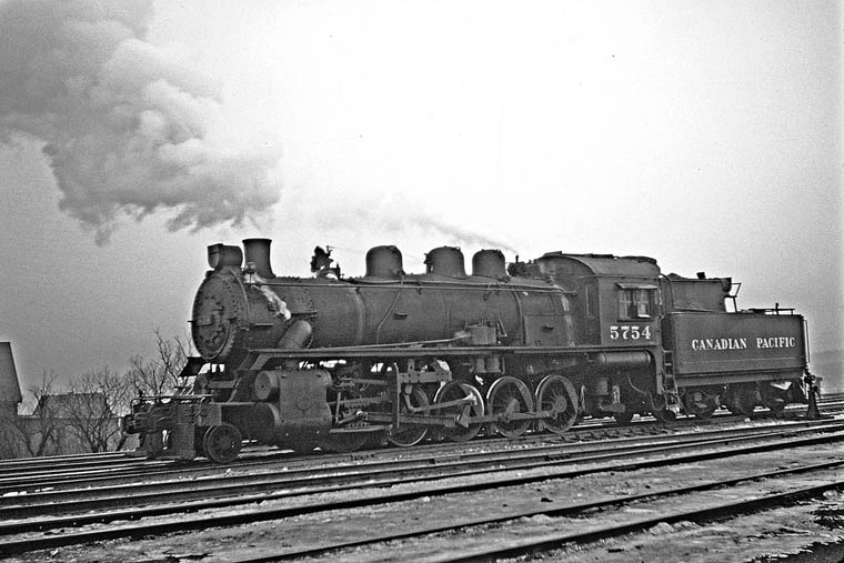

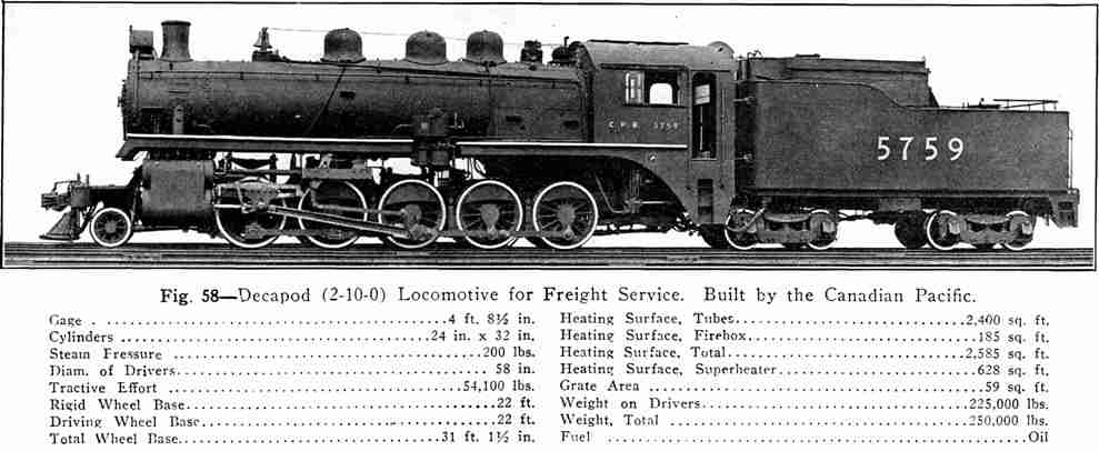

 Posted - December 10 2011 :  07:00:33 AM Link directly to this reply  Show Profile  Send catfordken a Yahoo! Message  Add catfordken to Buddylist
not to forget that the r2a was made from a r1 0-6-6-0 which although not a failure,its running costs out weighed its advantages ken
r2a has 2 domes
r2b has 3 domes
r3b 5759 (from the ashes of the r2bs the r3bs were built as oil fired decapods from scratch)
i think its great when you can see a loco progress,from a good design to a practical one which gave good service
bit like the challenger to the big boy
Edited by - catfordken on December 10 2011 07:29:51 AM
 Posted - December 10 2011 :  12:06:06 PM Link directly to this reply  Show Profile  Add toptrain to Buddylist

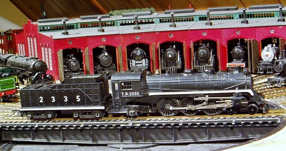

* HI Ken and Gareth. Now with these photos all that work on the tender can be saved by a clear vision tender. It seems the photo I put in was some kind of a first idea by the CP. Clear vision tenders can come from AHM - Rivarossi, And Triang . This makes this a very easy kitbash with good results. Actually get the work down to the sand dome and cab. That unique fireman's side cylinder exhaust pipe going up and tilting back can be done. Enlarge the smoke box won't happen unless a overpowering prototype urge overcomes the modeler.

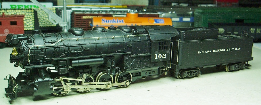

Here are 3 engines you can get for donner parts. The triang pacific's tender is a match for the photo I put in.
Triang Pacific 4-6-2
AHM Rivarossi Indiana Harbor Belt 0-8-0.
Made be Rivarossi for AHM and Lionel, Export style 0-8-0 or 2-8-0.

 Posted - December 10 2011 :  1:34:19 PM Link directly to this reply  Show Profile  Add romcat to Buddylist
Hey Frank:

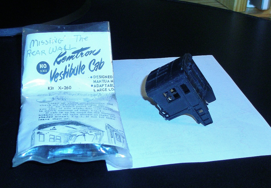

Got the Kemtron Cab in my shells and boilers box.
Details by Eric sells the cab in Resin for lees than 1/2 the Kemtron one....
A little triiming on the Tender "Gunwales" will work.
and you figure that the smokebox needs to be larger than the existing Bachmann Dec?

 Posted - December 10 2011 :  6:36:34 PM Link directly to this reply  Show Profile  Add Mustangs_n_Trains to Buddylist
Frank!
Do you need a back to that cab? I have some spare brass backs (only).
Let me know.
I just had another engine arrive today with the brass all-weather cab too.

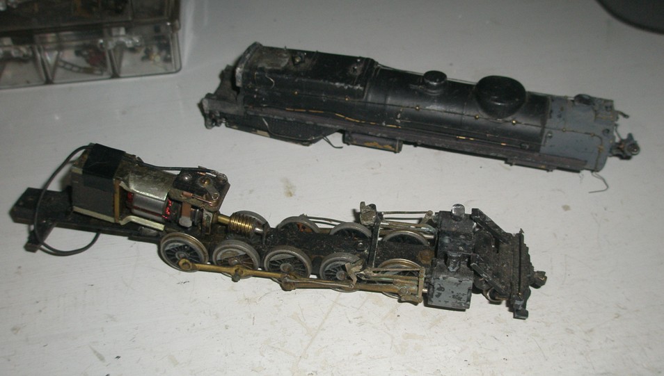

* Here s a kitbashing project to put on my List. A Cary, Penn-Line PRR N1 2-10-2.
This is all I have right now. Got to start looking for a trailing truck and cab to start with.
 Posted - April 22 2012 :  2:11:35 PM Link directly to this reply  Show Profile  Add NickelPlate759 to Buddylist
Originally posted by toptrain - December 10 2011 :  12:39:34 PM
Hmm... this one looks familiar.
 Posted - April 24 2012 :  06:46:22 AM Link directly to this reply  Show Profile  Click to see EM-1's MSN Messenger address  Send EM-1 a Yahoo! Message  Add EM-1 to Buddylist
Originally posted by toptrain - April 22 2012 :  12:49:21 PM
Somewhere I have a trailing truck for that N-1.......I took one and is making it a 2-10-0, in Western Maryland, to be an I-2! So, if interested in the trailing truck, let me know as I have a bunch of them, (this is offered so that you can pick which ever one you like)
If interested of course PM me!
EDIT:
Forgot to mention, I'd LOVE to mold that sand dome pictured on this boiler!

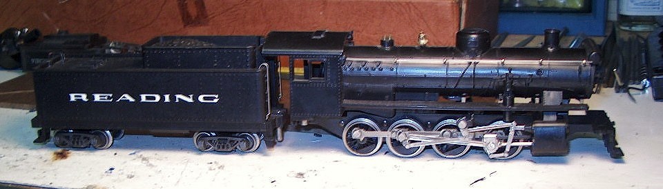

Kitbash !
* Bachmann Reading I 10, rear cab consolidation, backdated to a I 6, camelback.
* I need a complete elevation drawing for the I6. Without the drawing a new cab will be very hard to make.
* I6 info : What I know about it.
* I6 built by Baldwin. Numbered 1101-1125. Dates built 1905-1907.
* As built info. Single sand dome between stack and cab. Cylinders type - Rogers. Pilot, freight stepped. Lead truck spoked. 3 window cab. Outside valve gear added around 1935, inside mechanical lever operated before. All photos I have show air tanks on top of firebox. Length unknown.
* 1905 version : had oil head lights ( no electric ), No westinghouse breaks, so no air tanks on top of firebox. Steped pilot. Compressor, one single stage type. Cylinders with squared off box atop containing reversing valves. Piston crosshead double guide type.
* 1940 version : Air breaks with tanks atop firebox. Electric lighting. Some have 2 compressors of single stage type. On this class cylinders changed only when old one failed.
* Mine will be the up dated 1940 version.
