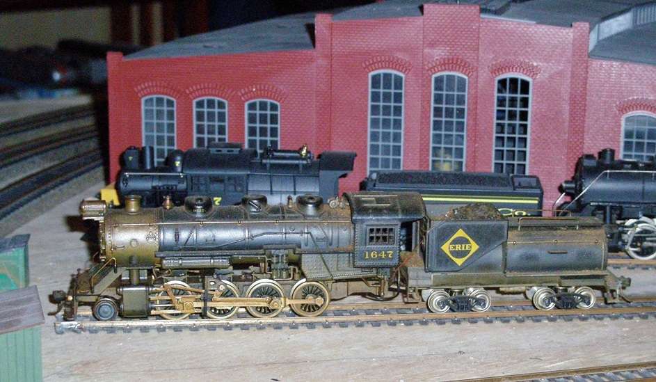

 Posted - December 05 2011 :  2:49:50 PM Link directly to this reply  Show Profile  Add toptrain to Buddylist
I right now am powering a Tyco chatanuga cho cho. I got it acouple of days ago with some other trains. It is a standard tyco 2-8-0. for a tender it had a MDC Vanderbuilt. It was used as a tail end Charlie pretending to be a pusher. It worked well as one. I have cleaned up the engine. Got rid of the Nickoteen. And am powering the frame in a standard way. Sound like somthin else for "Watz Go'in on".
Edited by - toptrain on December 05 2011 3:02:00 PM

Toptrain, that 2-8-0 sure looks nice with a vandy tender!
