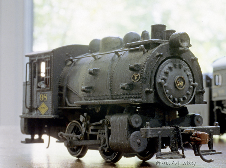

Hey guys;
this pic was in an email from Sean where we were discussing how I might impprove the deal on a Central Valley Lil Joe he currently has on evilbay.
Anyway, he had found this (Mantua 0-4-0 chassis) and suggested it as an alternative to the Varney running gear. I like the Mantua valve gear pictured so I was wondering if anyone could conclusively ID it? Btw, Sean thought Booster, me I haven't a clue....
Thanks,
Gareth
"A is A"
-Aristotle
Law of Identification
Edited by - romcat on December 01 2011 12:21:33 PM

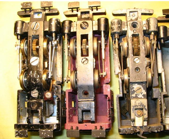

 Posted - December 01 2011 :  12:22:20 PM Link directly to this reply  Show Profile  Add toptrain to Buddylist
* Sean would agree, the fact is that wether it was a booster or switcher by Tyco-Mantua that provided power for this old varney body is not inportant. It shows it can be done. I would say easily.
Edited by - toptrain on December 01 2011 12:23:34 PM
 Posted - December 01 2011 :  12:22:58 PM Link directly to this reply  Show Profile  Send catfordken a Yahoo! Message  Add catfordken to Buddylist
my guess kit 754 which seem to fit all the 0-4-0s ken
http://www.hoseeker.net/assemblyexplosionMantua/mantua040shifterpg1.jpg
Edited by - catfordken on December 01 2011 12:26:43 PM
 Posted - December 01 2011 :  12:27:58 PM Link directly to this reply  Show Profile  Add romcat to Buddylist
Frank:
It matters in that I was interested in the form of the valve gear as it appears in the picture I provided. If there is no difference great, if their is I'm still looking for an answer.
Ken:
I saw that to earlier and I'm leaning that way towards the Shifter myself.
"A is A"
-Aristotle
 Posted - December 01 2011 :  12:47:38 PM Link directly to this reply  Show Profile  Add Mustangs_n_Trains to Buddylist
Gareth,
There is no difference between the Shifter & the Booster parts. As the proud owner of some ~30 Shifters and ~25 Boosters, I can assure you of this...all the external parts other than the frame and boiler/tender shells are interchangeable. This includes, drivers, bearings, rods, gears, etc.
The frame altering is the the difficult task. The Switcher had a large bulk of material toward the rear that would need to be widdled down to somewhat match the shape of the shape of the original Joe chassis. The Booster already has a shape close to this which would require only the removal of the rear deck & steps. Quite an easy cut with a dremel cutting wheel.

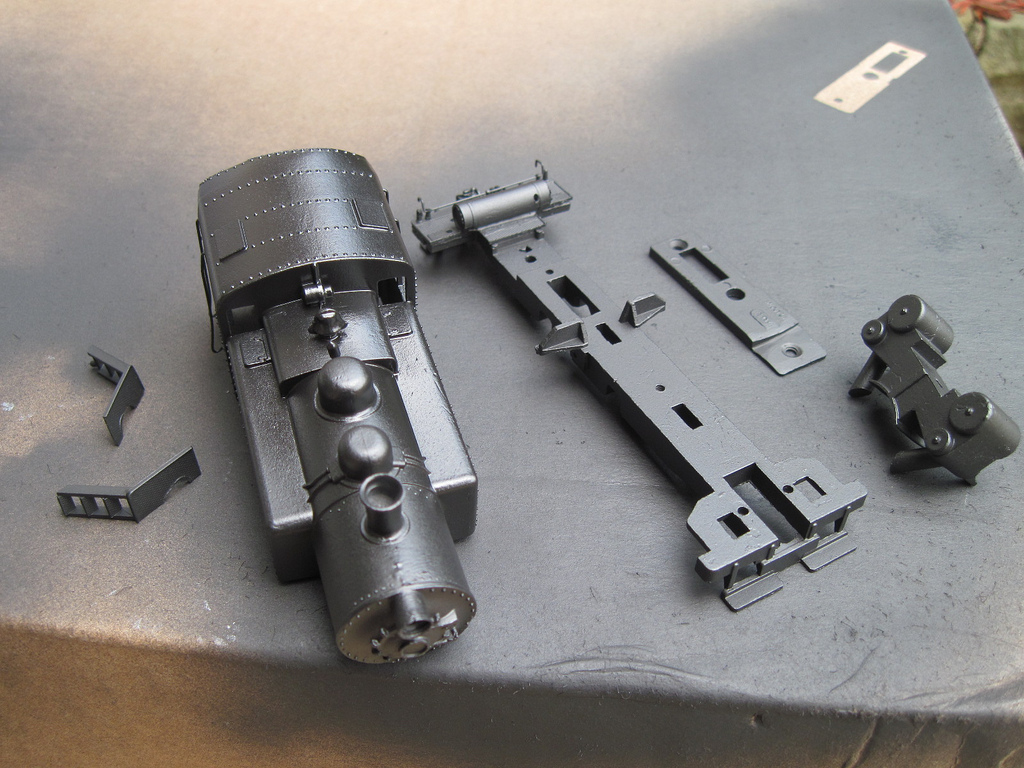

This is the booster frame:
It would be much easier and require less time to cut this frame down that that of the Switcher... This is what I tried to explain earlier (in fewer words and graphics of course).
