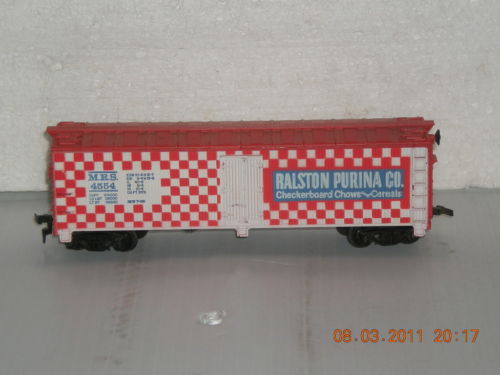

I have not taken a Tyco train apart in over 30 years. When I received my Red roofed Purina box car today, the weight is loose inside it. I wanted to ask rather than break something on the box car.
I notice that the box is attached to the chassis sitting on 4 pins located on the bottom corners. Are these pins glued, or are they just made to hold snuggly. The question is how to remove the box body from the chassis without damage...

Thanks guys! Mine has what looks to be plastic what I'm calling 'pins" for lack of the correct term, that the chassis presses onto to hold the unit together.
Ben, they don't look to be glued but I thought it would be worth asking before I attempted removal. My guess would be that the box car will separate by careful prying a little on each end... This car is very nice so I don't want to damage it in any way...

Hi Walt,
I've taken a few of those a part. I used a small jewlers screw driver and gently pried up from the shor end of the box car. Taking your time will help prevent breaking anything.
Hope this helps...................Tom

TOM Thank You! That is exactly what I had in mind but wanted to ask someone who knew more than I do about it...

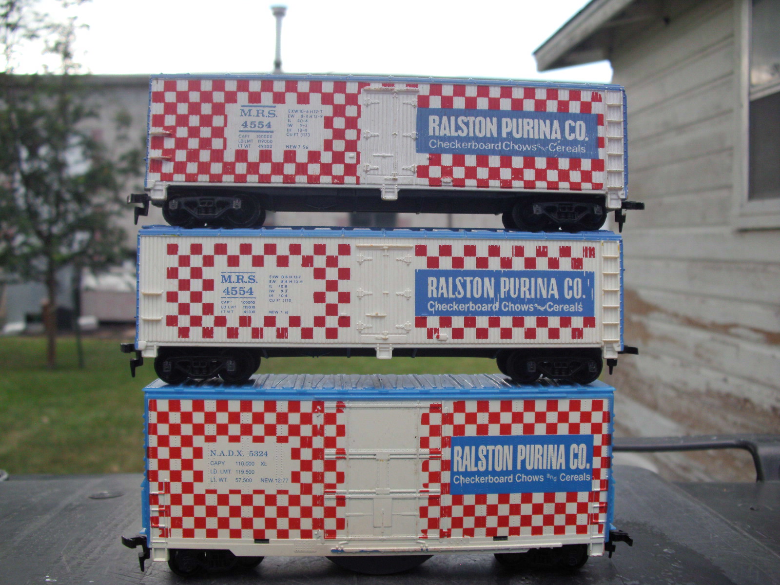

There are 3 versions of the reefer / floor mounting:
1) Kit version with metal floor. The floor/chassis is the same part used on the 40' flat, gondola and boxcar. Kits used 4 small screws to secure the floor to the posts in the corners of the shells (some cars used holes in the center sill but the floors still interchange). Easy to take apart.
2) RTR version of the above. Same deal, but uses the pins AMC referred to above. I have removed the floors using Tom's method as well, but will caution that you should insert the screwdriver at the corners and do one at a time - not from the center of the end. You may still inevitably leave impressions on the plastic if the fit is tight, but with care and a wide blade they will be inconspicuous.
3) Plastic version, appearing 1971/72. The cars extended corner posts that press-fit into the new plastic chassis. Troublesome to remove, but the method above still works. If you break a pin (some are amazingly stubborn) you can usually just cement it back in place.
When I get common / junk cars with busted stirrups or lousy paint that feature the metal frames, I harvest the metal chassis and discard (recycle) the plastic shells. The metal frames are rather handy at times, even for weighing other kits.
You can also convert the all-plastic cars to the metal frames. Simply slice off the narrow post extensions, then insert a metal chassis and use its mounting holes as a jig to drill holes in the posts. Then use the original screws or pins to secure them. I've converted a handful of cars this way. Makes a big improvement in appearance too, since the plastic floors hang too low below the sills on the boxcars.
