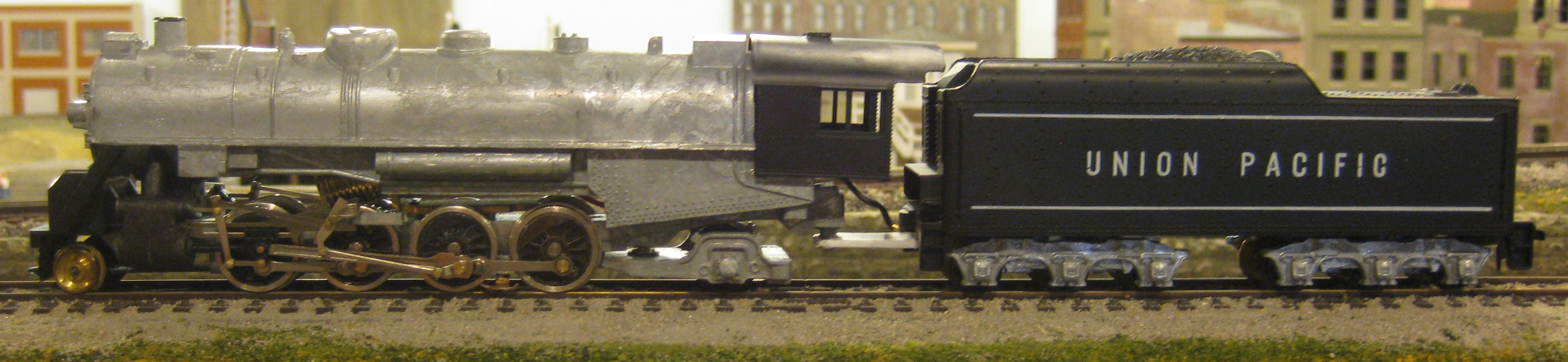

Here is a picture of my Mike:
 Posted - September 07 2011 :  11:24:44 PM Link directly to this reply  Show Profile  Add romcat to Buddylist
Ya need to change that cab, it's from one of their switchers and it's too small!

 Posted - September 08 2011 :  08:51:22 AM Link directly to this reply  Show Profile  Add toptrain to Buddylist
All tyco cabs are the same size. The only difference is the wall against the boiler. The size of the opening for the boiler is different. The 2-8-2, 4-6-2, 0-4-0 and 0-6-0 shifters, and 2-6-2 share the same size boiler. Old timers are different.

 Posted - September 08 2011 :  09:08:57 AM Link directly to this reply  Show Profile  Add romcat to Buddylist
Hey Frank:
You kindaa qualified what I was saying. The thing is they should NOT be the same size. On the real thing, cabs on road going engies tended to be larger. Tyco/Mantua used their 1920's style switcher cab across the product line for reasons of economics, not fidelity with prototypical practice.
Now having said that. If you want to stay true to the Loco as a TYCO, leave it. If OTOH you want it conform more to proto practice then think about a cab switch, after all thats what modelling is. Modelling is supposed to be a verb, an activity.

 Posted - September 08 2011 :  09:33:59 AM Link directly to this reply  Show Profile  Add Redneck Justin to Buddylist
Nope, cab and all is correct to the kit.
 Posted - September 08 2011 :  1:32:02 PM Link directly to this reply  Show Profile  Add romcat to Buddylist
Justin;
Perhaps you misunderstand me, per the prototype, the cab that Tyco/Mantua put on that SCALE model is inappropriately small.

Srenchin
CNRedAvatar
 Posted - September 08 2011 :  1:45:24 PM Link directly to this reply  Show Profile  Add Srenchin to Buddylist
I agree, the cab is too small. Actually my plan is to turn this generic locomotive into a model of a 4000 series Santa Fe Mikado. I already have a Santa Fe style MDC cab that I am going to try to fit to this model. However, before I do anything cosmetic to this engine I first need to get this thing to operate properly which brings me back to the original topic of this post. Currently the engine lurches around my test track due to a defective driving axle spur gear. I need a new wheel set for this engine but I would like to replace the drivers with something other than a Mantua replacement parts. Does anyone have any suggestions?

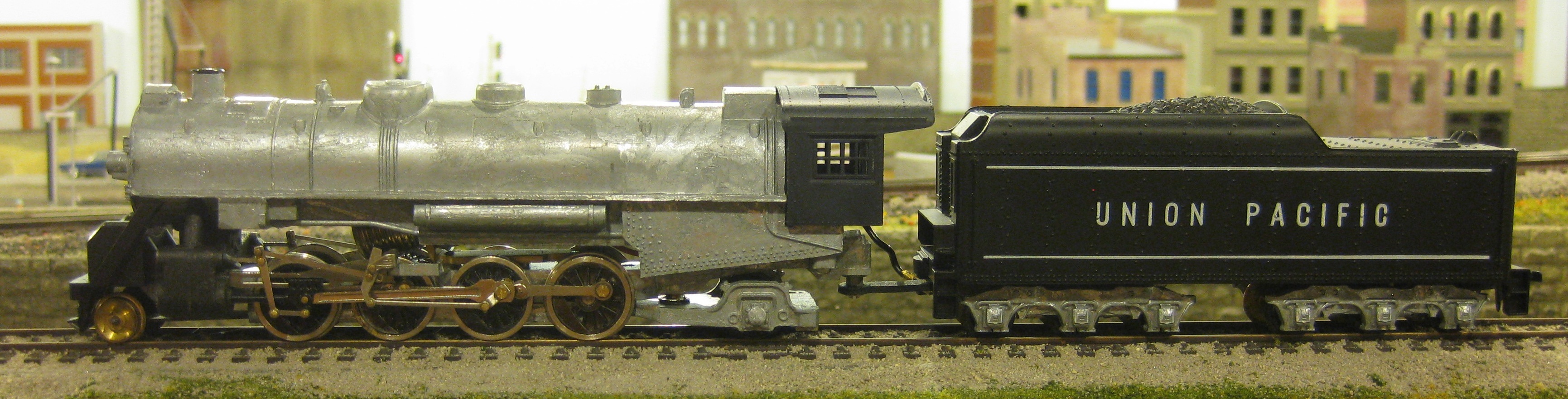

Srenchin
CNRedAvatar
 Posted - September 08 2011 :  7:07:31 PM Link directly to this reply  Show Profile  Add Srenchin to Buddylist
I think the gear "tread" may have a slight taper to it, just like how railroad wheels have a slight taper. Since my last post I have spoken to Dan at Yardbird Classic Trains about this locomotive and he had some great advice. First he recommended that I put a piece of card stock between the motor and the frame to remove any binding between the worm gear and axle spur gear. This I did with positive results, the locomotive is now able to run smoothly, even at low speeds! Unfortunately the engine suffers from excessive gear noise (which I failed to mention in my earlier posts) that is really annoying. Listening over the telephone Dan said that the engine was way noisier than it should be, which still suggests to me that the axle spur gear is defective. Incidentally the spur gear is made out of white nylon rather than the more modern black plastic material used for gears today. Dan's second suggestion was to try to break-in the locomotive by letting it run for a couple hours, but after running this engine for the better part of the day it is still very loud. I think the next step is to replace the wheel set. Oh, I decided to substitute a larger cab for the stock Mantua cab supplied with the kit. Let me know what you think!

 Posted - September 08 2011 :  7:29:39 PM Link directly to this reply  Show Profile  Add romcat to Buddylist
Looks like theirs room in the cab now for operation.
The cab needs to be levelled though.

 Posted - September 08 2011 :  9:32:54 PM Link directly to this reply  Show Profile  Add Srenchin to Buddylist
If I decided to replace the gear on my own, how would I remove the wheels and then replace them properly quartered? Is this something that can be done by hand or would I have to invest in some kind of wheel puller device? Incidentally, Dan at Yardbird offered a trade where I would send him my defective wheel-set for a new one. Presumably Dan would then replace the bad gear and then sell my old wheel-set to a new customer.
As for the cab, I loosely attached it to the boiler shell to see how it would look. I can't get it level without gluing it in place which I am not ready to do yet. Incidentally I had to make a longer drawbar to provide clearance between the cab's roof and the tender. My next question is how to fill the noticeable gap between the locomotive's frame and the tender, right now the cab looks like it is suspended in mid air without any means of support. Has anyone dealt with this problem, I know that a company called Mellor offered a "back detailer kit" for the Mantua Mike. Does anyone know where I can find Mellor products?
