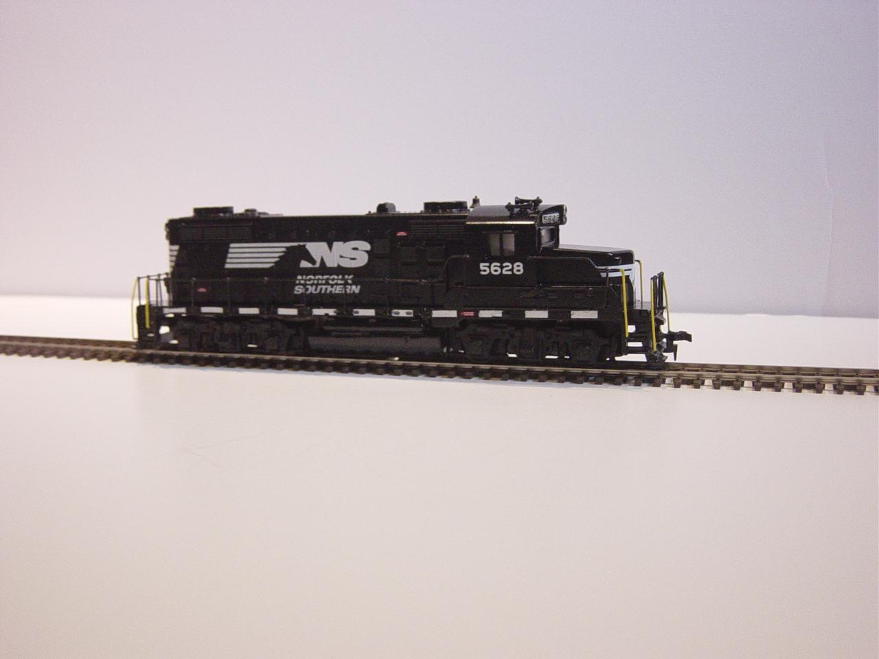

Mantua GP-20 Norfolk Southern, after raiding the Spares Box
This GP-20 started life as a Union Pacific that was in very bad shape, and in the bottom of a junk box purchased at ebay. It was so beat up, that I felt sorry for the thing, and started this project with the idea of trying to make what I could just using spare parts and leftovers, and not buying anything.
After stripping the shell, the fan housings and the weight mounting posts were repaired, and the body painted with Tamiya Pure White. The stripe was masked, then the shell painted with Tamiya Black. Decals are from some leftover Microscale, sheet 87-1225, then a coat of Tamiya Clear Semi-Gloss. Side frames from the spares box were painted flat black. I had a set of new handrails (couldn't remember what I was going to use them for, anyway) that were added and painted black after mounting. Trucks, wheels, etc., were cleaned and lubed, and I put them in using new wiring. The original motor was pretty burned-up, so its replacement is a lightly used one from the spares. The only thing that I couldn’t dig-up were the tanks; I took one from another GP-20 to use as a pattern, and using some leftover Alumi-lite, made a two-piece mold and casted a few.
It was a fun project, but at times, I thought that maybe it would have been easier just to leave it in the junk box. The challenge, though, was to make the best out of what I had on-hand, and with that, I was pretty happy. Just need to remember, next time, to take a "before" shot.

I really do wish that I had taken a "before" shot. Ever see the Nissan commercial with the kid that stomps on his toy cars and puts them in the toilet? I think he was the previous owner!
