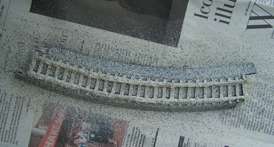

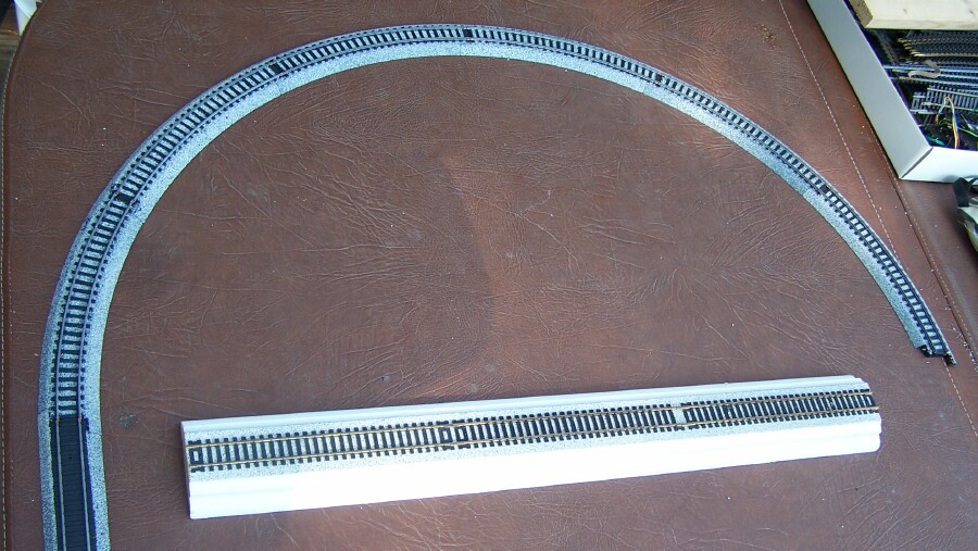

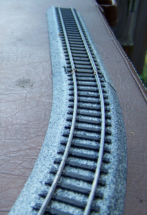

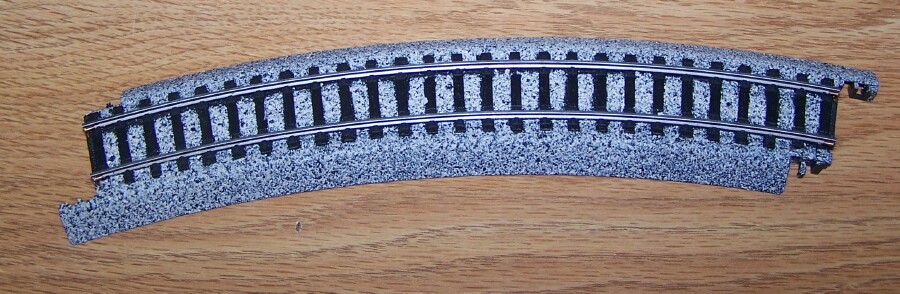

While finishing up my wood molding/roadbed projects today, I got into painting the plastic EZ snap-track when a friend mentioned that it might look good with the spatter-paint I used on the wood moldings. Hmm. So I tried it the simple way, and then the more time-consuming way. But it came out looking good, if I can make a paint cover jig to just lay over the straight and curved tracks, it will go MUCH faster. Here's what they look like -
Took me about 15 seconds to tape the straight piece,about 20 minutes to do the curved. But the results are excellent. What's the opinion from the peanut gallery?
 Posted - August 17 2011 :  10:27:43 PM Link directly to this reply  Show Profile  Add Brianstyco to Buddylist
Looks GREAT Jerry - I have that paint too - Stone fleck - Works great on structures too for art deco style look

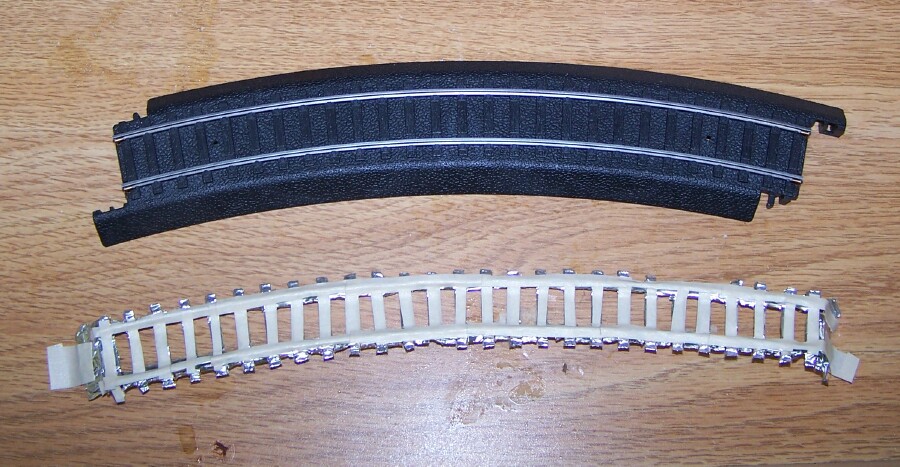

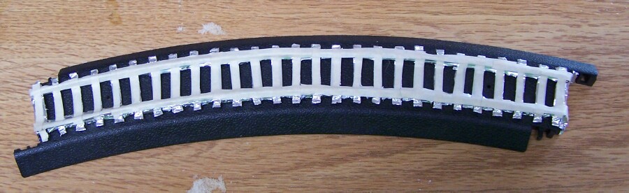

Success ! I created a simple paint jig out of aluminum foil, then used masking tape over THAT to give it some strength. I painted the first curved track already, and then after 10 minutes, I pulled the paint mask jig off carefully, re-applied it to another curved piece, and have shot that with the paint. I'm almost out of the paint, I think I can do 2 more sections before it may give out. We'll see. I think as long as I'm careful with it, it'll hold up to being reused a few times. Took me about 30 minutes to make it, but the time savings will be incredible for painting multiple sections of track. I'll try to do enough for a nice sized oval. Next i'll have to make a jig for straight sections. But I'm liking the way it came out already!
Here's the jig and the first section painted.
This is one project I'm REALLY having fun with!

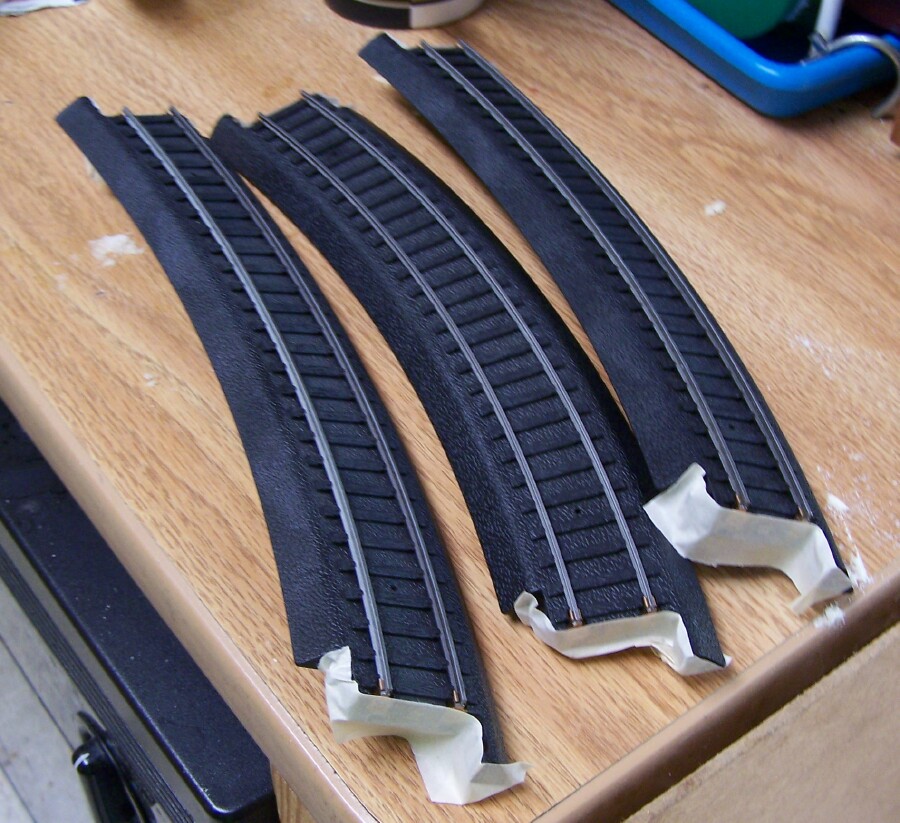

11:15 AM update - I have painted 4 curved sections so far, and about out of paint. Will buy another can at Wal-mart while out today. The jig is not rigid enough, it's bending a bit with the paint on it, but so far, I've got 4 done , and the first 3 look pretty good. I'm not looking for perfect, just acceptable. So far, they pass muster. I might get enough curves to do a full circle out of this one jig. Yay!

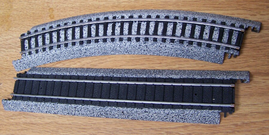

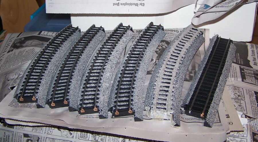

Update 7:50 PM - had my wife rescue the last piece before the storm hit and blew it down on the deck. Got home and pulled the other 3 I'd done that were up high and dry on a 10 gallon aquarium and brought those in, too. So here's the 6 I've done so far, the far left with a custom masking tape fit, the other 4 curves with that one foil jig on the right one still,and the simple straight piece with two pieces of tape.
Off to Wal-mart with the wife in a minute, going to get another can, this one was running empty, and the last one has more black still showing, but still acceptable to me . Close enough! If it's not raining tomorrow, I will try to finish a circle's worth. Then start on the straight pieces. Lookin' good!

 Posted - August 19 2011 :  11:03:58 PM Link directly to this reply  Show Profile  Add NickelPlate759 to Buddylist
Nice job on the foil mask. I wonder if there's any thick glue you could layer on, like Gorilla Glue or epoxy that would make it more durable.
 Posted - August 20 2011 :  10:07:07 AM Link directly to this reply  Show Profile  Send AMC_Gremlin_GT an AOL message  Send AMC_Gremlin_GT a Yahoo! Message  Add AMC_Gremlin_GT to Buddylist
Originally posted by NickelPlate759 - August 19 2011 :  11:03:58 PM
I hadn't thought of epoxy, but that might make a nice rigid coating that would help it hold up longer. The foil ears on the outside of the rails are the worst to try to keep in shape. But so far, they're holding up. I don't know if they'll last 7 more curves, but I will keep using it until it's no longer viable.

 Posted - August 20 2011 :  4:41:03 PM Link directly to this reply  Show Profile  Send AMC_Gremlin_GT an AOL message  Send AMC_Gremlin_GT a Yahoo! Message  Add AMC_Gremlin_GT to Buddylist

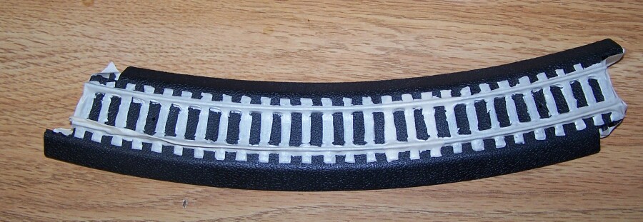

Here's my half-way point, I got 6 curved pieces painted. My jig is starting to curl upwards, can't keep the outer tie ends covered enough, so I've stopped at 5 pieces with it. I"m doing masking on a 7th piece, but have run out of Oomph now. I tried individual strips,but it's easier to just lay the tape on the track and cut it all out, even though it takes longer.
So, looking good,now if I can JUST keep up my motivation to finish the other half, I'll be set. LOL. But it's gonna look GOOD when I'm done.

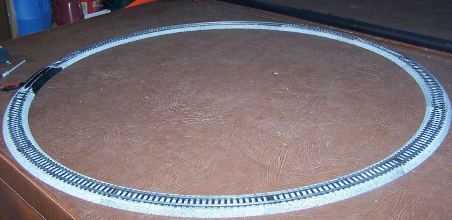

Sunday Aug 21 update - got up in AM and finished cutting out masking tape around the ties, and then painted the LAST 2 curved pieces I have to make a full circle. Yay, this project is about over! I have two straight pieces, but one of my curved sections is missing a rail joiner connector, so I'll have to rob a straight piece to replace it with. at least I'll have a full circle to use. Should look pretty, when the paint dries on the last two, I'll assemble it and try running something on the hot tub railroad later this afternoon.

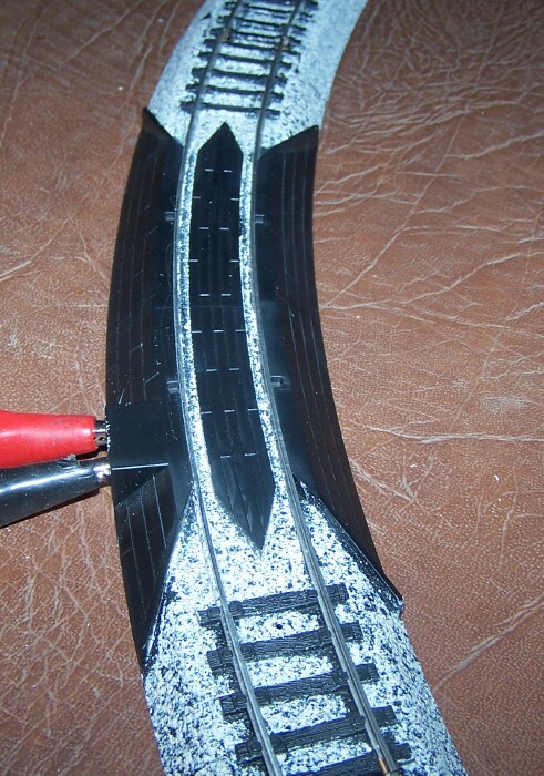

Final installment - finished circle of Power Lok / EZ track. Ran my Krauss Maffei tonight on it, found one rail with some paint that slowed it down, otherwise minimal clean-up. Had to dig out some paint in the corners where it snapped together, but otherwise a "clean" project. Man, if I could get a jig to do the straights and curves, I'd paint them all yesterday! LOL. I think it looks great, and I even left the narrow space on the power track between the rails untaped so it could get some paint down inside there, where there was molded ballast.
A first for me, a start-to-finish job in just a few days. Still want to do the straights, but I can take my time, as now I can just run the circle for awhile. Cleo, my newest cat, hasn't seen a train up close, this was her first time, she was a bit nervous,but didn't freak when the trains went round and round. Walked back and forth a bit to inspect it, though.
