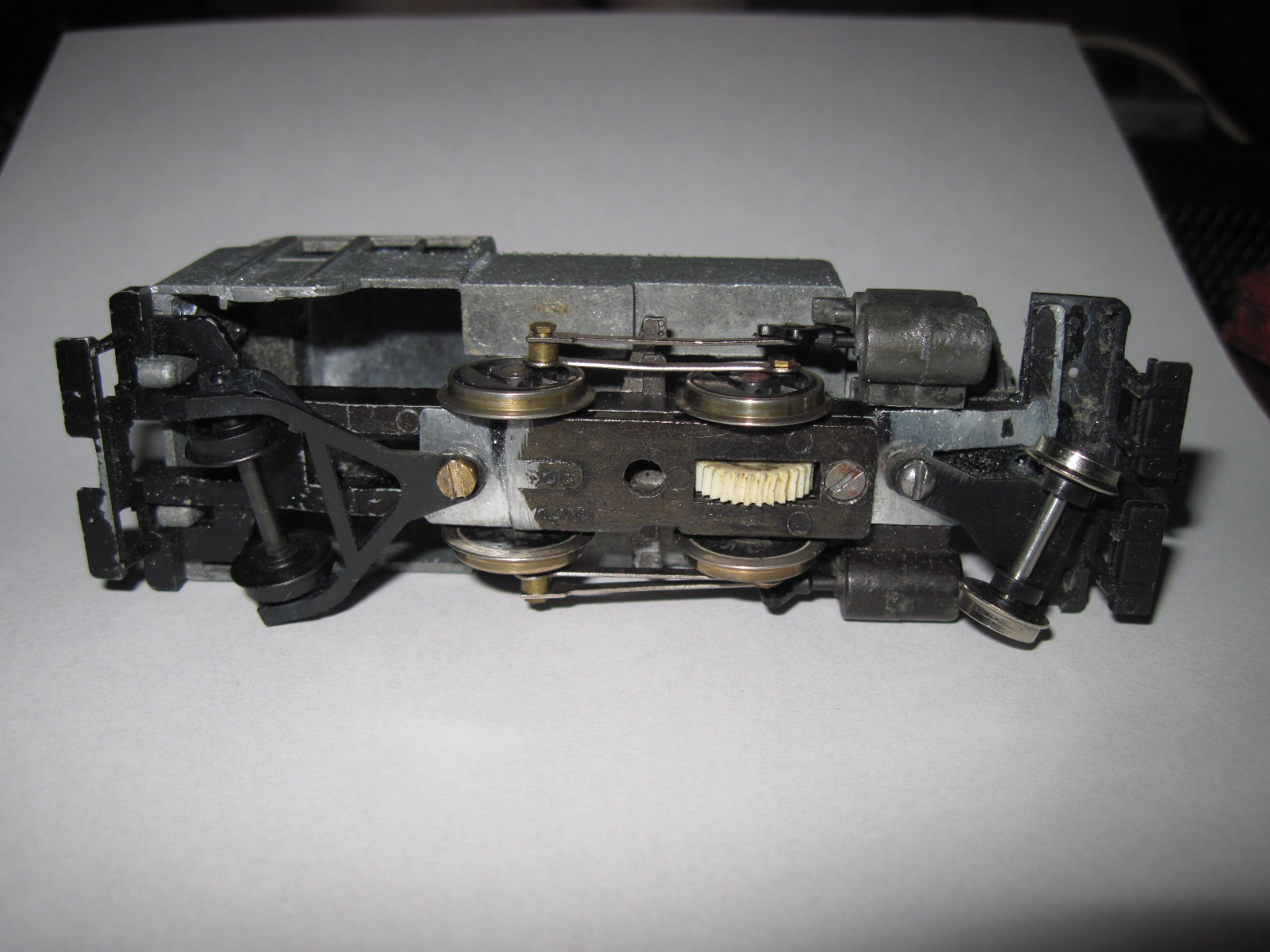

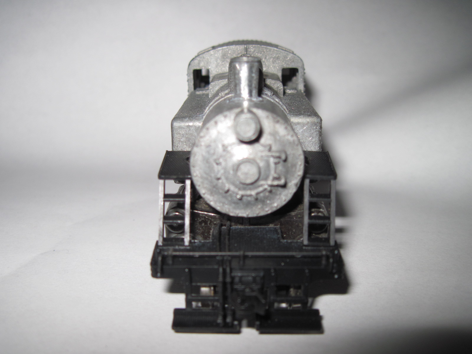

This is a project I started tonight. The rough work is done, Now I clean the parts, paint the shell & chassis and assemble:
I started with a Mantua 0-4-0 Booster steam loco which was missing the front steps. I used the front pilot truck, deck & steps from an Athearn light Mikado and the trailing truck from an Athearn Little Monster 0-4-2 steam locomotive.
I will be adding the piping detail and a couple air tanks from the Athearn Mikado

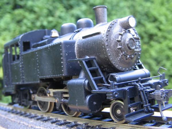

I have not yet decided if I want to add valve gear. I plan to sell it on eBay, so I probably wont. I tend to keep the good stuff for myself. The goal is this:
This one was also custom built by me with old mantua 0-4-0 Booster and junk Athearn light Mikado parts pulled from the scrap box. I added Athearn light Mikado pilot decks to both the front and rear. The pilot steps and trailing truck are also from the same Athearn Mikado. This one was sold on eBay a few years ago. Took one evening to build, paint and complete. Sold on eBay for ~$110. Not bad for a bunch of parts pulled from two scrap boxes. I started the bidding at $0.99.
