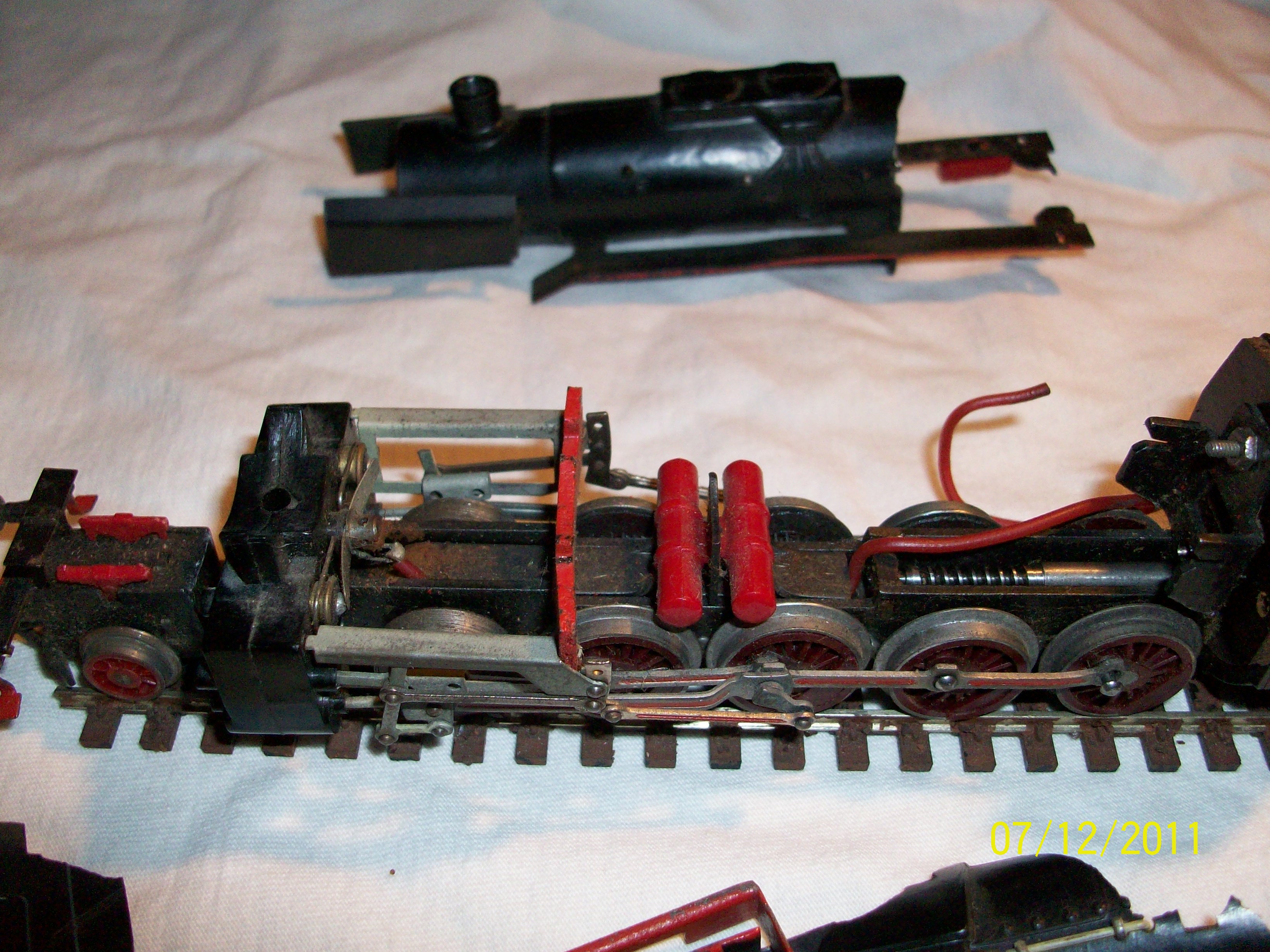

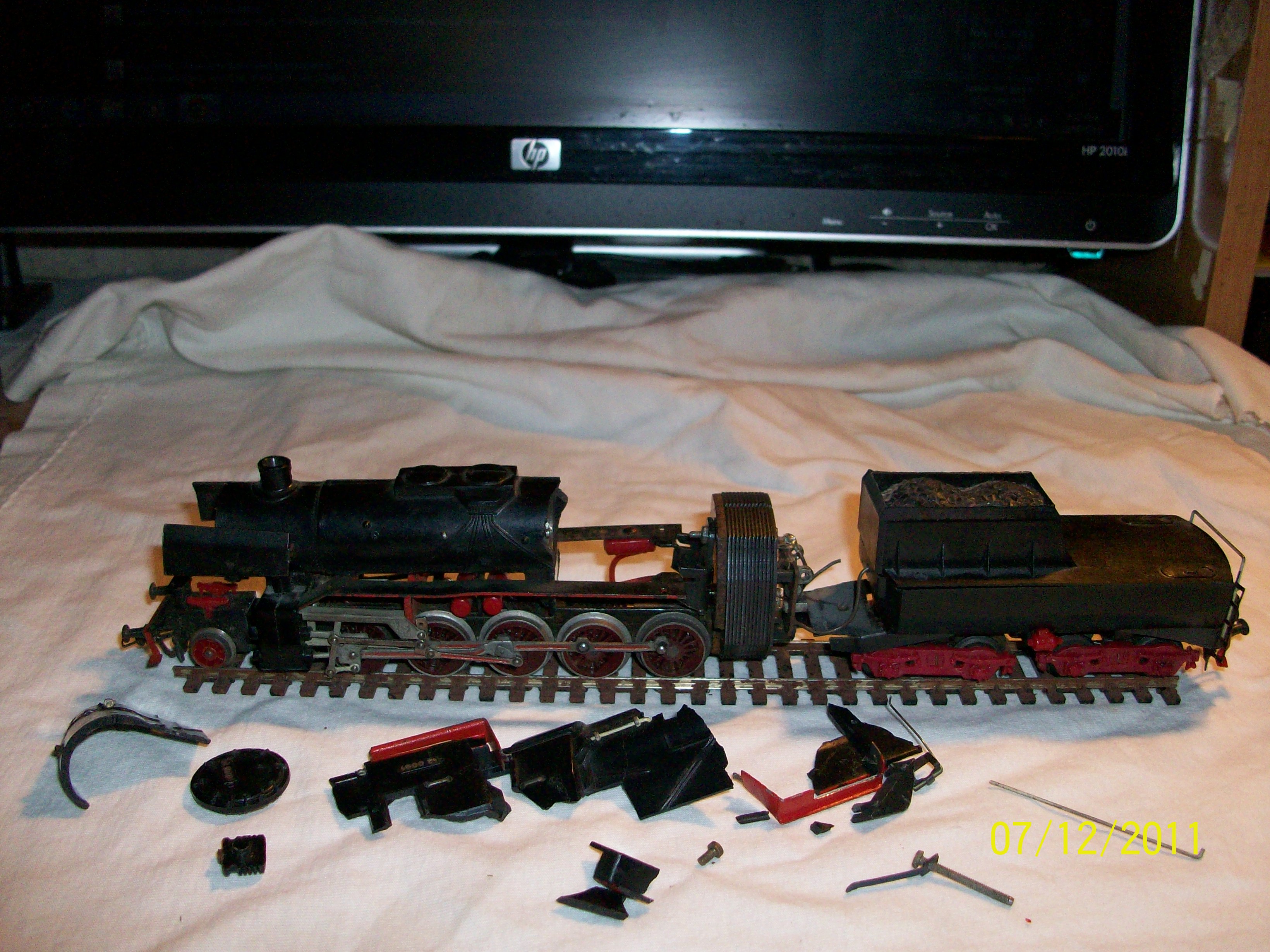

Hi Folks,
I received this engine in a lot buy and am trying to figure out who made it and if parts can be had.

Poor ol' thang sure is a hand basket!I'm guessing its a Marklin.

All I need is a boiler the rest I can make or bash.

hi ken a guess but looks like a br 42/52 by marklin ken

Hi Ken,
My guess would be a Gutzold BR 42.
Take a look here and scroll down to 42 0001... it looks like a good match:
http://www.harald-johns.com/SAMMLUNG/1-u.htm

Interesting unit. What's with the two bulbs in the steamchest?

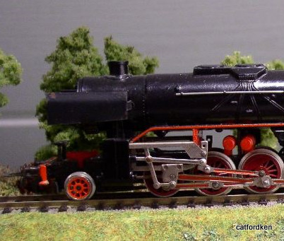

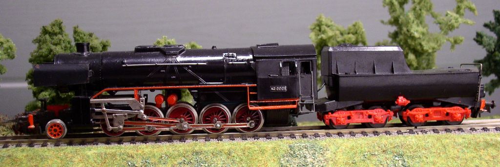

 Posted - July 12 2011 :  8:03:28 PM Link directly to this reply  Show Profile  Send catfordken a Yahoo! Message  Add catfordken to Buddylist
hi thomas,you are right guetzold br 42,nickelplate759 they are for the lamps on each side ken
the cab also shows the motor

 Posted - July 12 2011 :  8:44:31 PM Link directly to this reply  Show Profile  Add NickelPlate759 to Buddylist
Ken, I thought that might be it, but I've never seen a loco with ditch lights on the steamchest.
Ken
old feller
 Posted - July 12 2011 :  9:17:51 PM Link directly to this reply  Show Profile  Add Ken to Buddylist
Hi Nelson,
The ditch lights are not in the steamchest they seem that way by the pictures but they are just inside.
I wish I could find a boiler for it.

Thomas,
you were wright. Thanks for the web site.
Also Ken was right.
Thanks to both of you.
Now if I could find a boiler I could put it back together. I thought it was plastic but to my surprise it is backolite (or whatever) it is built like a tank.
I would like to get it fixed up it would be great. The motor runs well and all the metal parts are here.

May I ask what the 2 red things are above the wheels are for? Guessing air tanks?
 Posted - July 13 2011 :  06:18:15 AM Link directly to this reply  Show Profile  Send catfordken a Yahoo! Message  Add catfordken to Buddylist
hi ben as far as i know they are air containers,ken

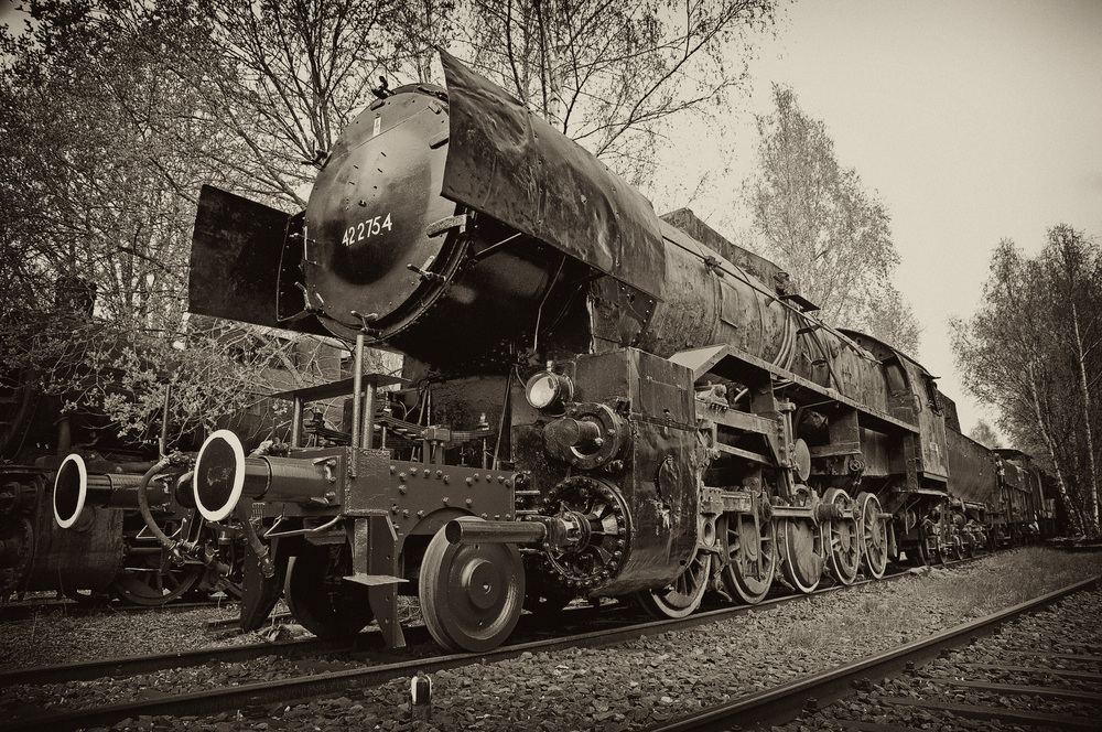

This Gützold 42 is very rare! Early Eastern-Germany production!
Maybe a Liliput 42 boiler/cab could be adoptet!
The 42 is similar to the more famous 52, but the 42 has a biger boiler!
If you dont mind that, you could use a boiler of the 52 too! - Erich
More about the real thing (it was also built in my hometown Vienna):http://www-personal.umich.edu/~khmiska/_derived/BR42.htm

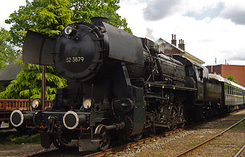

Yes off course, if you dont mind differences, wheelbase is the same but steamchest and pilot and other parts are different! Headlights are placed different! (boiler of 42 is bigger in diameter).
But ist hard to distinguish a 42 from a 52 at the first look!
I recomend to study pics from both!
Just add "BR" like BR42 or BR52 if you google it! - Erich

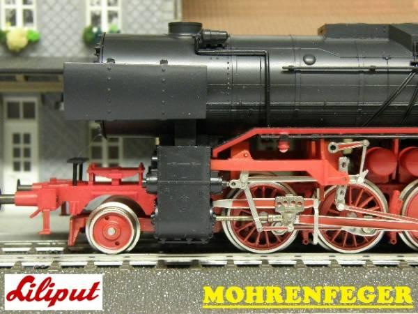

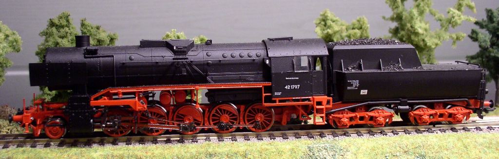

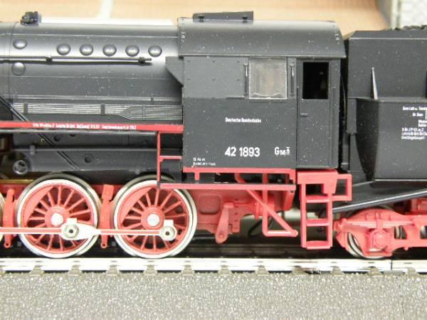

 Posted - July 13 2011 :  09:37:53 AM Link directly to this reply  Show Profile  Add Erich to Buddylist
Gützold 42
Liliput 42 (truescale)
Kleinbahn 52 (shorter than scale)
What diamater (outside) and lenght is the Gützold boiler? - Erich

Hi Erich,
Thanks for your reply.
The Dia. is 26.5mm Length aprox.115mm can't tell the lenght because it is all in pieces so that is my best guessken

lenght of 115mm is right, but boiler dia of a 52 in truescale is ca. 21mm, so it is to small!
Only chance I see is a boiler of a liliput 42 but I have no one on hand to meassure!
I will check it out for you, but it will take some time! finding a cheap boiler also! - Erich

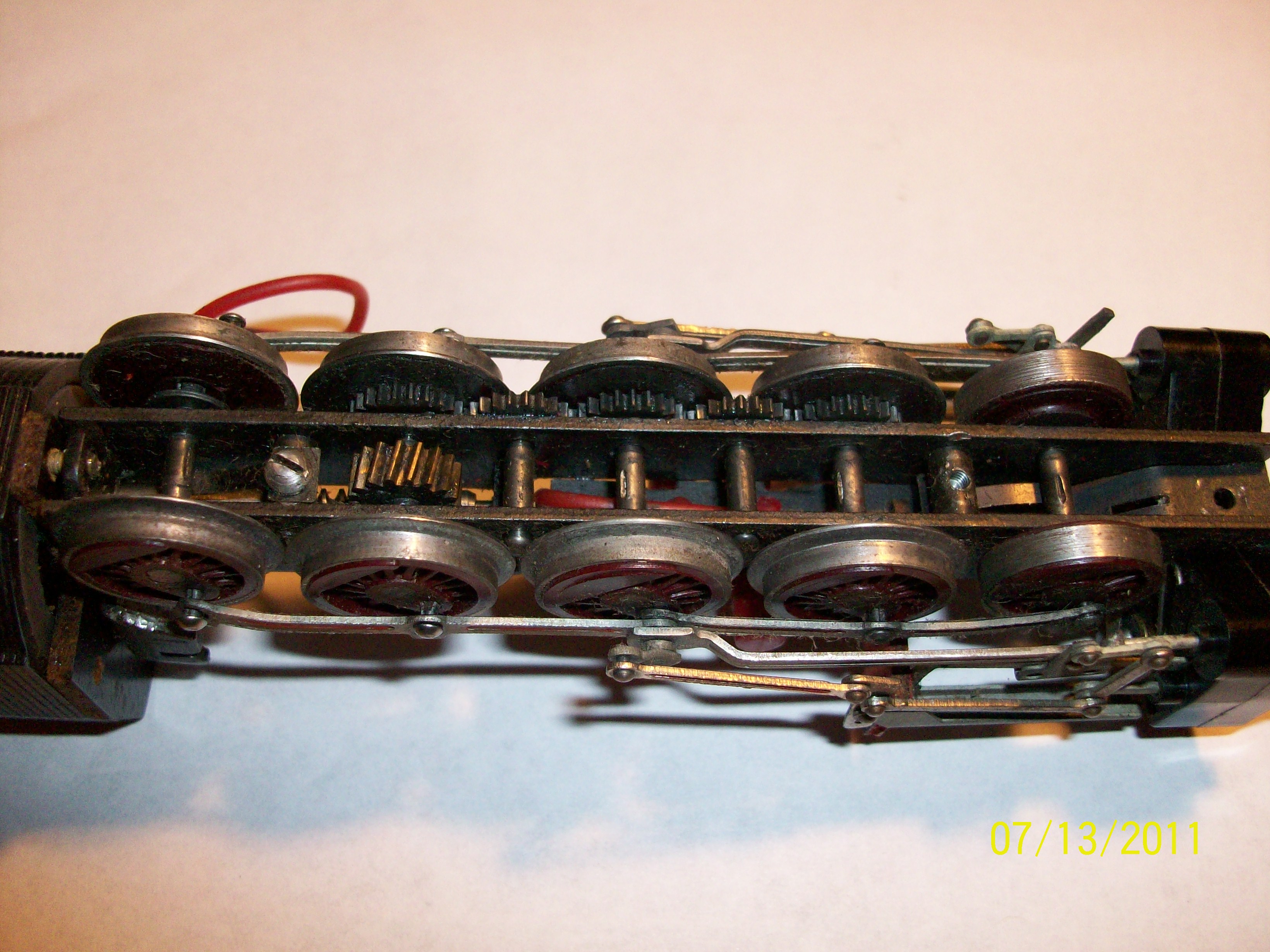

I would guess that it is a Class42/52 DB decapod. I can see it wasn't repaired correctly. The first driver which it blind should be the center driver. That is where the flangeless, blind driver belongs. You can also see flanges on the third and forth drivers overlapping. This loco can run because of this. I have a Gutzold decapod and it is tender drive. I have seen similar motors on old Rivarossi locomotives. I would guess the old Gutzold locos had the drive it the loco. The plastic looking air tanks are on my Gutzold decapod. The way the tender trucks look under the tender body is just like a Gutzold tender I have. Knowing Peko made the same loco as Gutzold. One West German and the other East German, it has to be one of them.
 Posted - July 13 2011 :  5:18:09 PM Link directly to this reply  Show Profile  Send catfordken a Yahoo! Message  Add catfordken to Buddylist
frank if you look at all the gutzhold locos on this page the flangeless driver is in the same place on the first wheel not the centre ken
Edited by - catfordken on July 13 2011 5:22:44 PM
 Posted - July 13 2011 :  5:34:58 PM Link directly to this reply  Show Profile  Add toptrain to Buddylist
Ken i see what you mesn but in one photo they seem to overlap and thats not good. Maybe just a bad photo.
 Posted - July 13 2011 :  6:14:32 PM Link directly to this reply  Show Profile  Send catfordken a Yahoo! Message  Add catfordken to Buddylist
frank i agree,weird though,most locos like you say have the flangeless driver or drivers in centre the liliput has it by the cab,ken
Edited by - catfordken on July 13 2011 6:16:21 PM
Ken
old feller
 Posted - July 13 2011 :  7:04:22 PM Link directly to this reply  Show Profile  Add Ken to Buddylist
I understand that the third driver should be tireless but look at this picture if the third was a tireless it would not fit with the gears on it.The middle three drivers are all geared. The motor is something else I took it apart and I mean apart when you remove the 2 bolts that hold it in the frame you also take the motor completely apart.All gears look good the motor now runs great the valve gear all work well.Had to put new brushes in the motor the old ones fell apart when I took them out.
Any ideas on the plastic kit for this the dealer said it would work has anyone ever got one??

Flanges on all wheels! - Erich

oops,what a difference a good photo makes,erich,but i stick by rest of statement the gutzold has it at front,where if a flangeless wheel is fitted its more likely to be fitted in centre,ken

Yes the Gützold has is flangeless whells on the front!
They did this to hide it behind h the valvegear, crosshead and steamchest! - Erich

What is the reason for the flangeless drivers?
 Posted - July 15 2011 :  09:12:26 AM Link directly to this reply  Show Profile  Send catfordken a Yahoo! Message  Add catfordken to Buddylist
hi ben in theory it allows you to have more wheels/length to loco and still get around tight curves,without derailing ken

I would like to thank all you guys for all your comments. From then I have got all the info I need to complete my project. I went on Bachman EU site and got all the info I am sure will help.
If you have'nt checked out the EU sites you should it will let you know what is going on over there. Very interesting.
Thanks again.
This is what this site is all about.
