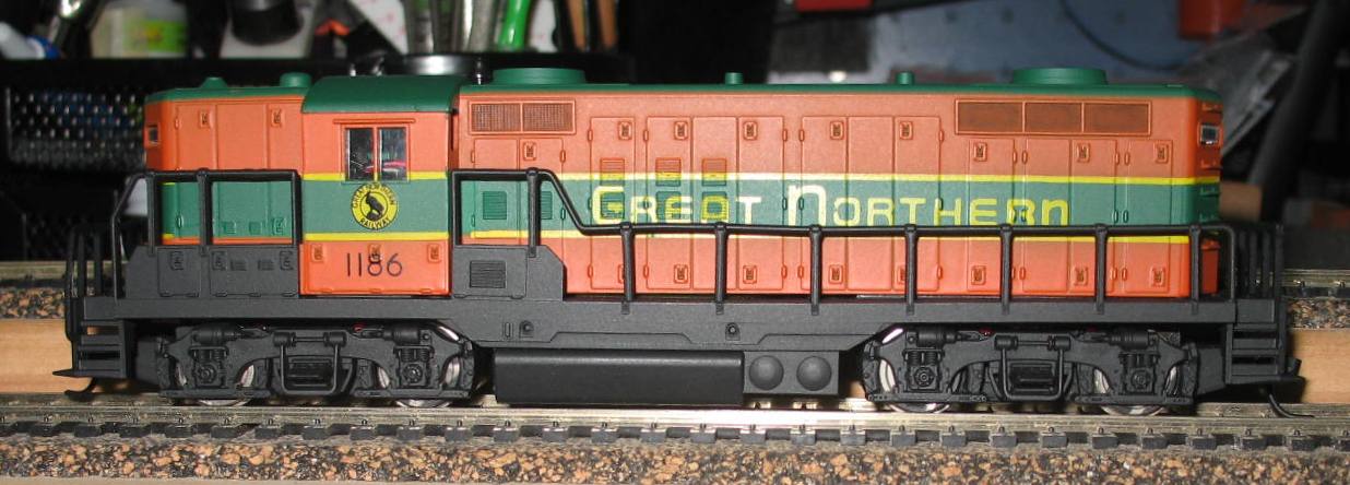

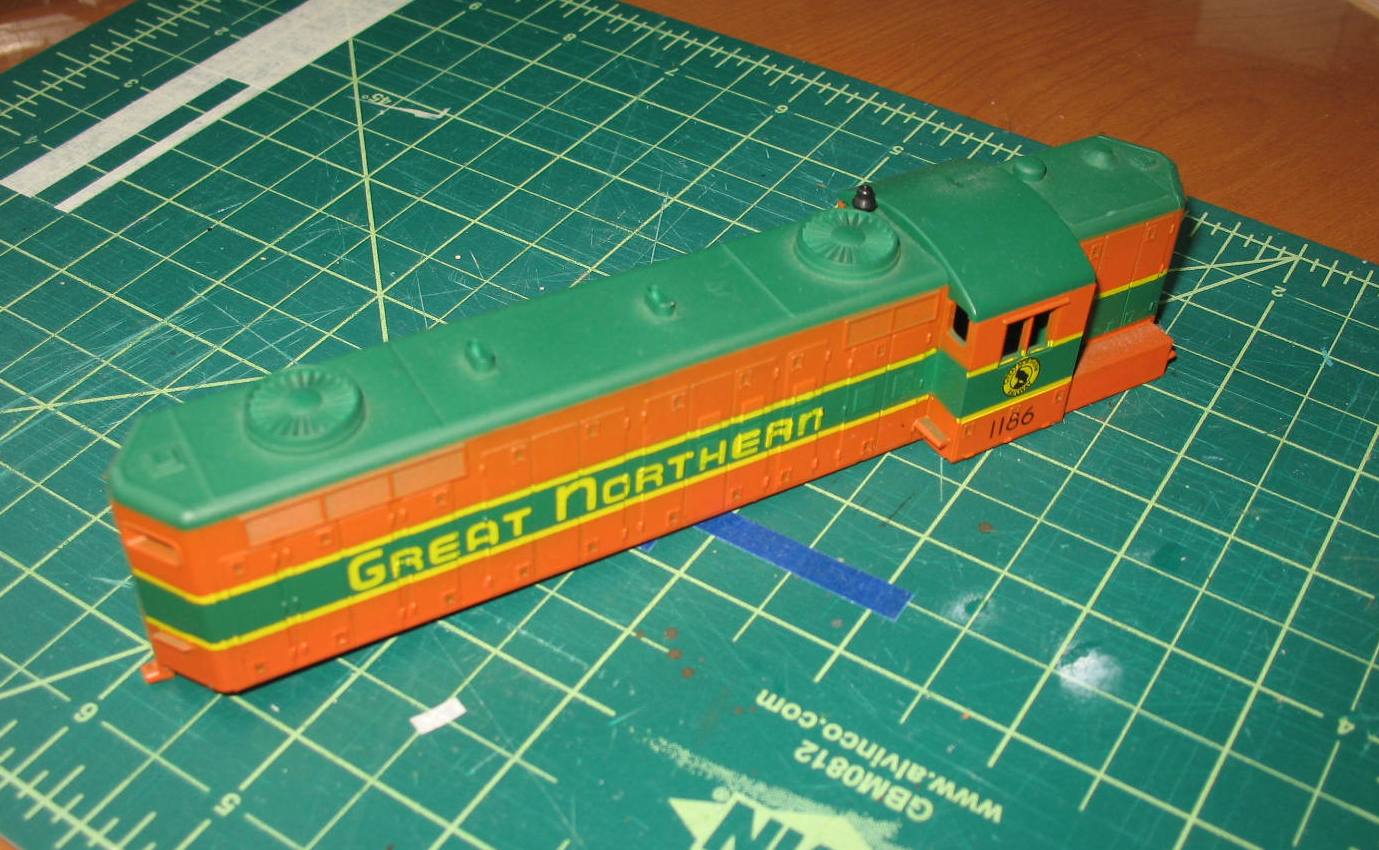

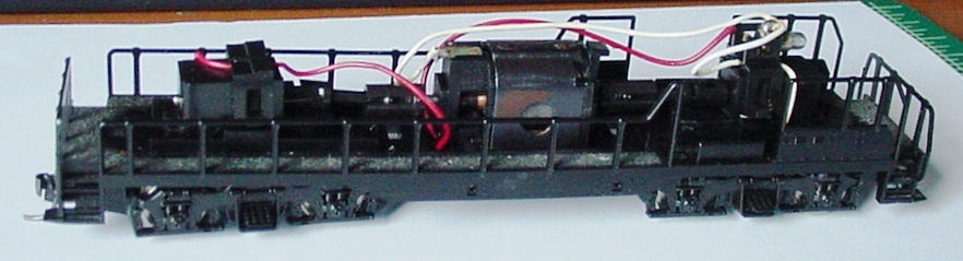

I just finished my second effort at restoring someold flea market specials. I had this one from two years ago that would light up but did not run, so I replaced the motor, added a second light and did some minor refreshing of the hood and lower chassis. The vents were treated with a few applications of diluted india ink/91 alcohol wash and I just used flat black on the lower desk and fuel tank. The trucks were covered with engine black then the lower asembly was dullcoated. I replaced the cloudy OEM cab window part with individual clear plastic, but used commercial double-stick tape, rather than Testors cement for clear plastic.

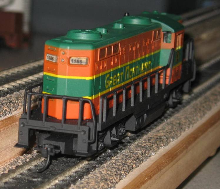

I added a second light (LED) in the rear and created simple Arial font number boards on adhesive flat finish address labels, then dullcoated the ink before installing.
The old beast runs well and all I need is to refresh the couplers with the proper Kadees I just got in the mail. Total investment was less than $10.00 cash and a few hours of TLC.

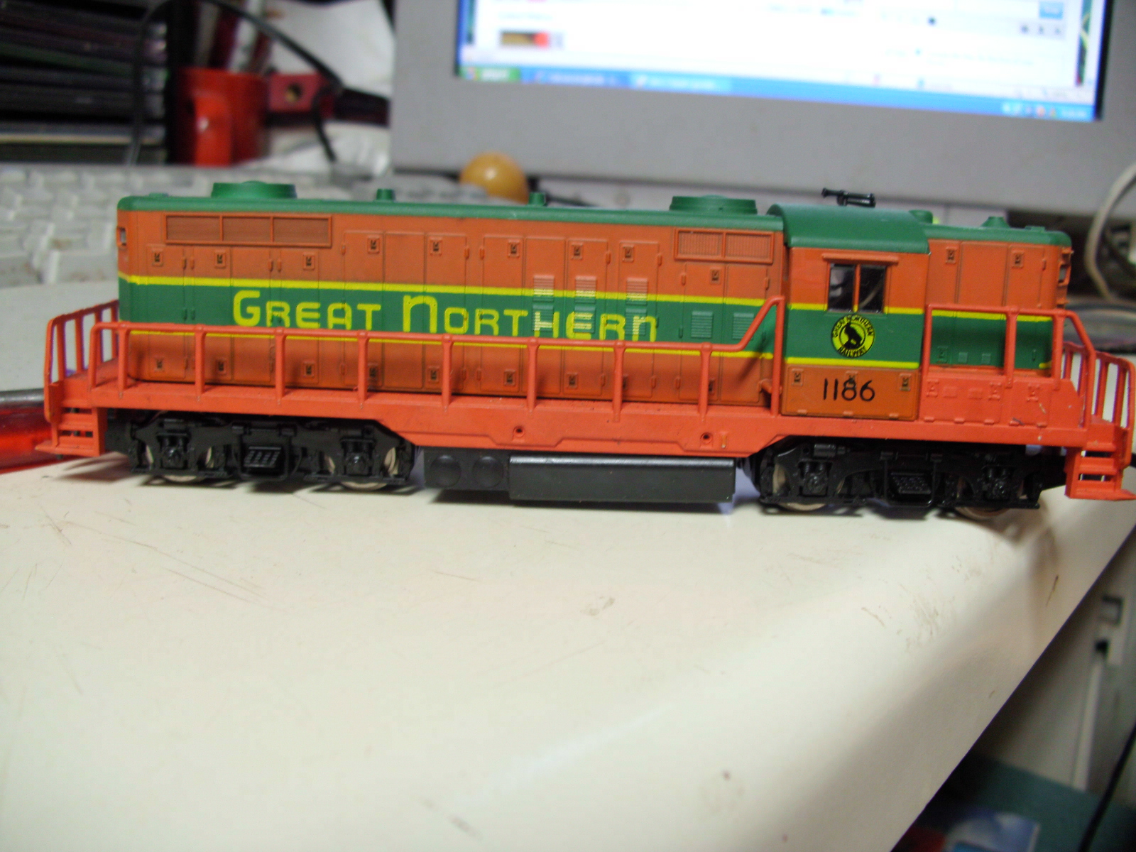

That one piece of missing porch railing in the 4th image was reglued with a dot or two of 3M plastic trim adhesive (works on Delrin!) and I didn't weather, as per my preference for it appearing "revitalized". It sure runs better and is a welcome operating capital equipment item on the Minnesota, Sioux Lake & Western. As they say (whoever "they" are): Choo-Choo-Sheboogie!

Nice work, Ron. I guess it's pretty quiet with that Igarashi in it. Did you use double-sided tape to mount it?
The frames for these are actually styrene. I was able to repair a handrail on mine with CA.
siouxlake
 Posted - February 08 2012 :  7:55:46 PM Link directly to this reply  Show Profile  Add siouxlake to Buddylist
Well, Nels, I was thinking Delrin, due to my prior AHM experience last fall, but two tiny dots of that 3M adhesive worked. I also cut the interior weight in 3/4 + 1/4 parts and then used my sophisticated metalworking machinery, otherwise known as an engineer's hammer to flatten and reform the smaller piece, which I painted and stuck onto the interior ceiling of the cab with that same 3M adhesive, to preserve the original weighting. The cut was needed to ensure that the wiring running above the new motor would allow the hood to reseat onto the chassis. I did use doublestick tape in the motor cradle, as I found that foam tape resulted in a fit issue withe the wiring and the hood, despite the 1/16 inch elevation of the motor.
It's quiet and smooth on my test track, which has the same cork track base as my a-building engine/freight yard. The hood was just washed with mild dish soap to remove grime, but no other treatments other than the vent washes.
To me it's a beauty, despite the truck mounted couplers and so-so paint job. That GN goat logo is pretty grisly, and I considered replacing it with the more appropriate 1950s GN decal, but that might have messed things up.
Thanks for your interest!
Ron

I bought a set of four of these from Howard Mosley, from his EBay site, as recommended by Nelson/Nickel Plate. These are dual shaft sealed can motors, but Nelson would be a better source of specifics regarding their performance data. They were individually inexpensive, virtually a dimensional duplicate of the original AHM motor I removed from the GP18. When I first tested one of the motors on my bench, it was smooth, quiet and seemingly vibrationless. I believe it runs at a lower rpm than the original, but again, Nelson is a better person to ask.

Ron, I first thought many of the AHM locos had Delrin frame/handrail castings too, but most are styrene (GE Centercab, GP18, C420, Alco 1000, etc.) and can be melted with solvent glues or repaired -- more or less, since it's a pinpoint repair -- with CA. The only handrails that are flexible and ungluable are on the RS2 and BL-2.
