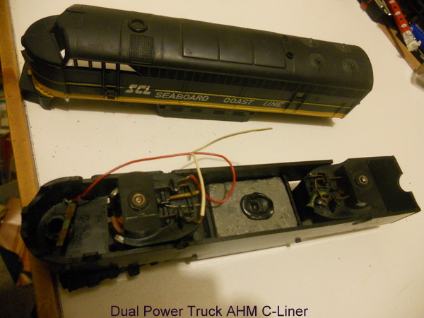

Another one of my projects. Dual power trucks for the C-Liner. Fairly simple mod. Measure and cut opening in the front of the frame. Drill holes for the motor pin. Install a power truck from a salvaged C-Liner. Other than adding cab windows, I don't think I'll do anything else to this unit.

That is a good project. I was just emailing someone one doing that to Bachmanns with the Kader motors. Well done.
How is it running? It would certainly make use of the extra weight.

Haven't got it running just, yet. Plenty of room for more weight. Should pull very well.
 Posted - March 09 2012 :  8:59:31 PM Link directly to this reply  Show Profile  Send AMC_Gremlin_GT an AOL message  Send AMC_Gremlin_GT a Yahoo! Message  Add AMC_Gremlin_GT to Buddylist
are they 3 or 5-pole motors?

3 pole

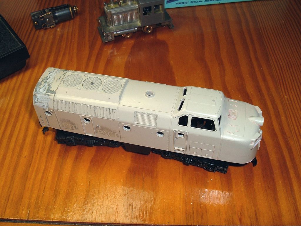

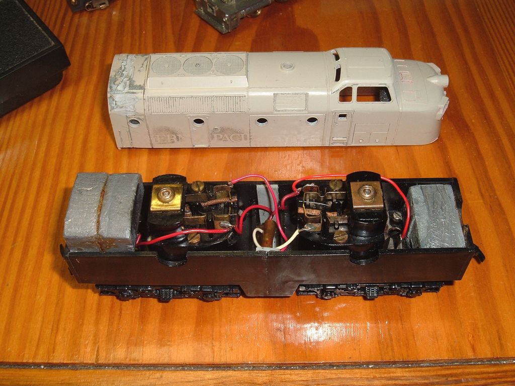

NC, any plans to swap the traction tire wheels for standard ones? It shouldn't need the tires with 8 wheel drive and enough lead.
The 60's version of these had 5 pole motors. I found this project loco in a junk box at a train show, and this is it after a lot of work and paint stripping.
Someone cut down a Rivarossi Krauss-Maffei shell (didn't do a very good job of it ), and slathered it in red paint. The frame is two C-Liner rear chassis joined together, which was done well. The trucks were dripping in something between gray and black. I thought of putting this inside a 40 foot boxcar, but finally used the parts to restore other units. It sure pulled like mad!

NickelPlate759,i spy with my little eye a nice little something in that photo,ken
 Posted - March 12 2012 :  4:33:13 PM Link directly to this reply  Show Profile  Add NickelPlate759 to Buddylist
Ken, I can always resurrect it.

Nelson; Ken is likely speaking of the Lindsay Whitcomb Switcher that appears at the top of your picture.

Gotcha. Forgot it was in the picture. It's a D-1, and it's been repowered with a slim can motor. The original had too much vibration and ran too hot. There's no ventilation for it inside that hood.
P.S. It's a Penn Line Midget.

The last incarnation of these C-liners got a drive similar to the GP18 (and late RS11/RS2), the same motor in the middle of the chassis driving all eight wheels. I don't think the BL2 ever got this drive, but the FM lasted long enough to be sold by IHC (most notably the Corky's Circus Train version). I have, or have had, an AHM example in the box. They're scarce but out there, and a dummy unit would give you enough to make a powered using a couple of junkers for the guts.
