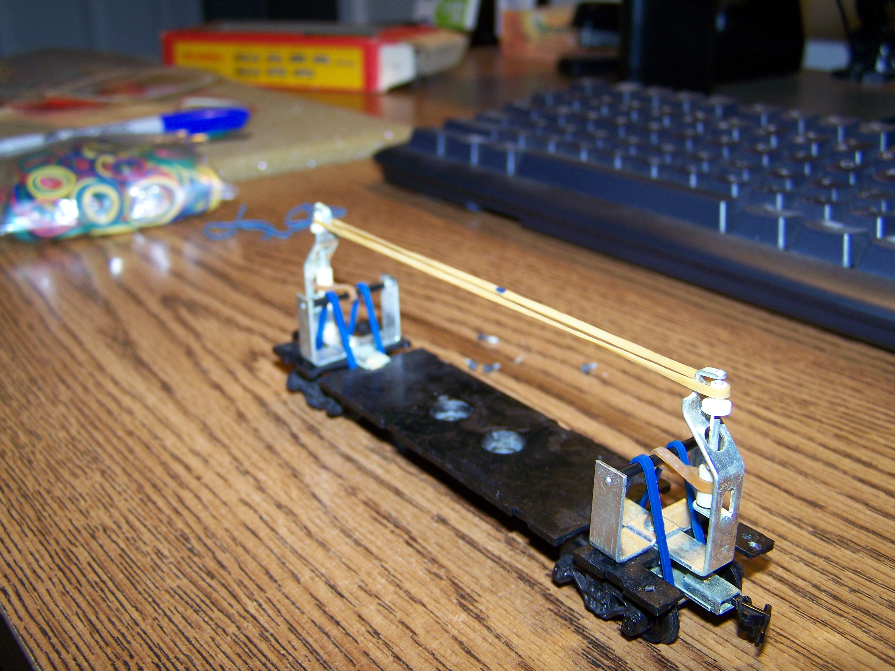

 Posted - November 02 2008 :  9:46:26 PM Link directly to this reply  Show Profile  Add eaglerock109 to Buddylist

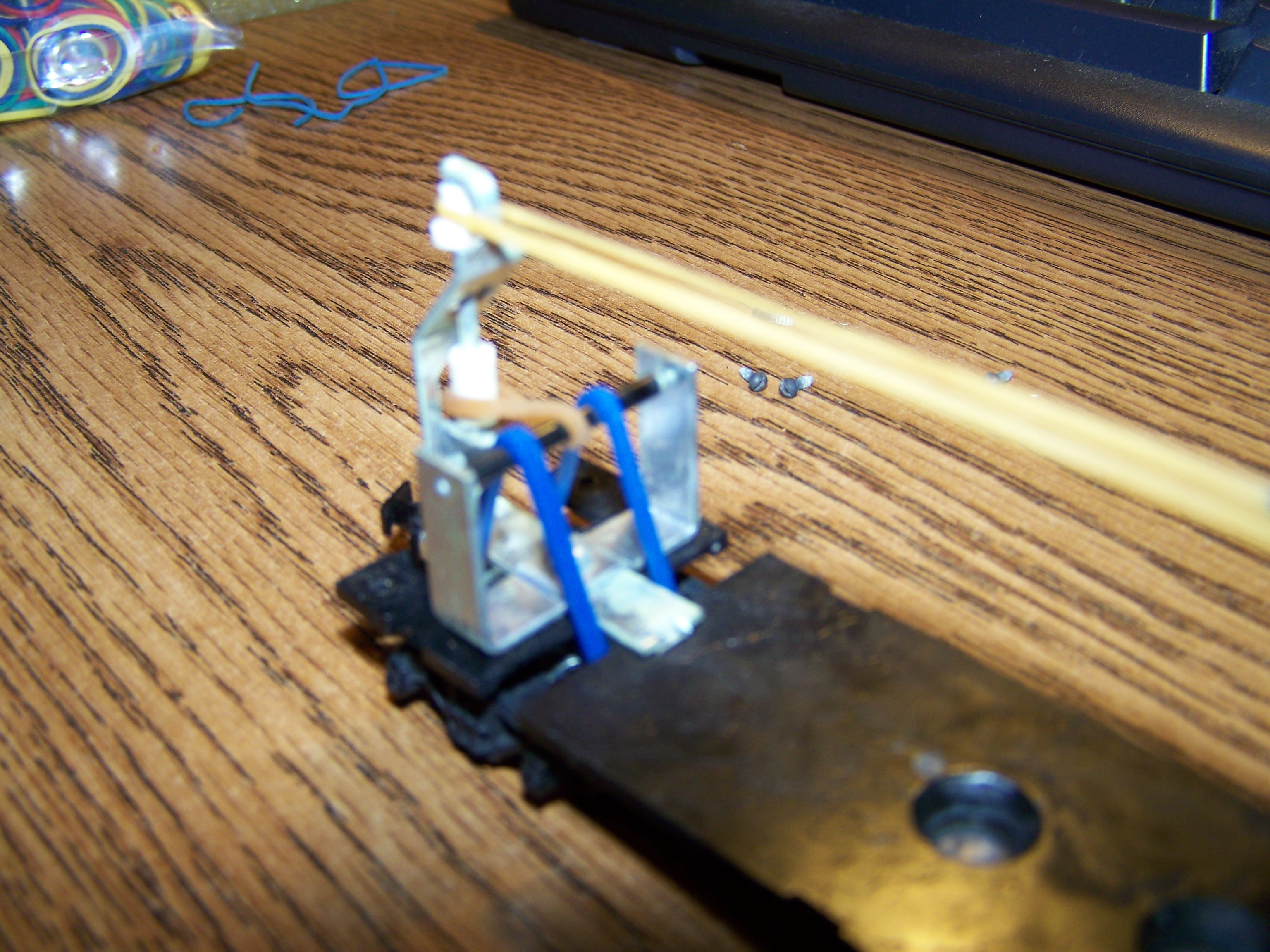

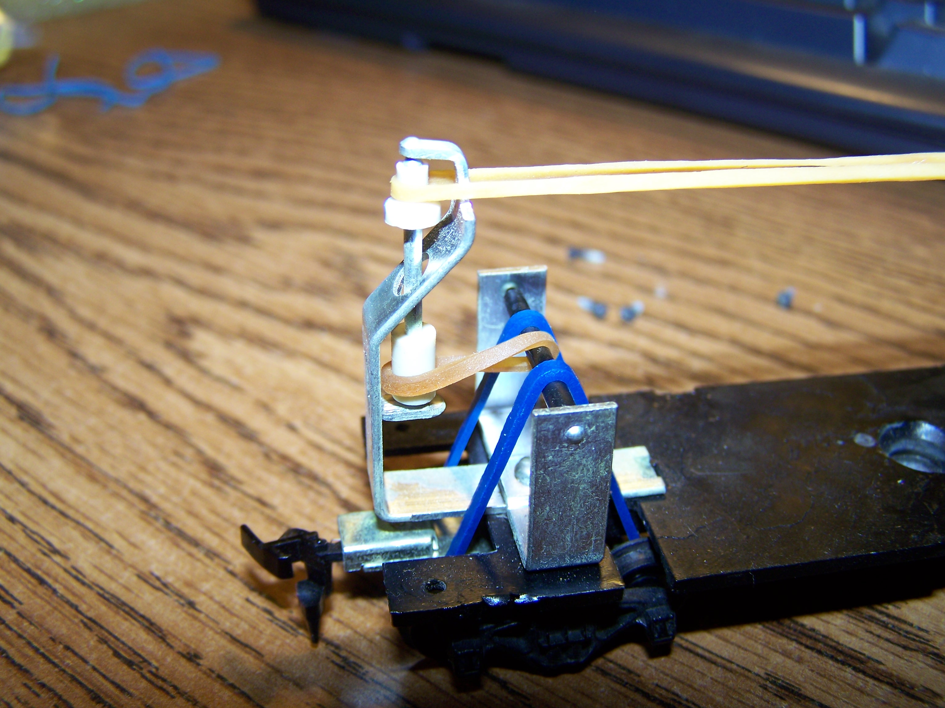

I had sometime to start fixing the brakeman car. The first photo shows one side of the car with the rubber bands in place. The first rubber band to be installed is the band that connects the cross bar and the spindle. To attach the band remove the cross bar and spindle. Gently bend back the metal piece at the bottom of the spindle to remove it from it's mount. Place the band onto the spindle and replace it in it's mount. Take the crossbar and slide it throught the rubber band. Replace the crossbar. The second pic has a lame attempt on my part to add text to the pic for clarity.
Attachment: bluebands1.JPG ( 397082bytes )
I think this file is to large to display but it downloads.

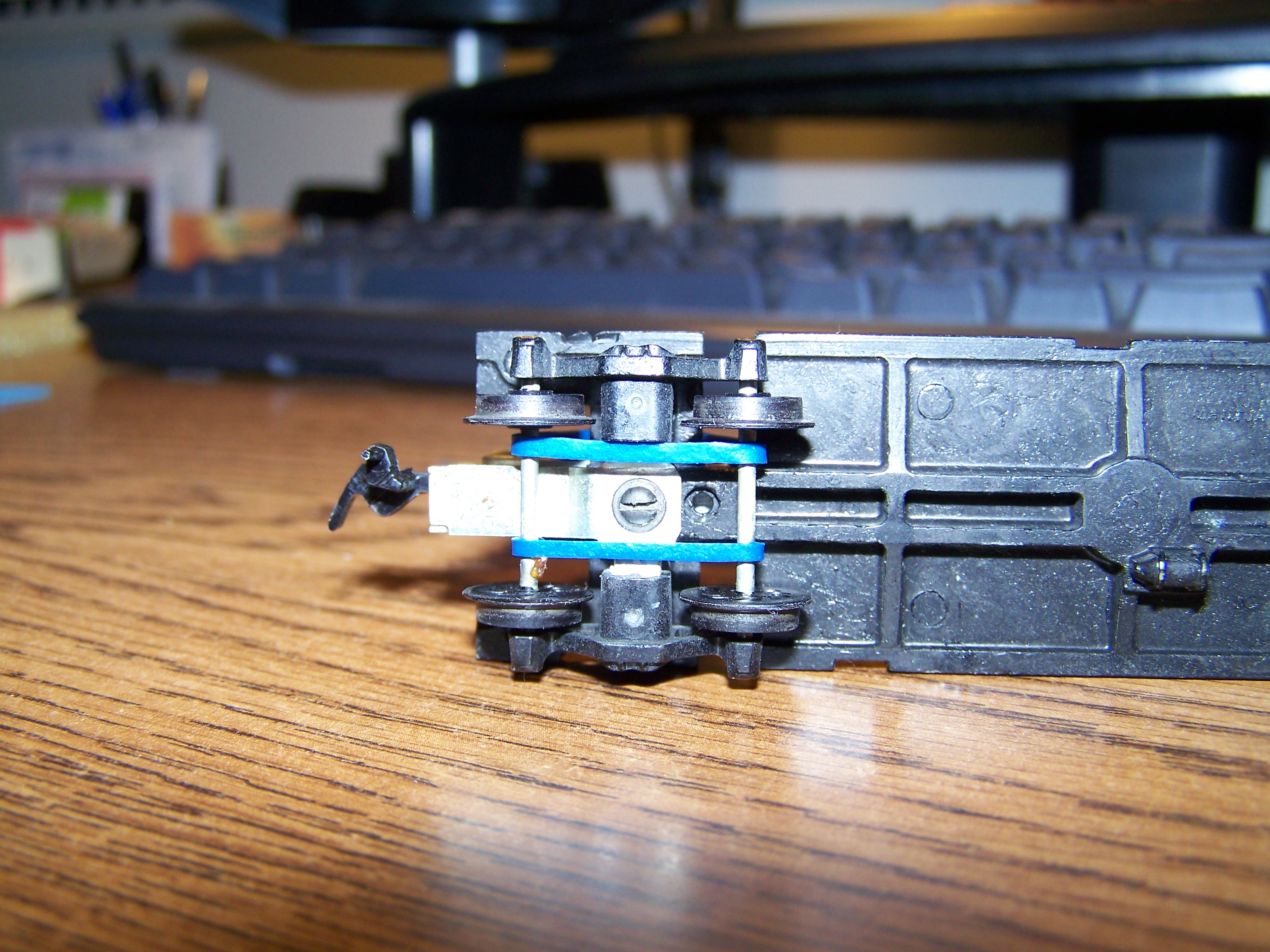

The next pic is of the bottom of the car to show the 2 bands on the axles of the trucks, followed by a shot of the spindle to crossbar band.
The next pic is of the car with the top band in place. This is the one the brakeman rides on.
To test the car prior to assembly I mark the rubber bands with a Sharpie and push the car on the track. Watch the marks on the bands to insure they are moving. If they are then proceed, if not the bands are be to tight. This is where the trial and error comes in. Work backwards from the top band, remove it and test again. If the axle and spindle bands are moving then the top band is to tight. Find a larger rubber band for the top. Follow this method and change any bands until all bands are moving.

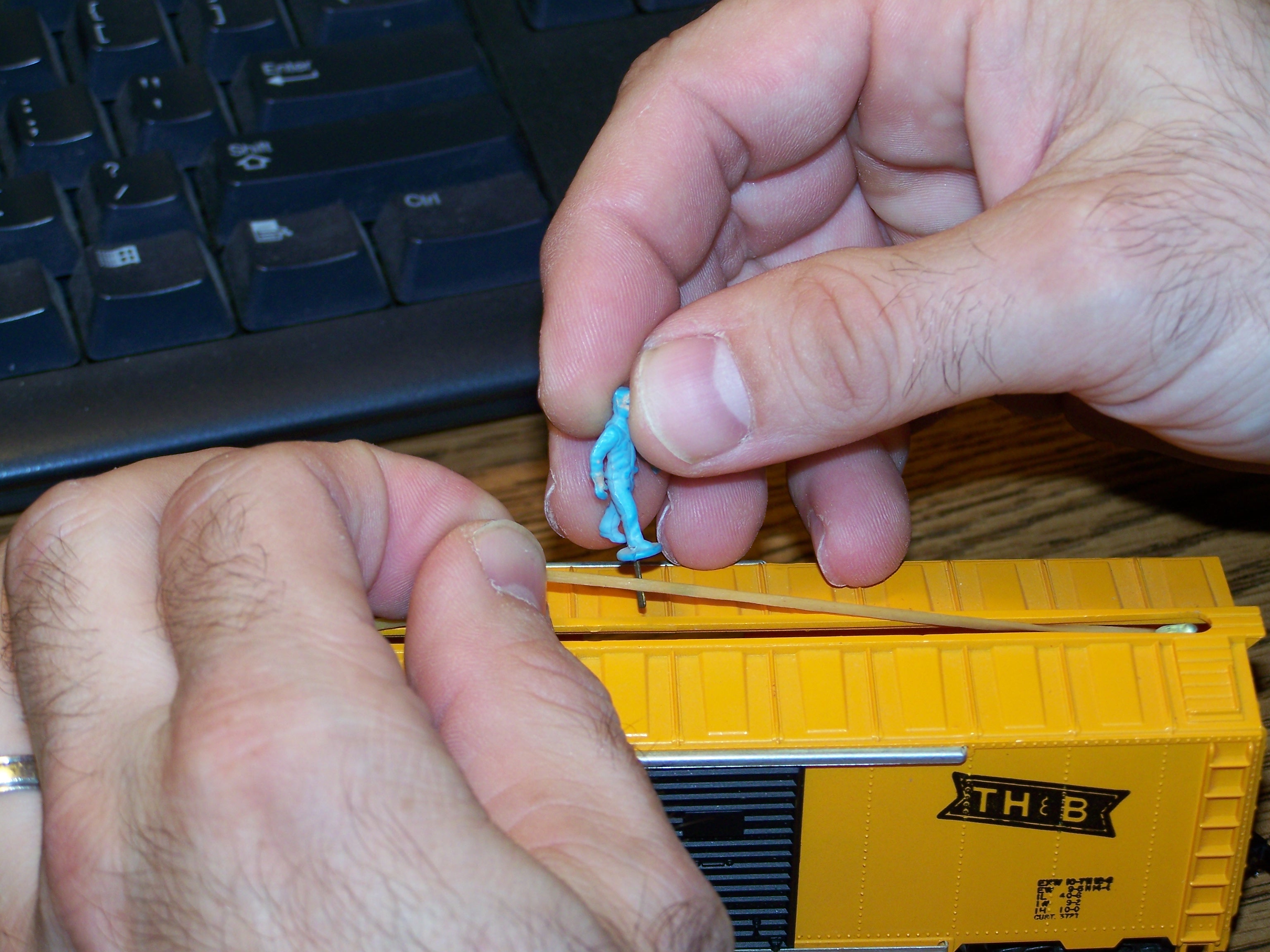

The brakeman is attached after the car is assembled. After assembly find something to pull one side of the top rubber band out of the slot on top of the car. I use a dental pic, tweezers or someting of that nature might work. Carefully spread open the clip on the brakemans foot, slip the clip onto the rubber band and clamp it with pliers to secure the clip to the rubber band.
Now the brakeman is ready to hit the rails. Hope this helps anyone out there trying to fix this car.

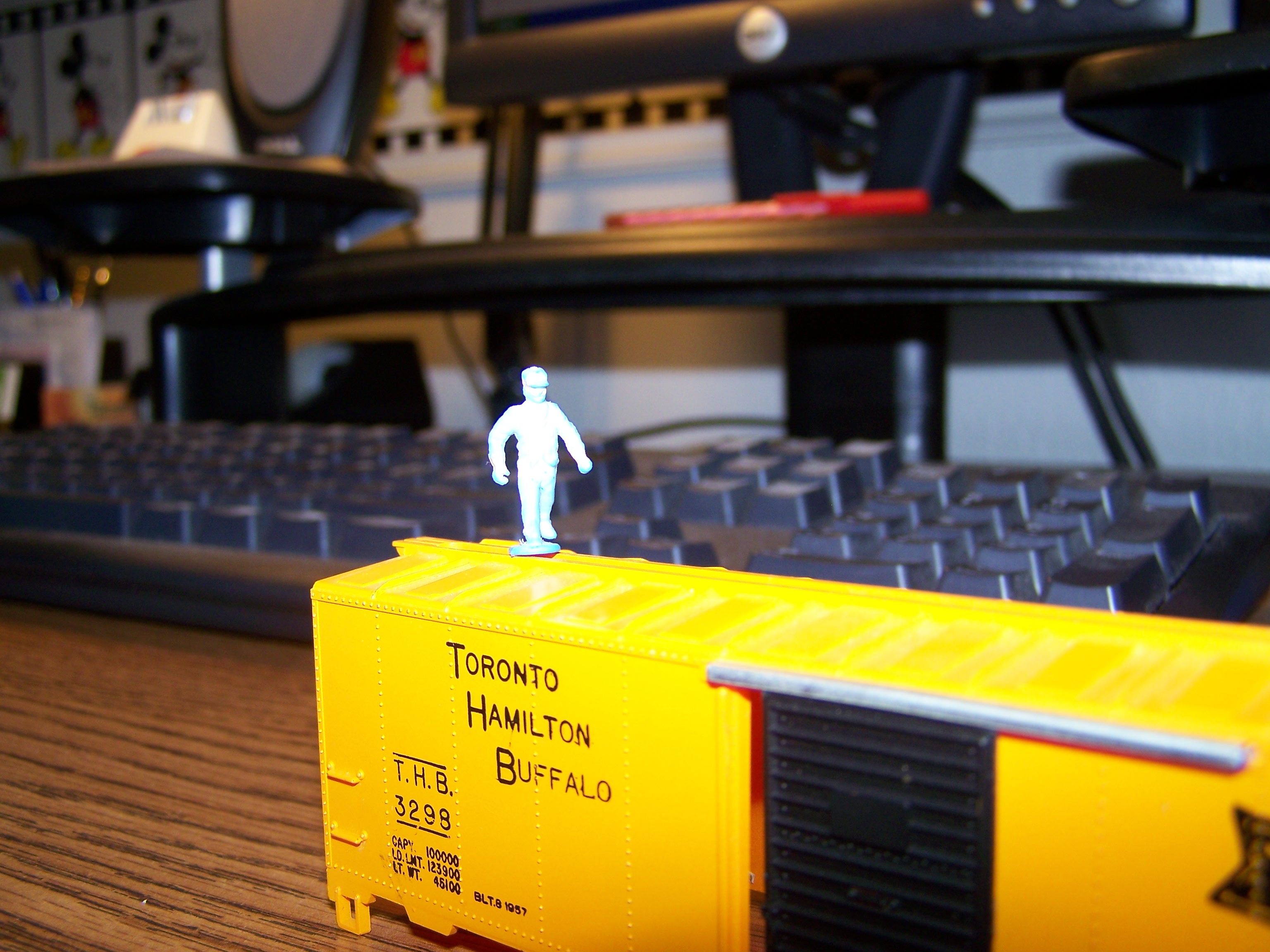

The last pic is of the brakeman on top of the car which is unassembled.
