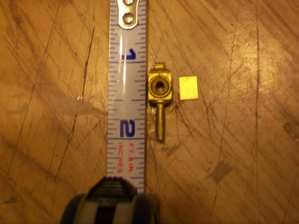

Now to fix the boiler being 1/8" short. I made 2 rings using brass pipe of 2 different sizes. One 3'8" long, fits snuggly inside the brass pipe used in the boiler. the other 1'8" long is of the same pipe as the boiler. I krazey glued the smaller inside the boiler leaving 1/32" lip extending out of the boiler. That is where I am now.
* You can see everything I have just described. Also the second ring ready to install.

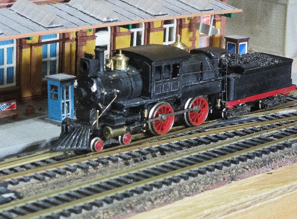

Thanks Mike. I have put 3 hours in this 4-4-0 this morning. I made a light. I had a front casting of a light from a MDC climax and just added everything else. Even a shelf. Because of the time waiting for glue to dry, I worked on the tender filling in around the motor. This is a coal burner so I will fill the tender with coal covering the plastic overlay. I am sure all will work out alright. Thanks for the offer Mike.
* Here is the 4-4-0 right now.

* Here is the 4-4-0 with coal in the tender. the new light painted black, the fireman's shelter supported, sand pipes installed, I changed the smoke stack, front walkways resurfaced, hiding all the times I have changed them.

 Posted - May 01 2014 :  5:38:16 PM Link directly to this reply  Show Profile  Add toptrain to Buddylist
Some touchups and a even coat of paint.
 Posted - May 04 2014 :  8:12:39 PM Link directly to this reply  Show Profile  Add toptrain to Buddylist
Almost done! Maybe I am.
About my choice of road number. Number 5 is the locomotive "David Laury" A man with quite a history of service to his comunity and the Lehigh Valley railroad. This locomotive was chosen to pull the first run of the "Black Diamond".
Edited by - toptrain on July 10 2022 09:30:41 AM
 Posted - May 04 2014 :  8:24:29 PM Link directly to this reply  Show Profile  Add NickelPlate759 to Buddylist
Wow! Love it, Frank.
 Posted - May 04 2014 :  8:30:53 PM Link directly to this reply  Show Profile  Send catfordken a Yahoo! Message  Add catfordken to Buddylist
frank,that is a sweet loco,worth waiting to see ken
 Posted - May 05 2014 :  12:05:42 AM Link directly to this reply  Show Profile  Add Barry to Buddylist
Very nice model. Looks ready to go get some work done now.
