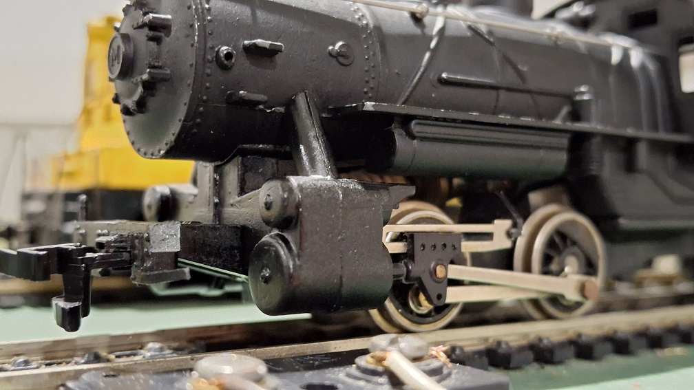

A bit late, but I recently repainted the cylinders on one of my Tyco shifters. I used Rustoleum matte paint & primer farmhouse black. It ended up being an exact match. I don't see why the black on the Pacifics and Mikados would be different from this. This specific engine is from 1960, from set T615 "Early Bird West".
