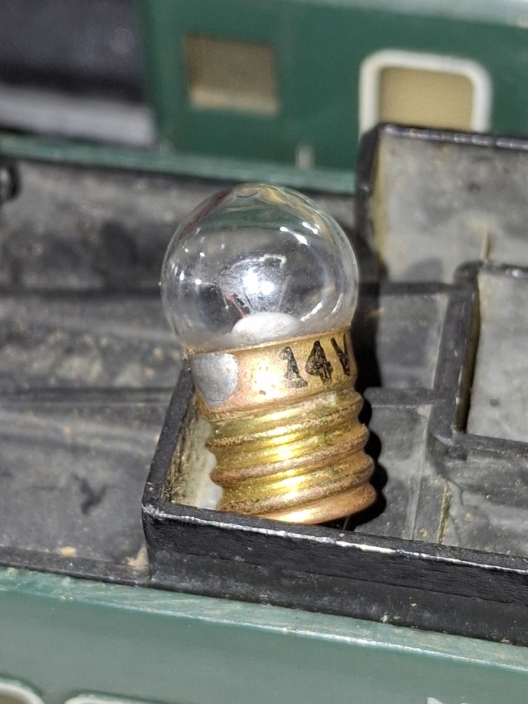

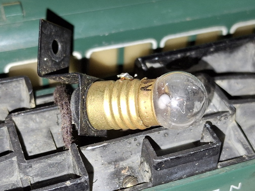

 Posted - October 18 2024 :  6:17:11 PM Link directly to this reply  Show Profile  Add Yellow_TankCar to Buddylist
Here is what they look like.

 Posted - October 19 2024 :  12:03:16 AM Link directly to this reply  Show Profile  Click to see DaCheez's MSN Messenger address  Add DaCheez to Buddylist
I'm looking around on google, and it looks like an E10 Edison Miniature Screw base. Amazon has a number of bulbs that look similar, you just need to make sure you get the correct voltage. Something like this...
https://www.amazon.ca/CEC-Industries-Bulbs-G-3-5-Shape/dp/B00JNFBZMU/ref=asc_df_B00JNFBZMU/?tag=googleshopc0c-20&linkCode=df0&hvadid=706760194702&hvpos=&hvnetw=g&hvrand=9452313126881974831&hvpone=&hvptwo=&hvqmt=&hvdev=c&hvdvcmdl=&hvlocint=&hvlocphy=9000679&hvtargid=pla-312642358217&psc=1&mcid=5a5fab3377b133e4a229dbc5f9e9982e&gad_source=1
Hopefully that helps. I've never tried to replace one of those.
