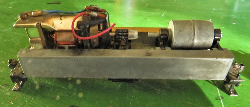

This is not so much a customization nor kitbash, but a set of repairs that reek of home talent. The MDC Boxcab is a nice locomotive in some ways, but it's not bulletproof. In short, some things just don't hold up. So far as I know, parts are not all that available, so the high art of jury rigging is needed.
I had one boxcab that worked quite well and got another at a bargain price, but it was not such a bargain. It lacked power and the motor overheated. At the time, I didn't know what that was about, and the engine languished on the sidelines. Later I found out that those symptoms mean a weak magnet. By that time, I also knew that you could get rare earth magnets in a variety of shapes and sizes. The picture below shows the motor with new magnets and a new lease on life:
Also, there was a flexible tube connecting the motor shaft to the flywheel, but it was inefficient enough that there was really no flywheel action. I took the tube off, and that let the gear walk off the end of the shaft, so I put just a short piece of tube on to hold the gear.

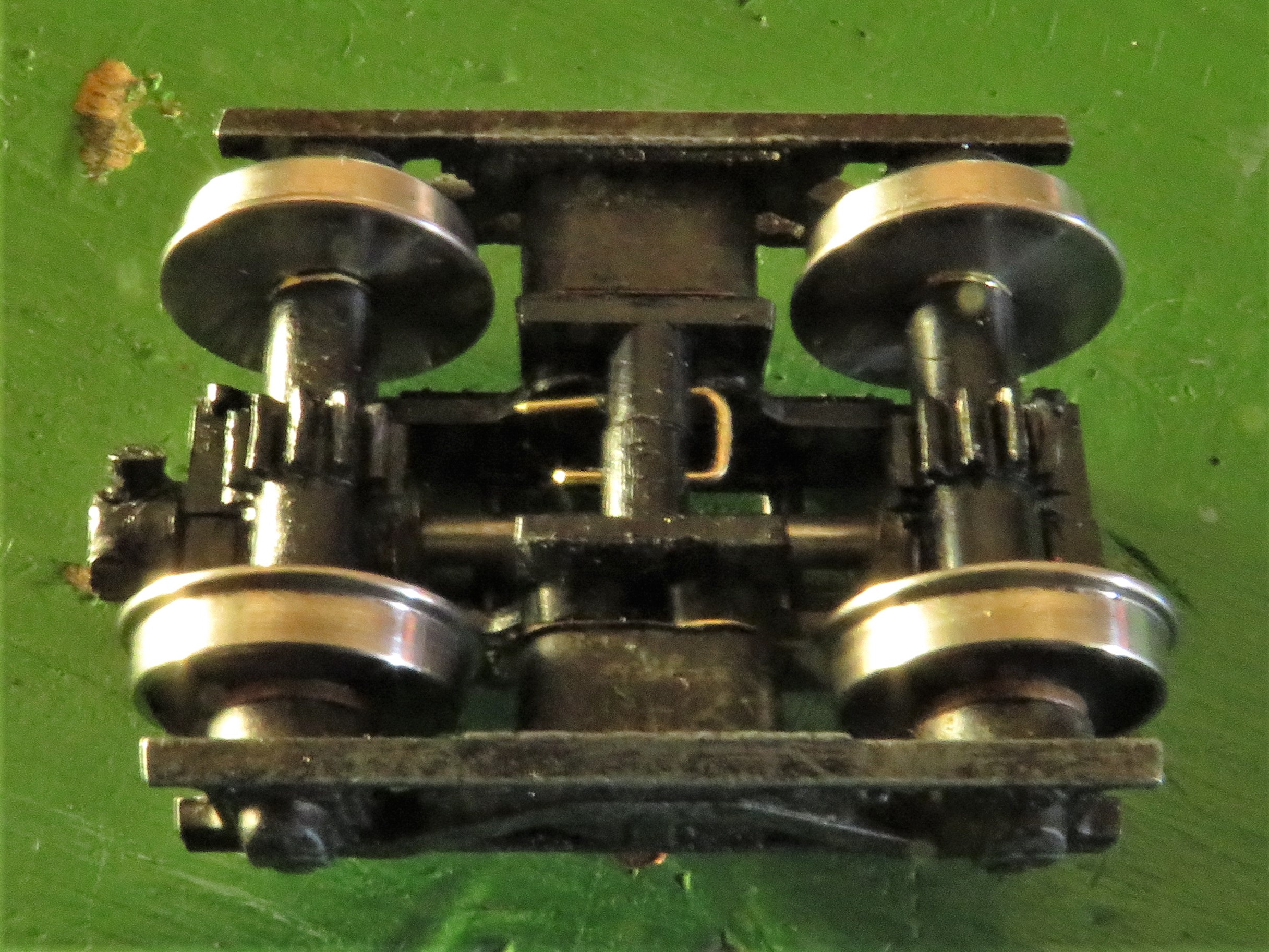

On the bottom of each truck is a snap on cover that covers the gears and keeps the bottom of the truck from spreading open:
One of those broke as you see here:
You can't really glue delrin, and the part's hard to replace, so once again, the engine was sidelined intil it occurred to me that there was probably another way to hold the truck together and the snap on the other side would hold the cover on.
There's a pair of posts that touch end to end and space the halves of the truck correctly. Here you can see them spread apart:
I brainstormed a number of ways to hold those posts together and settled on this wire staple through holes drilled in the two posts. The cover snaps on over the whole works and the remaining snap on one side holds it in place.
