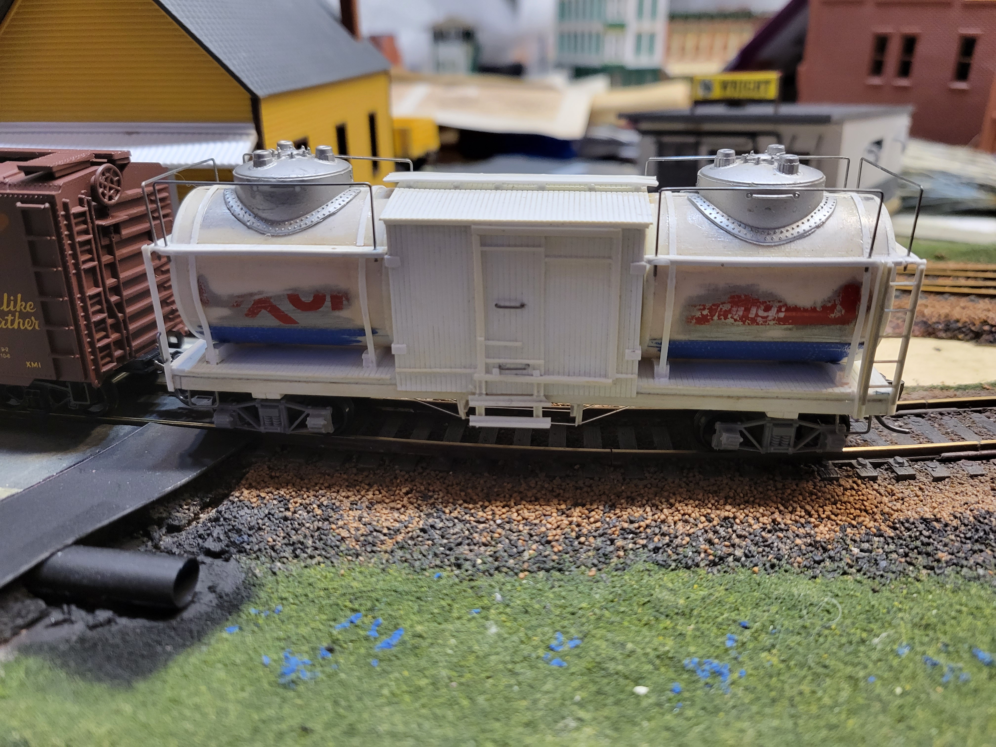

I've made several boxcars, flats and tank cars from cardboard and strip wood. The latest was this wood vinegar tank car made from a creamsicle box. Although most of my collection is conventional plastic models, I do enjoy the look of these made-from-scratch models.
Cardboard is an interesting and easy material to work with. The main thing is to use fresh brand new Xacto blades. I like the thought process of figuring out all the pieces that I need to make things like angle braces and such. And I do seal the cardboard with acrylic varnish before I paint it.

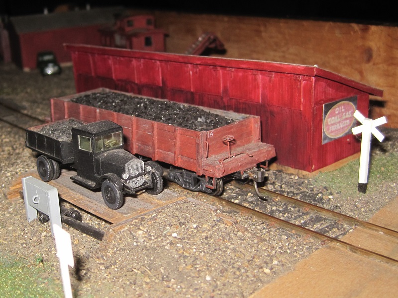

I've used some old-school materials and techniques. Mostly that means wood and cardboard. I haven't experimented with tin plated steel.
In this shot the brick factory building is a plastic kit, but the shed with the loading dock and the coal silo are a scratch builds. On the shed with the loading dock, the wall is sheet balsa embossed with the siding texture. The concrete parts are the cardboard backing from a pad of paper. Roof vents are air gun pellets. The stone wall below the loading dock is embossed Styrofoam from a meat tray. That's not an old-school material, but it's definitely old-school thinking.
The coal silo is a cardboard tube wrapped in cardboard with the staves embossed in it. The bands are file folder cardboard. The head house siding is cardboard embossed to look like planks. The corrugated roofing is heavy paper embossed on the corrugated roof of a plastic model (attribute the idea to E.L. Moore).
Here's a little pump house for unloading tank cars. It's a cardboard structure sided and roofed with corrugated siding embossed in paper. The tray in front is pop can aluminum painted to look rusty. It's meant to serve as a drip pan in the tracks when the tank is being unloaded.
I wanted a feed mill on the layout and it needed to fit a small space. In Chadwick, IL, there's a mill the right size, and I built something a lot like it out of cardboard backing from note pads. It's natural color forms the concrete foundation. A layer of file folder cardboard embossed like planks and painted to match the grain elevator forms the siding. The roof is more of my corrugated paper. The ventilator on top is a leftover one from the Walthers grain elevator kit and the stove pipe is probably a plastic sucker stick or something similar. Windows are clear plastic with paper frames and muntins glued on.
This is my rebellion against checkbook modeling. Right after I read a layout article in which everything was some brand name of glue or sidewalk sections or whatever that left me wondering what brand of air the author was breathing, I went to build a coal shed at my bulk fuel plant. I set myself the goal of making it all out of scraps and junk. Accessories like the conveyer and the truck are store-bought but the building is all old cardboard and paper. Only the paint and glue were not scraps. The coal was even pulverized from a lump I found in a river that erodes through a coal seam. Seriously, if someone has fun modeling with a whole catalog of brand names and specialties, more power to him, but I have other ideas for myself.
The gondola in front of the coal shed is an MDC/Roundhouse diecast boxcar floor with a body built around it out of 1/32 inch sheet balsa cut into planks.
Ashes from the locomotives are loaded into small, low gondola cars with this old diecast conveyor, but the hand cart that moves the ashes from the pile to the conveyor is partially scratch built. The wheels are some that I found at a swap meet, but the rest is built up of file folder cardboard and bits of wire. The ash is ash from a locomotive sifted for scale-sized cinders. The scoop shovel is shaped from a thin sheet of copper soldered to a wire handle and painted in genuine shovel colors.
Don't overlook the simple builds. This tool rack is a match stick across two toothpicks with wire hooks stuck in it. The tools are made of copper wire and thin sheets of copper.

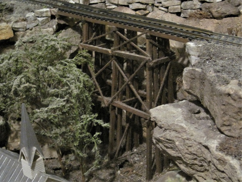

Long ago, I had some big packages of 1/4" square and 1/16" square balsa strips and used them to build wood trestles.
Those old-school modeling techniques you've been reading about are still a great source of modeling fun, today.
