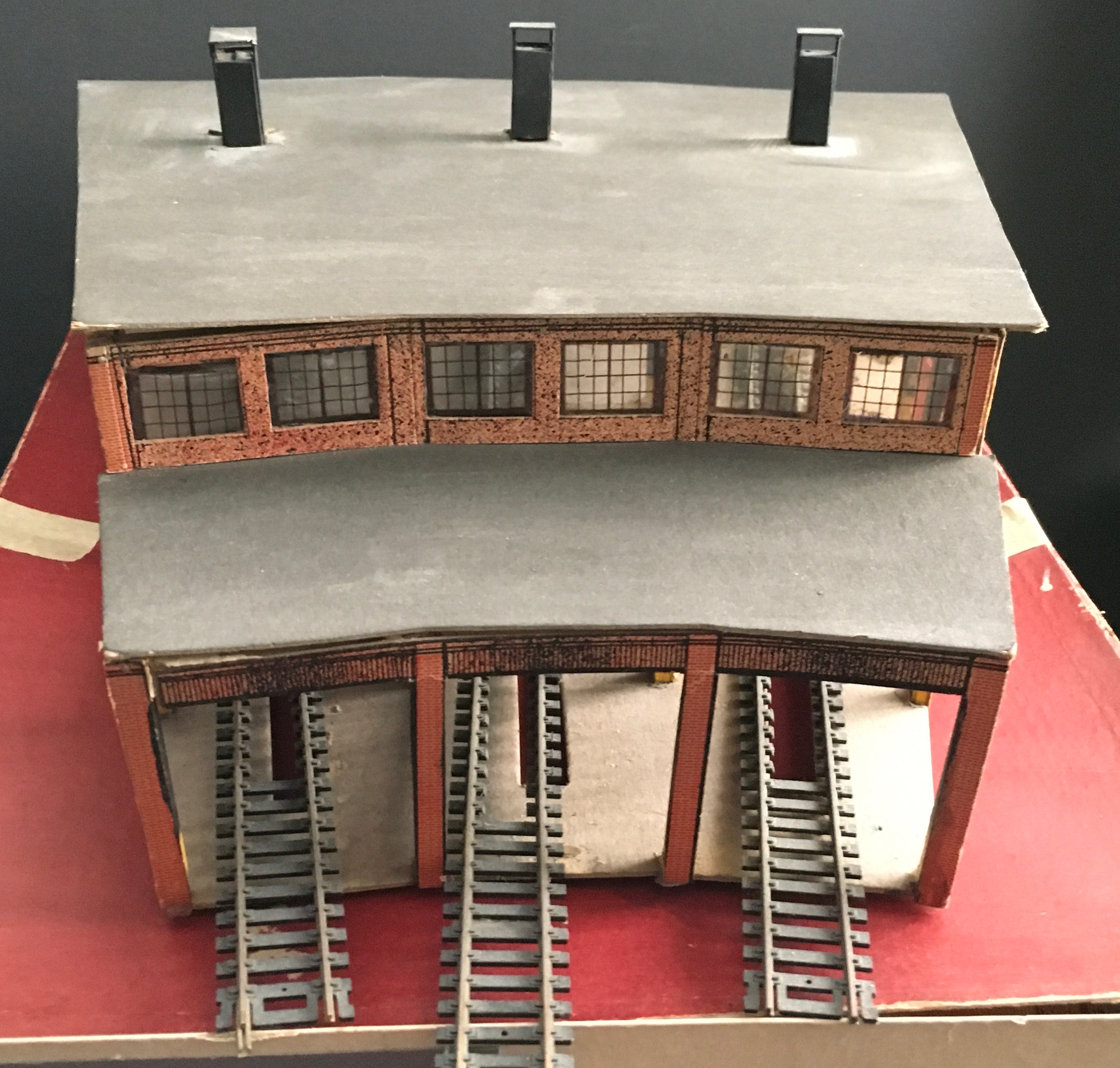

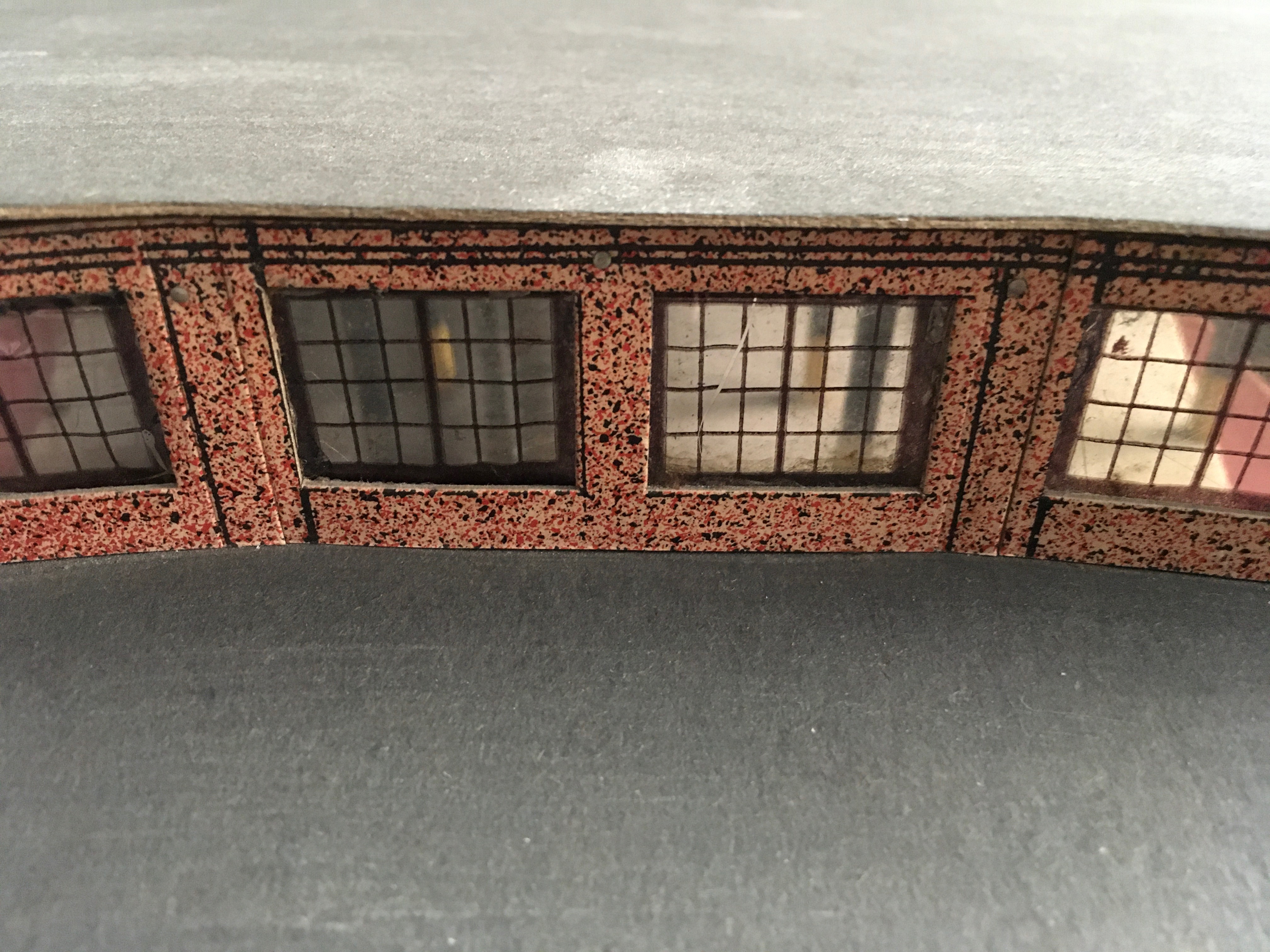

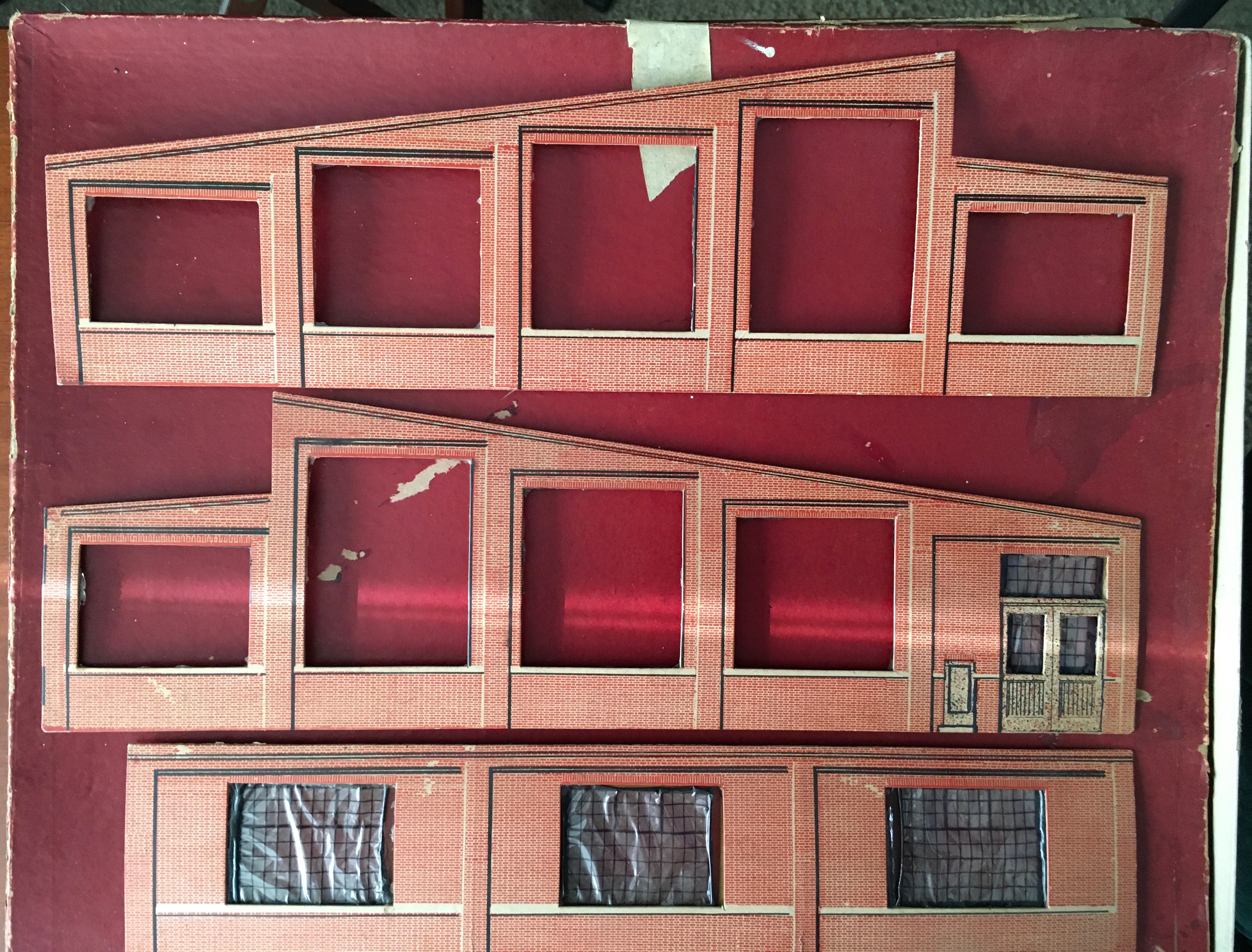

I am in the process of restoring a roundhouse made by The Ideal Aeroplane & Supply Company ca. 1939. It's an old paper and wood kit and in pretty good condition ... for it''s age. My issue is the acetate window glass used in the kit. A few are torn and some are shriveled as if they came to close to a heat source. They all have printed grids to simulate the old steel framework of windows from that era.
Question #1: Does anyone know how to restore acetate?
Question #2: What is the best way to print the gridwork on styrene? I have paper thin clear styrene that will go through a printer but ink smear is the problem.

DaCheez: Both. The ink doesn't dry fast enough on the styrene.

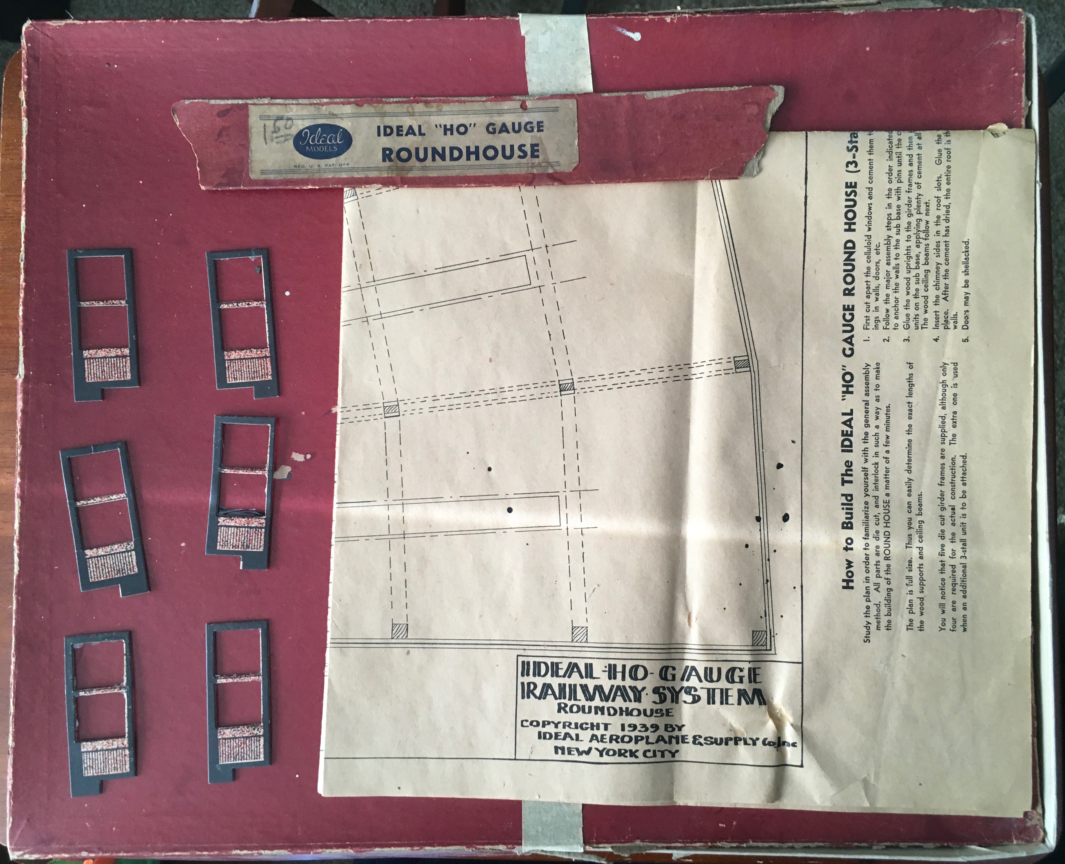

Chops: There isn't much to see as it is partially disassembled. I have been working on some paper restoration techniques which takes a long time and I have never done this type of work before. But here is what I have.
Original box and instructions ( Box needs restoration, too ).
Both sides and back walls. This shows the distortion of the glass.
Front view. Front left is the most damaged part of the structure.
Close-up of clerestory wall and windows.

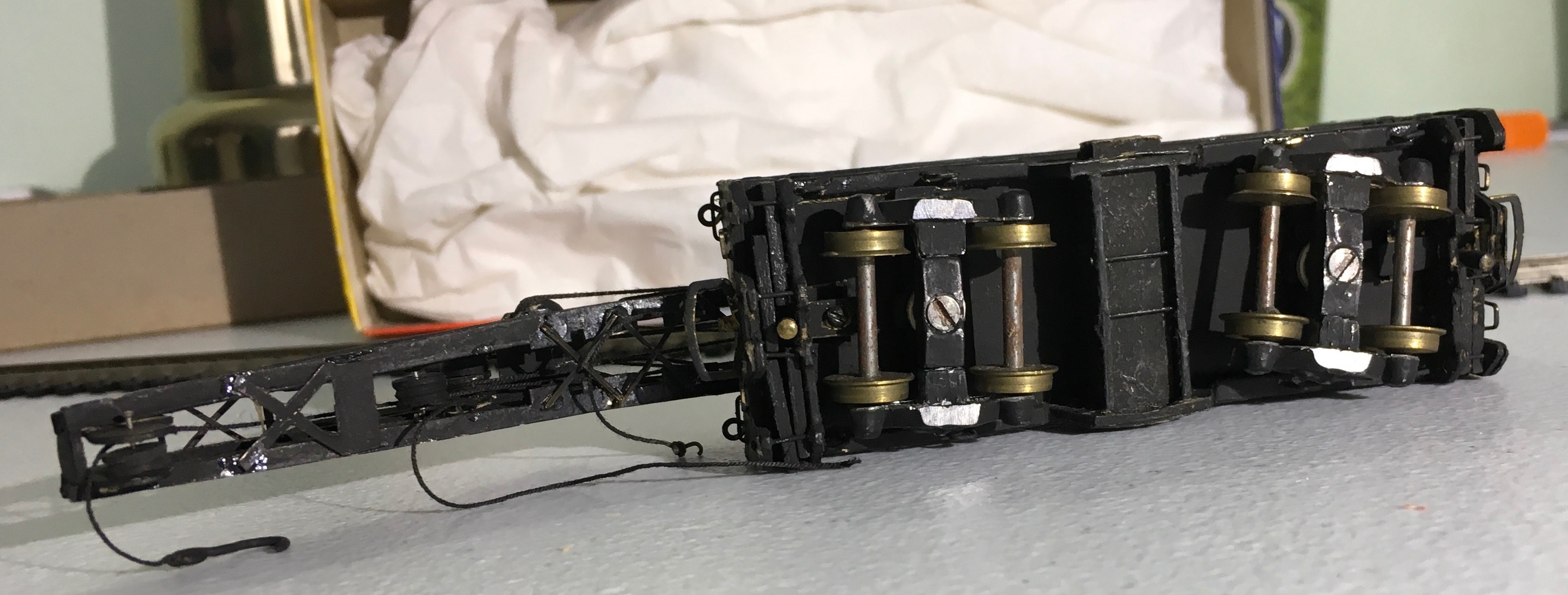

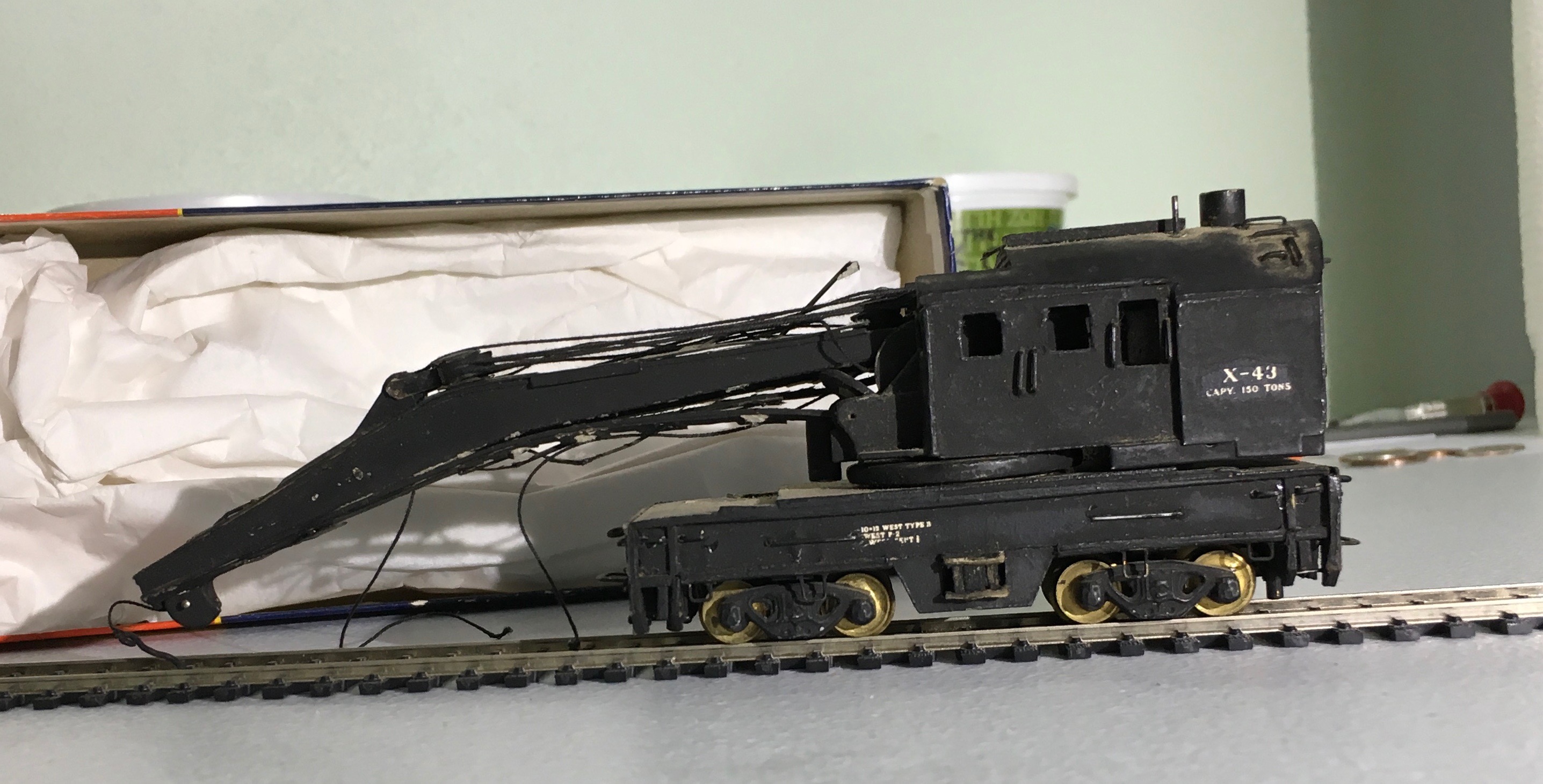

Chops: Is it that you have never seen this particular kit or not heard of Ideal Aeroplane & Supply. Here is another Ideal paper and wood item that is waiting for restoration.
Even the pulleys are paper.

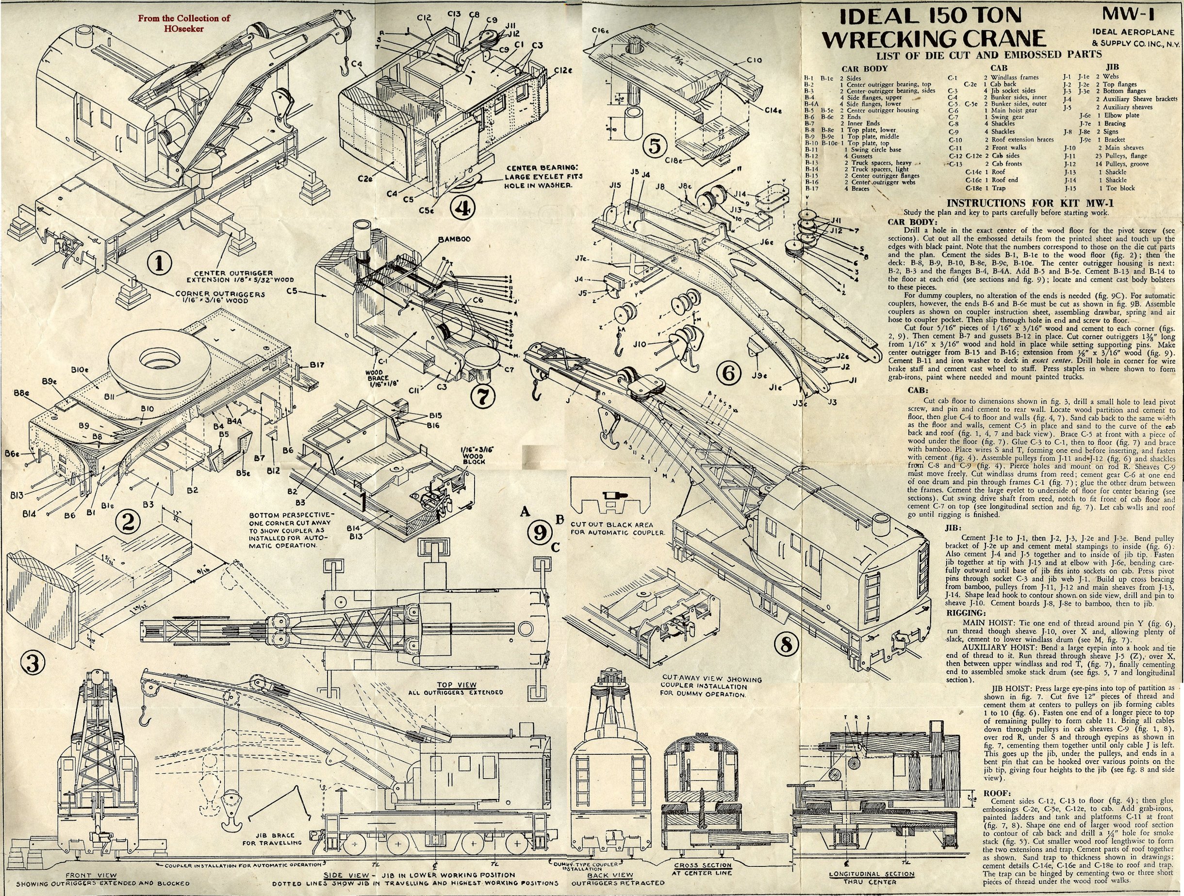

I forgot to post the assembly instructions. I did not have these so this is from HOSeeker.
