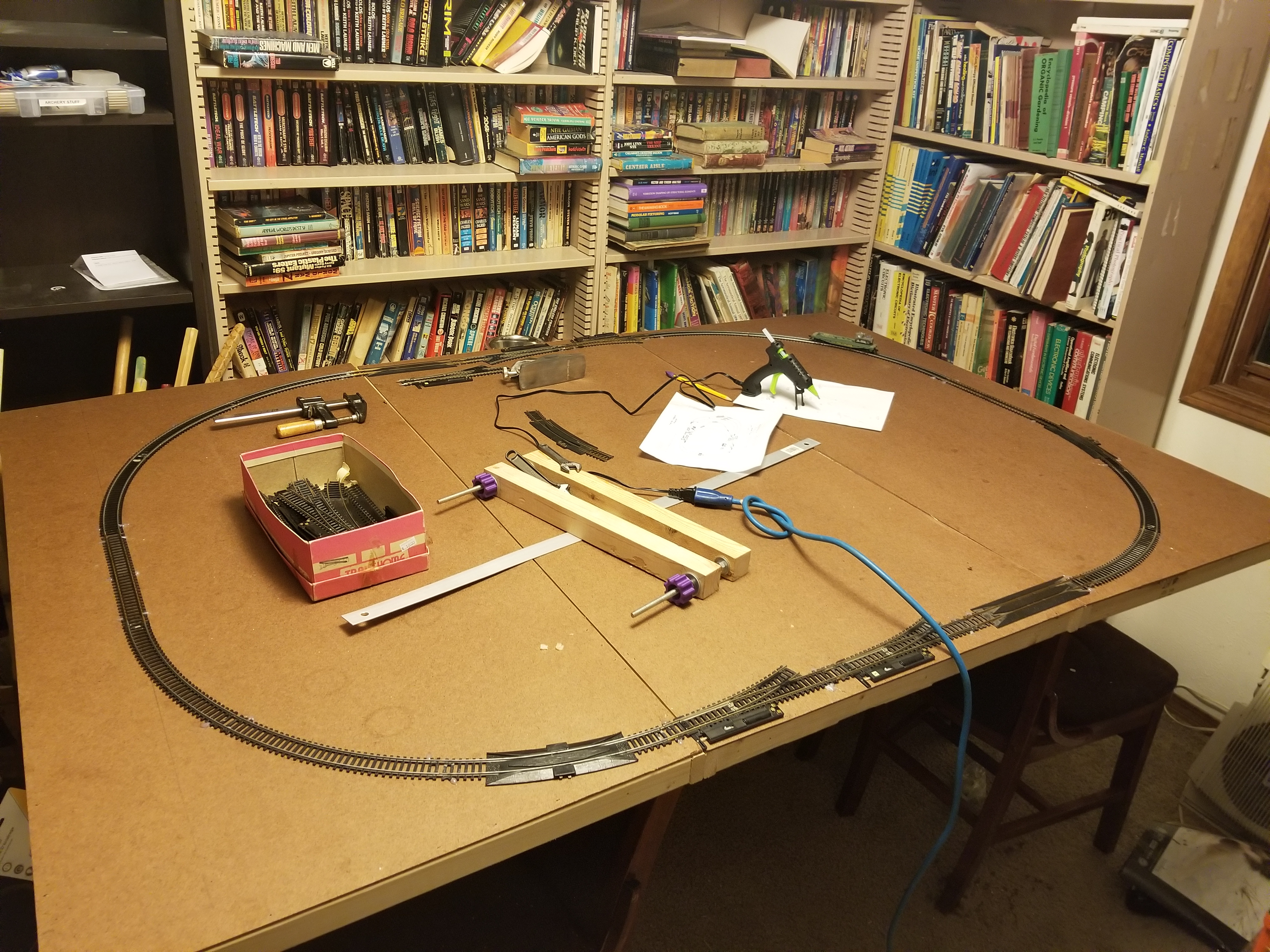

I am in the process of setting up a table, but it will not be the final table
it might last 1-5 years
what should be the best way to temporarily mount the track? I was thinking of using hot glue then I can use a hot knife to cut out track that goes bad or if I need to do some modifications like adding a turnout
track I have has evidence of (i think) white glue, other no indications of mounting evidence
once I get the track on loose, i was thinking of a few dots of hot glue on the outside edge of the ties to keep track from wiggling loose.

this went together faster than I thought
maybe just duct tape to start? better than hot glue
 Country: USA  ~  Posts: 172  ~  Member Since: October 09 2020  ~  Last Visit: November 28 2026 Alert Moderator  Go To Top Of Page
tater1337
RoboAvatar
 Posted - October 21 2020 :  2:07:24 PM Link directly to this reply  Show Profile  Add tater1337 to Buddylist
wow perspective skewed that a lot, its a 6x4, looks like 8x4

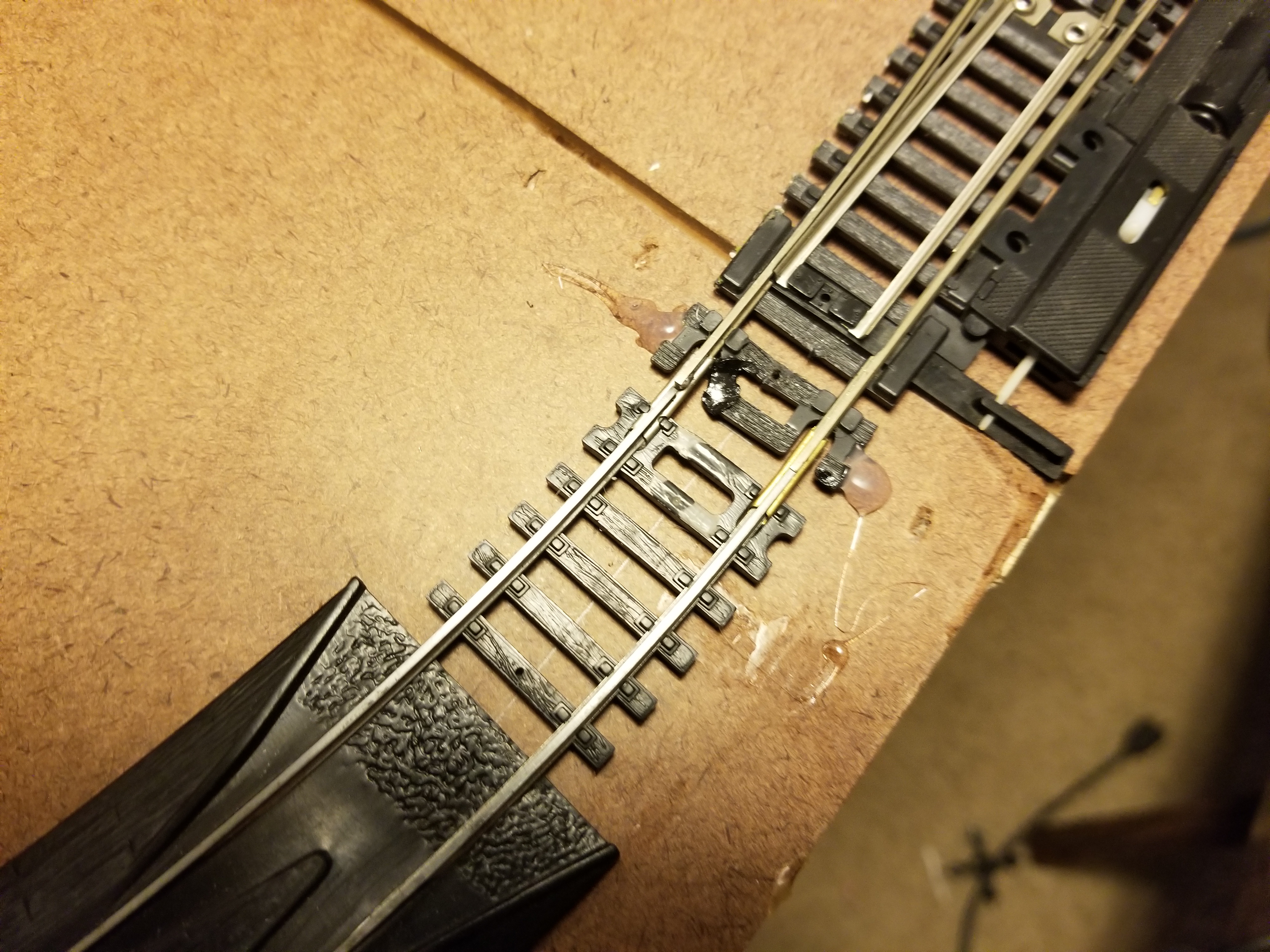

TOO LATE!!! (the tractor flatbed GLIDES across most of it)
details (I did not melt that tie, that was someone's thumb-fingered attempt to solder rail joiners)
I gotta pull up about 7 sections and do it over as I have some gaps like this because I tried to do it the easy way and work from two ends(some heat, a lil exacto knife, and should be good to go)

Modified tyco layout expander setup, FYI
let's see how bad stuff derails

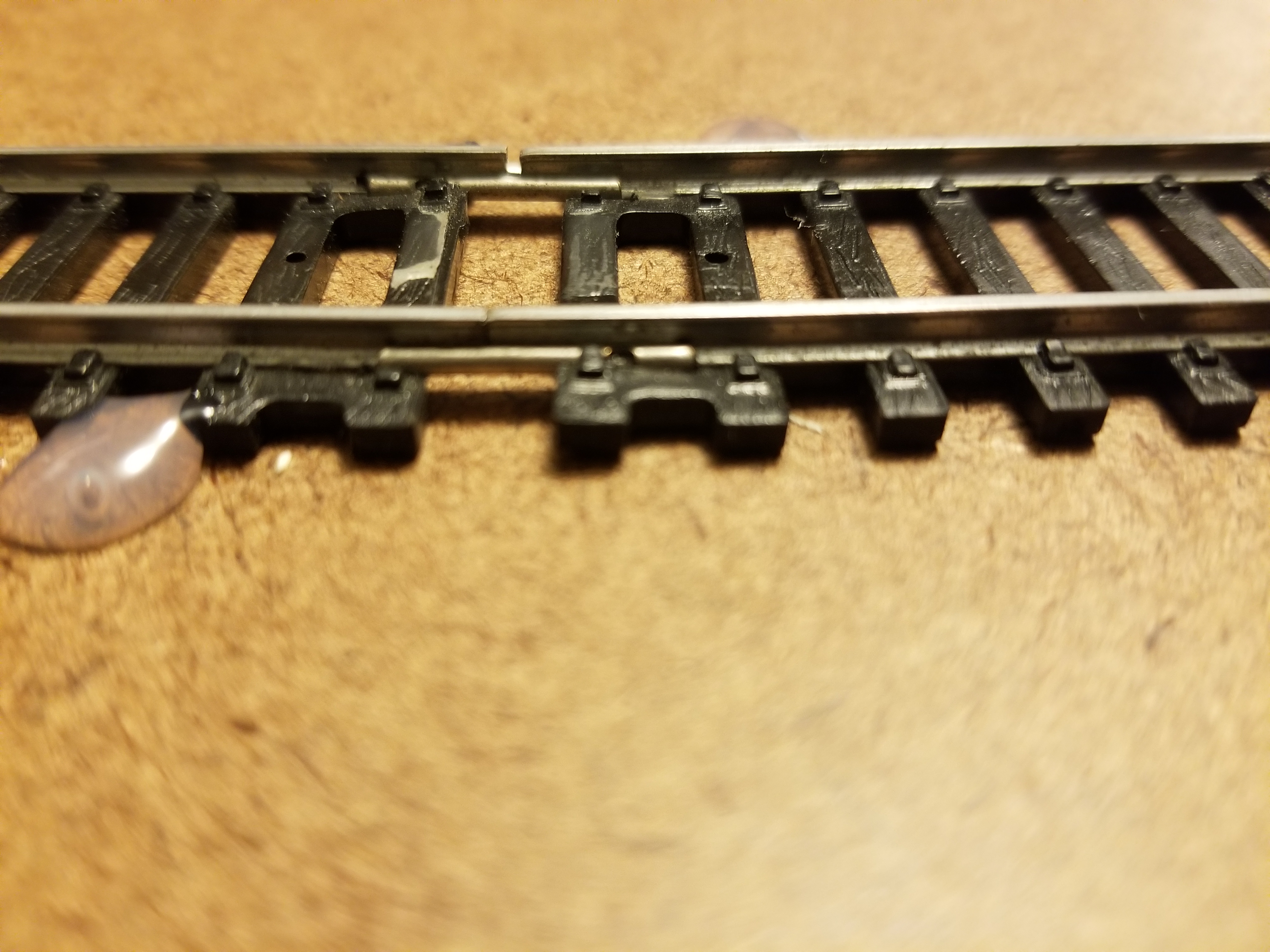

wow, clicking on the pictures REALLY shows flaws.
I'll have to take pics of all the track joints and blow them up to analyze
luckily I am NOT thumb fingered at solder joints (HAM operator) and should be able to touch up uneven ones like the gappy one I show, then buff it down with my diamond lapping plate (for sharpening that block plane in the 1st pic, woodworking hobby) and REALLY get things to glide

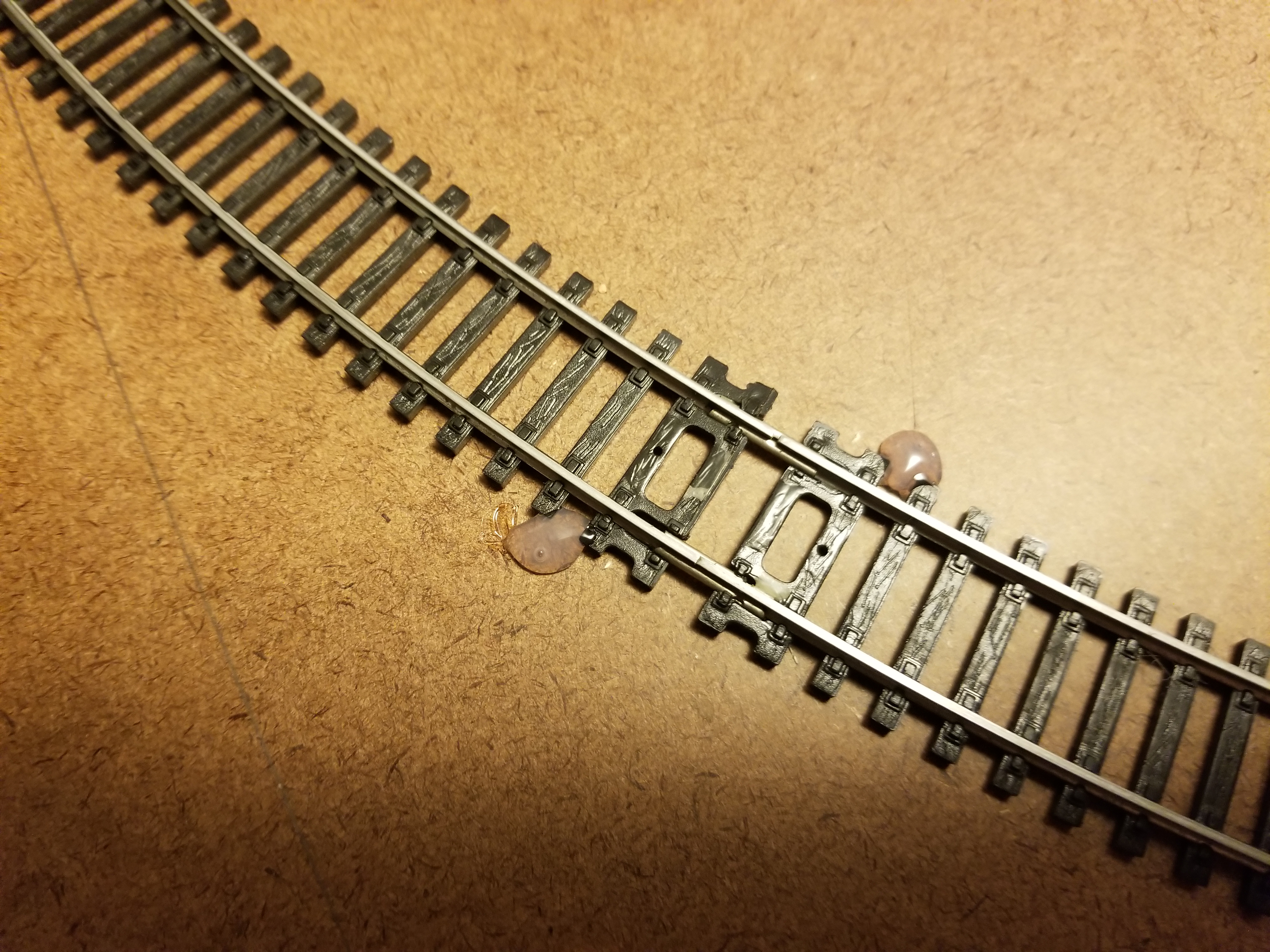

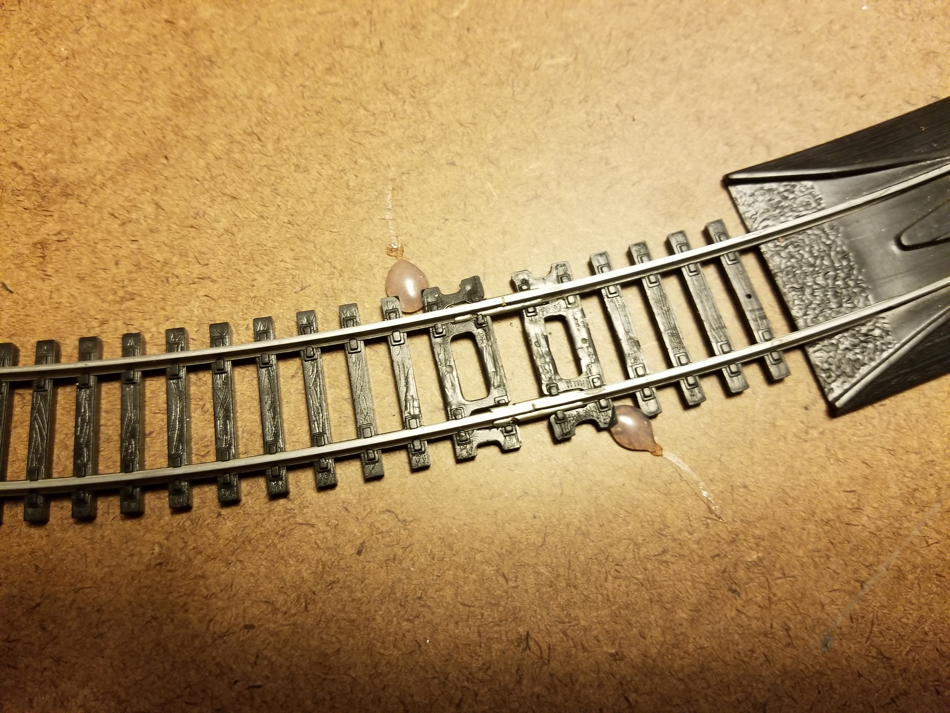

testing of removal and comparison of actual vs measured centerlines
a sharpened putty knife work great for removal, better than exacto
hot glue looks to work well
will have to keep it on for a few months to see what long term issues are
I have a hunch that I am going to end up chasing the track in circles trying to get a .128" gap to close tho
not worried
layout error is across six of 18"R and three straight 9" sections (half an oval)
