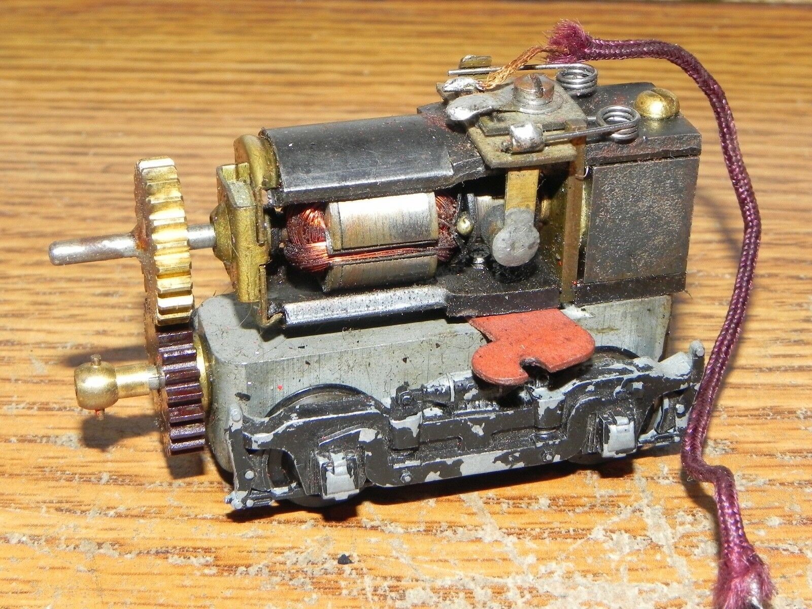

I have seen that type of motor in Life-Like Diesels, in fact three of my locos have it, although in all these it is mounted on a bogie directly above a layshaft, which it drives through two huge gears. One of these locos is the Bicentenial F series from 1975. another is my British Rail blue F7. These mechanisms are similar in principle to the original Varney set up, (shown below) but with finer tooth gearing

Looks like a Varney drive which was used in early LifeLike locos

Thanks The Siding,
Yes the image is indeed a Varney, as I didn't have an image of an early LL mech to hand when I posted, but please take a look at the chassis and motor arrangement in the link - Never seen anything like that in the 'flesh'

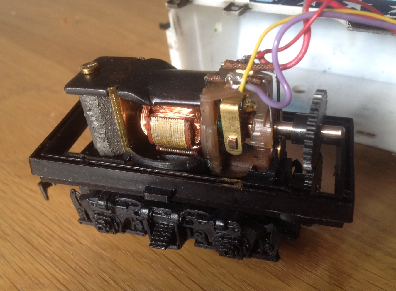

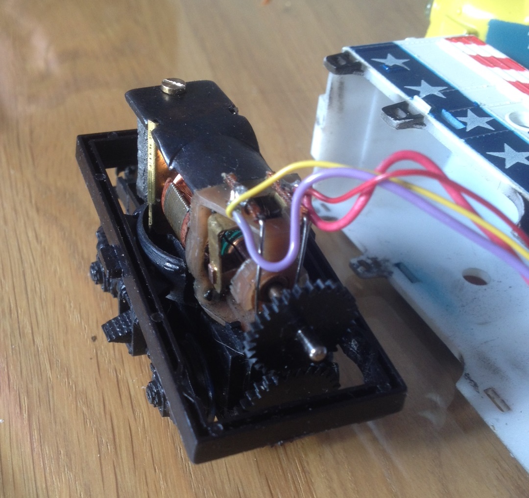

On my similar Life-Like bogies, (see below) of which I now have three, I am finding that the top gear, on the motor is often cracked or missing. My chum checked the gears and both upper and lower shafts with a Micrometer and found that whilst the gears are identical, the motor shaft is three thosandths of an inch larger than the layshaft....Hmm!
Could that be the reason the gears crack and fall off, also allowing thirty to forty years for the stresses caused to take hold?
James

I think Delrin plastic (the material your gears are made from) shrinks over time. Even high end models are prone to having gears crack from time to time. I know for example that the Walthers Proto 2000 line of diesels had a high rate of axle gear cracking just like your old Life-Like. I wonder if Nylon gears would hold up better?
Highwayman97
 Posted - April 23 2019 :  05:16:53 AM Link directly to this reply  Show Profile  Add Highwayman97 to Buddylist
Thanks,
Yes I think that you are right. An engineer chum actually fixed it for me, with parts from a scrapper, but what he found was interesting:
The gears on the motor and the layshaft were the same, but the shafts were different sizes. The motor shaft is a few thou bigger than the layshaft. Guess this was common throughout the range. So motor gears will start to crack over time and then the gears fall off!
His sloution was to ease the hole in the spare gear slightly so that it was still an interference fit, but now with reduced stress. Thus both my 1776 and BR Blue F7s can now take to the tracks and roar again and roar they certainly do!

That power truck is a EMD switcher truck from a Varney SW7. It was a all diecast SW switcher. The truck was never used on a F7.
