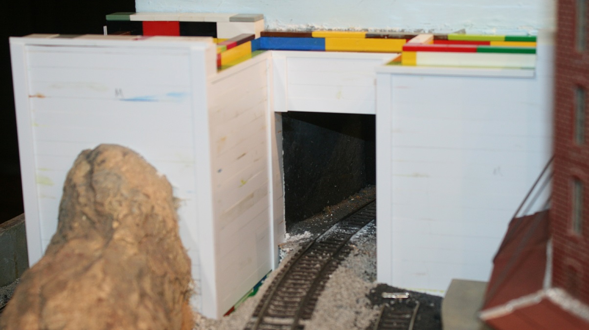

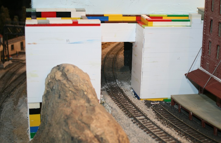

After making some measurements of the space that I was working with on the layout, I initially built my abutments on my work bench...
I would frequently test the fit of the assembly on the layout to make sure the abutments would fit properly...

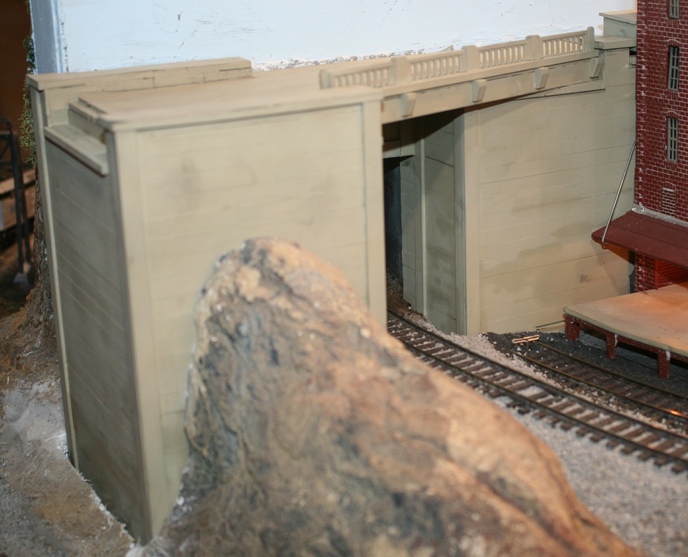

Once I was satisfied that the assembly was shaped properly I glued the Lego bricks together using plastic cement. Then I sheathed the whole assembly with styrene plastic strips to simulate the look of poured concrete...
As the plastic sheathing process progressed I frequently returned to the layout to retest the fit...

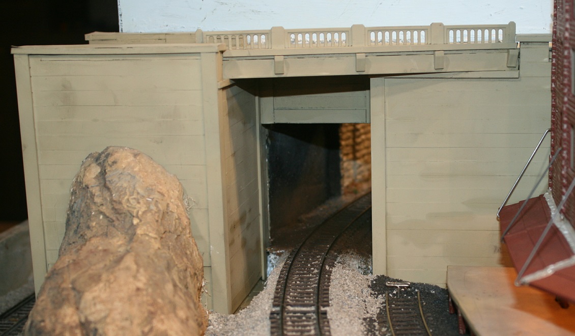

Once the plastic sheathing was complete, I built the bridge spanning the abutments. For this project I used the concrete highway overpass kit Made by Rix...
Lastly, once the whole assembly was put together I painted it with Testors "Weathered Concrete" paint and the gave it a wash of Quick Age weathering solution....

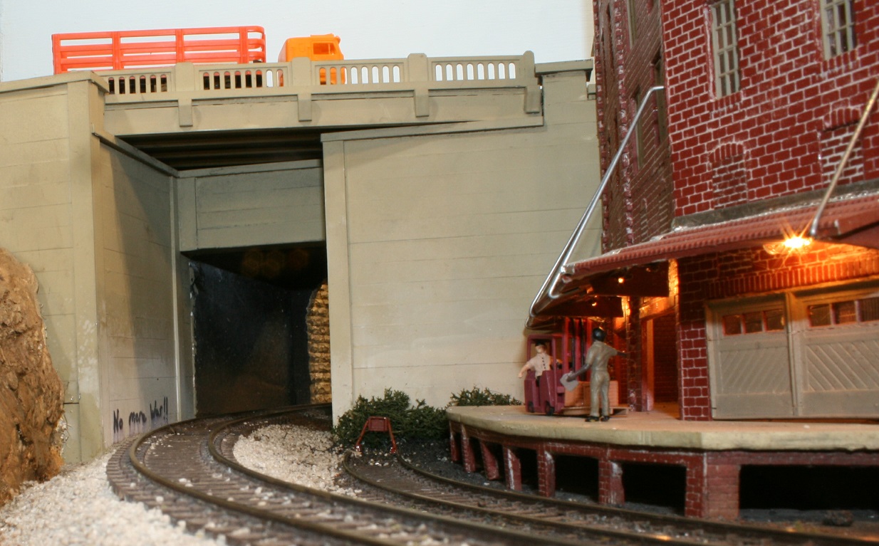

Well I planted the Lego overpass into my layout's landscape, here is how it turned out...
I think it turned out quite well.
