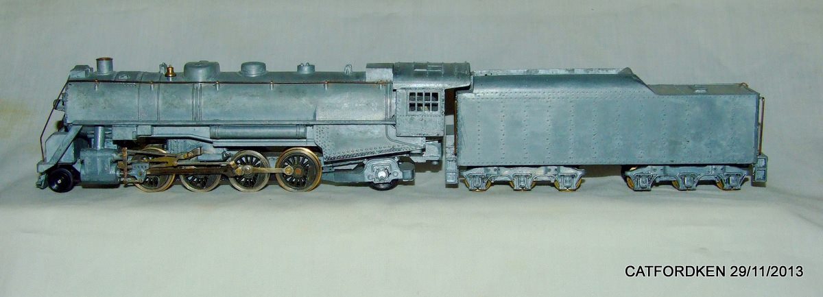

Bought an all metal Mantua 2-8-2 at a local hobby shop this weekend. Going to repaint it and fix it up and put some detail parts on it. When I first tried to get it to run it didn’t run, after I had unhocked the tender I put the wire on the track and it ran fine, which surprised me, I had figured the old motor was long dead. Going to clean the tender contacts and see if that helps.

nice find,but don't forget the boiler door bell,ken

 Posted - November 28 2016 :  3:35:34 PM Link directly to this reply  Show Profile  Add Barry to Buddylist
That will be pretty fine Keith. With those brass wheels, you've got a vintage find. There should also be a felt wick at the front of the armature as well. I'll be looking forward to seeing some photos of this all cleaned up, and maybe a video, hey?

 Posted - November 30 2016 :  08:02:24 AM Link directly to this reply  Show Profile  Send catfordken a Yahoo! Message  Add catfordken to Buddylist
this is the 3rd version of mantua mikado,the bell is on the side,whereas the 1st and second have their bells on the front boiler door,and tender on first 2 have a skeleton frame and 3 rd has 2 coloums for connecting the trucks to,ken
this was made in 1958,yours was between 1952-57
