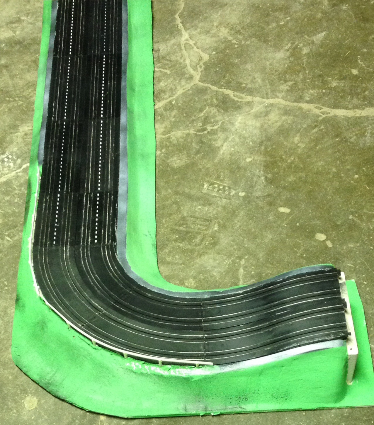

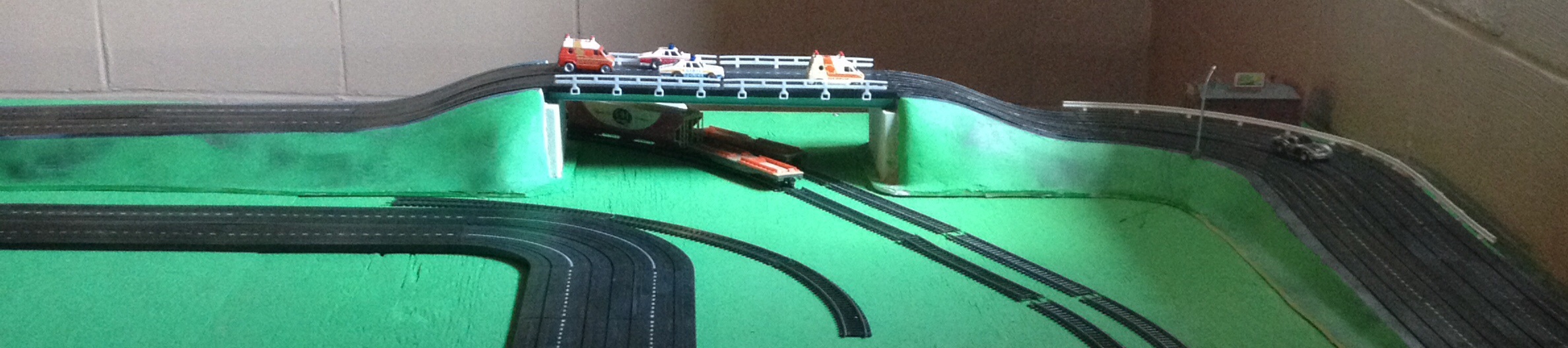

Just wanted to update this thread for new members or visitors reading the thread. The body filler worked well for me and will last forever in a controlled environment. Most work was done in my garage but some in the basement. One time family members noticed the odor but both liked it... A pic or two of the bridge areas made & shaped with body filler. The edges will be molded in later...
Edited by - walt on January 01 2015 12:53:07 AM

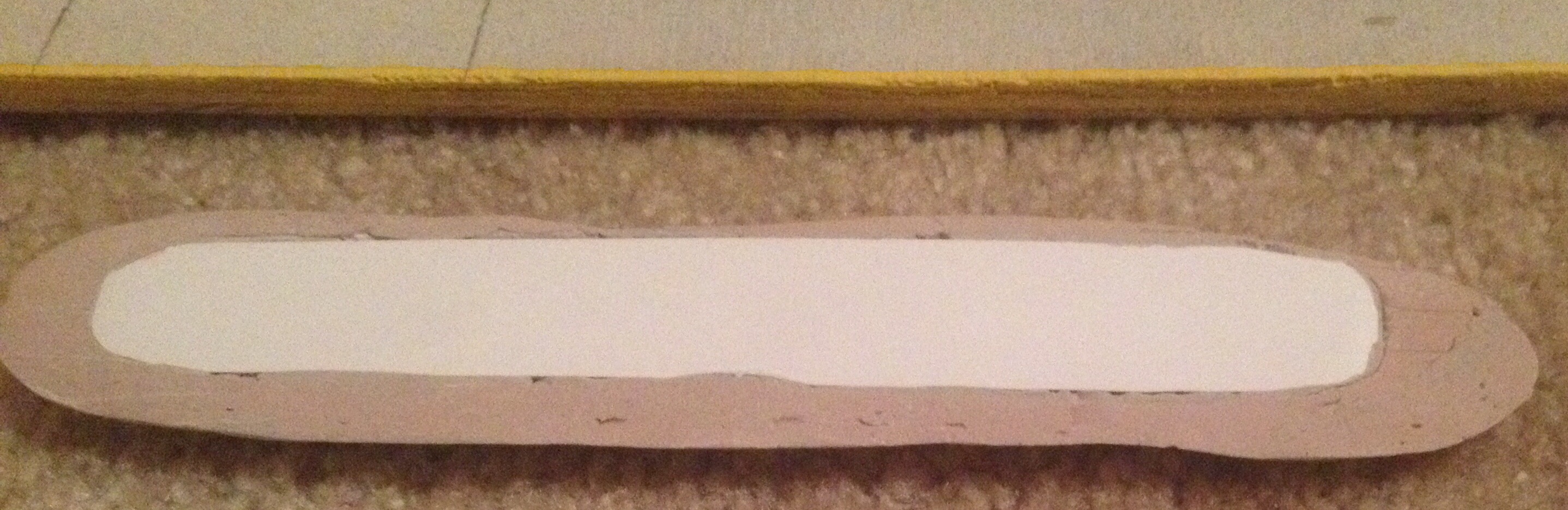

Trying a couple more methods of detailing. The first photo is a patch of land I have cut to fit beside the 7-UP building. Made from 1/4 hard foam board. Trimmed and sloped around the edges a little. Will paint and add scenic grass to the piece and use it somewhere on the layout...

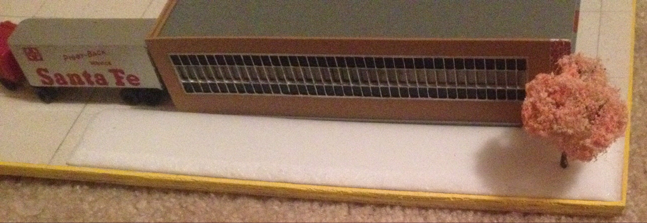

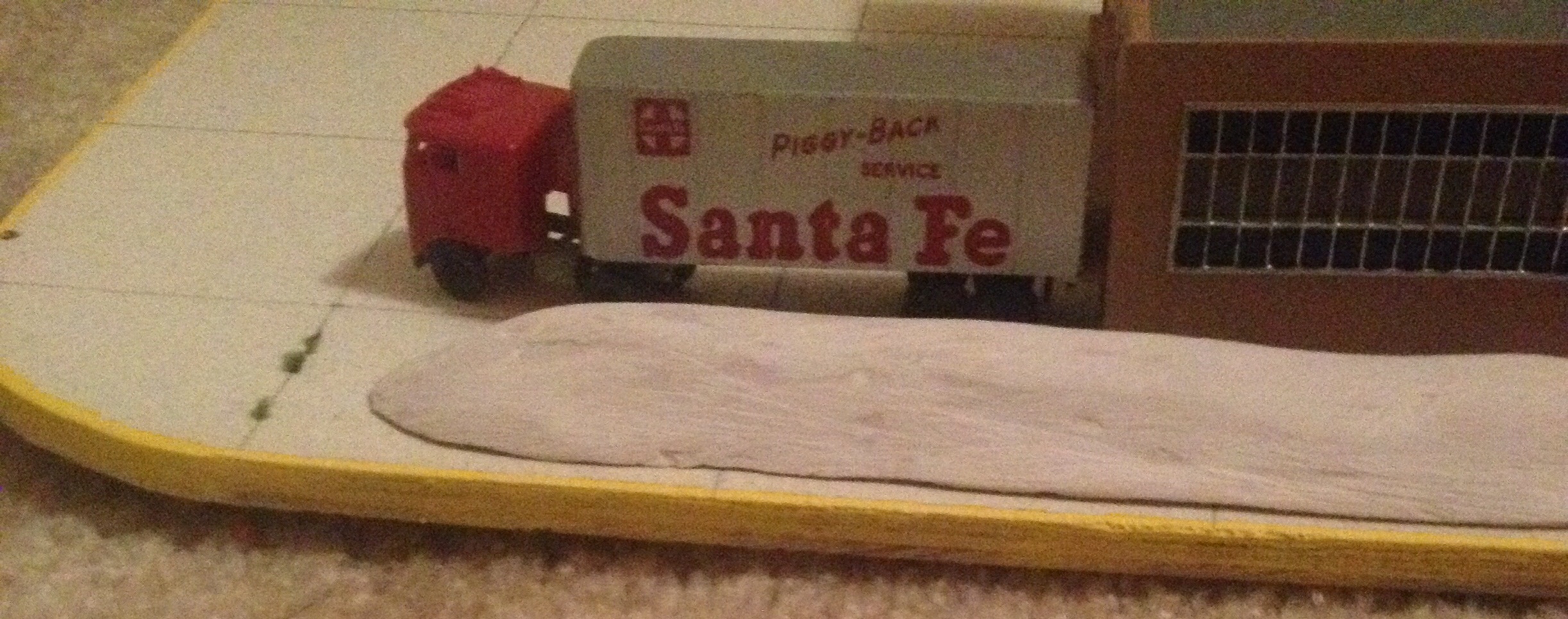

2ND Pic is two pieces of foam stacked like a small mound, the covered with body plastic filler, then shaped some. Left a tiny bit rough for now. Will also paint, apply scenics and use...
3RD pic is the top side of the same piece. I don't think it looks good beside the 7-UP building. Again this small use of body filler was done inside the house, and this time no one in the family mentioned any odor..
