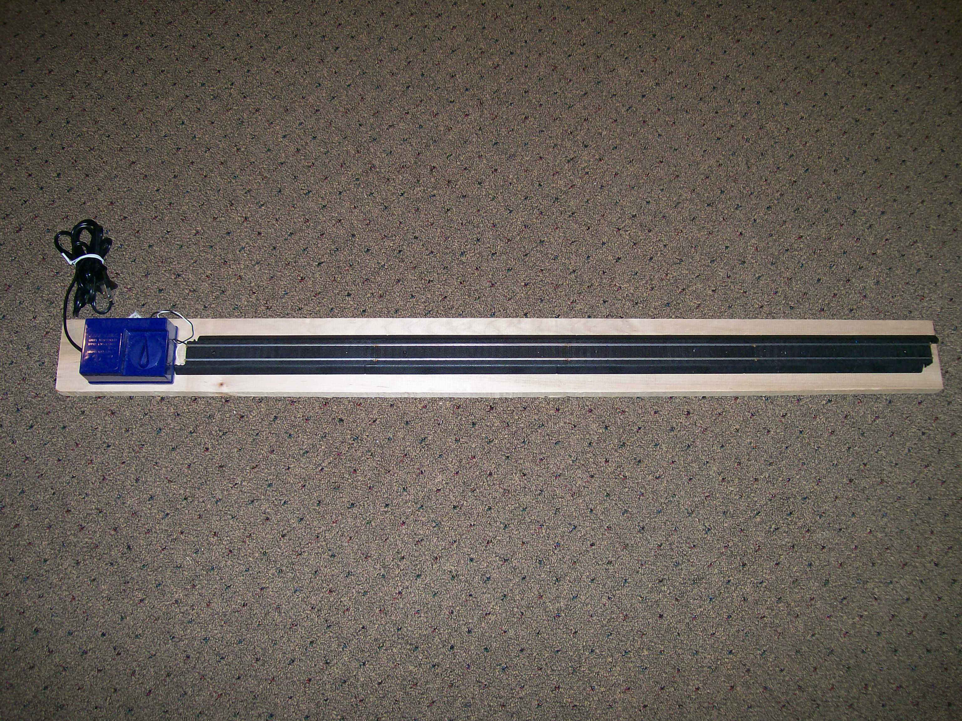

I maded a test track on a board 43" long. I used power-loc track by Life-Like and an old life-like power pack. see pic.
