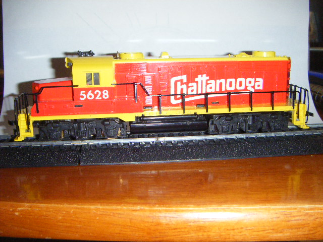

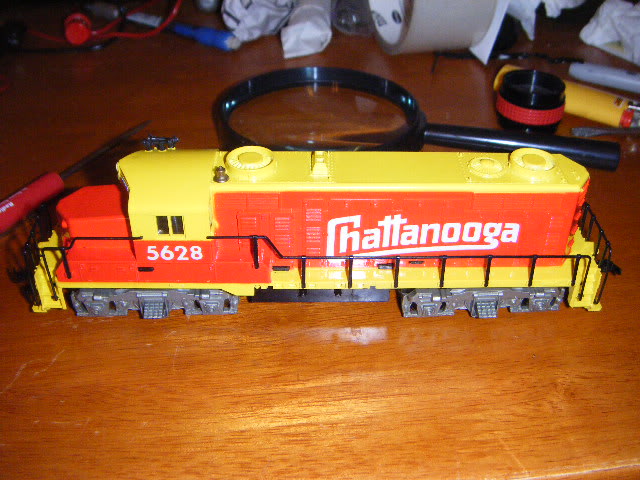

Thanks to you great people on this forum, my boyhood Chattanooga GP20 lives again with a Mantua MU motor. I still need a pair of side frames and I just noticed that the fuel tank pieces are missing from this engine. I wonder what year I took them off and lost them? I also have to repair a coupler, which is OK, I'll just upgrade to knuckles.
There's a train jamboree at the end of the month here. Maybe I'll find a donor engine.

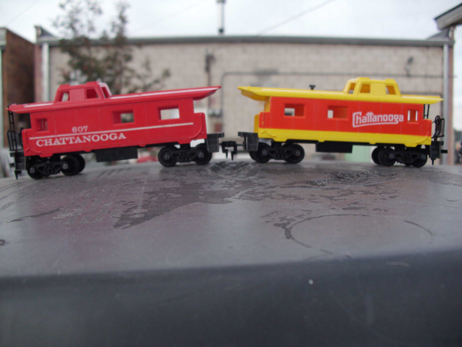

nice loco Have the matching caboose?

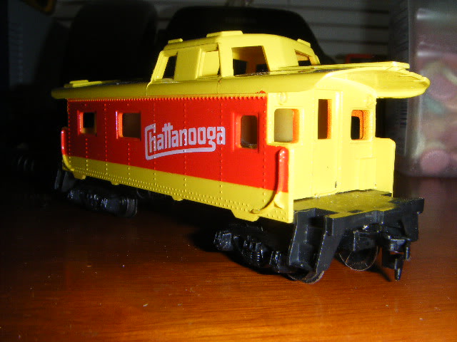

Thanks! Yup, I have the whole set, but the caboose needs one set of railings and ladders. We'll see what I can find at this jamboree.
~ Dave
They're ALL toys
 Posted - January 07 2011 :  10:41:17 AM Link directly to this reply  Show Profile  Add microbusss to Buddylist
nice I got 2 different ones myself
Also lately I been "canabalizing" my Santa Fe cabooses for the end pieces

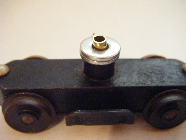

 Posted - February 22 2011 :  4:37:15 PM Link directly to this reply  Show Profile  Add RDC1 to Buddylist

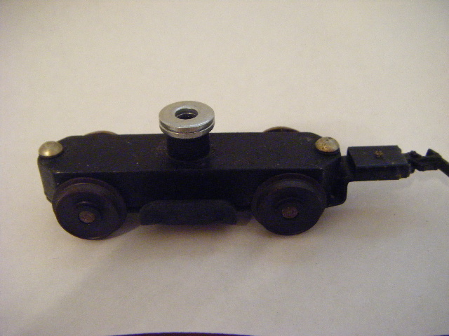

Done, finally. One thing that I didn't count on was the Mantua GP20 rear trucks sit lower in the body than the PowerTorque GP20s. The rear coupler was rubbing on the body and the step plates were just about laying on the tracks. I also had to trim one side tab a little bit for it to snap into the slot.
To raise the body, I used two #6 washers as shims.
Next, to keep the truck centered, I cut a short piece of 1/8" brass tubing to be inserted into the center of the washers. I did file the tubing square and clean, not shown in the photo. I then needed a slightly longer #2 screw.
I got the side frames and fuel tanks from a junk engine at the show a few weeks ago. Now it has that classic Mantua motor sound that I remember! Maybe she'll run for another 34 years!

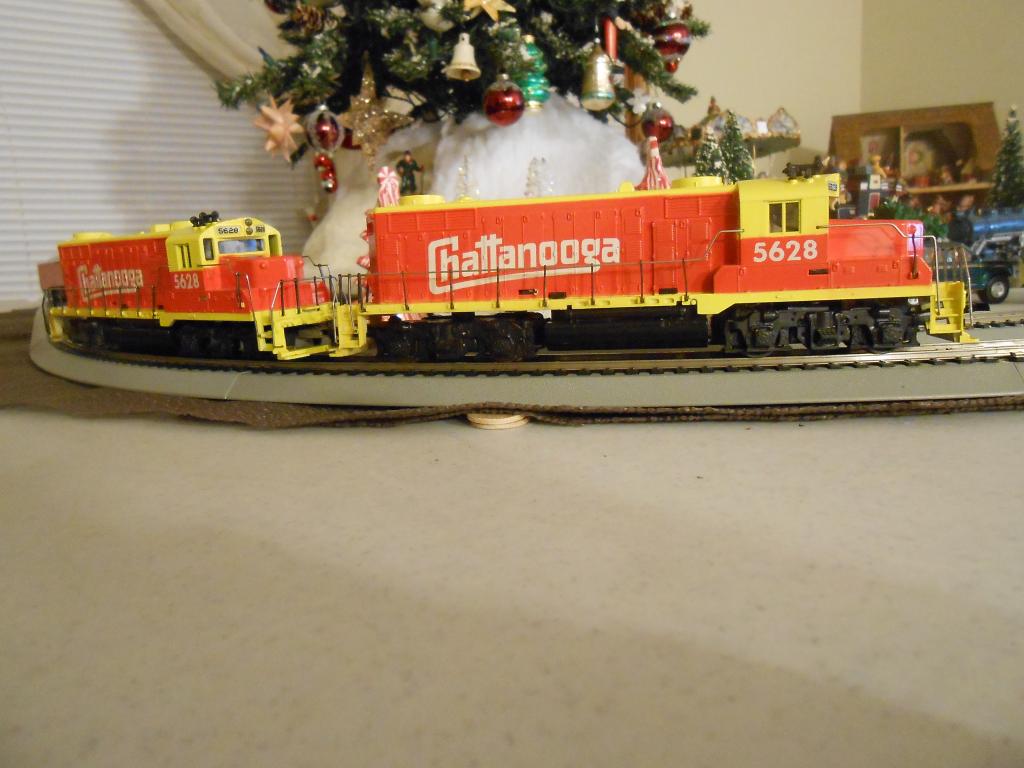

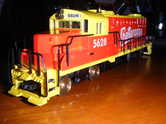

 Posted - December 26 2014 :  7:25:51 PM Link directly to this reply  Show Profile  Add RDC1 to Buddylist
Still working in progress ... metal railings on both engine & dummy, with the exception of the rear of the dummy. It turns out I was short that railing and posts.
Anyone have a spare? If not, I'll have to find another donor engine.
Next, LED lighting.
