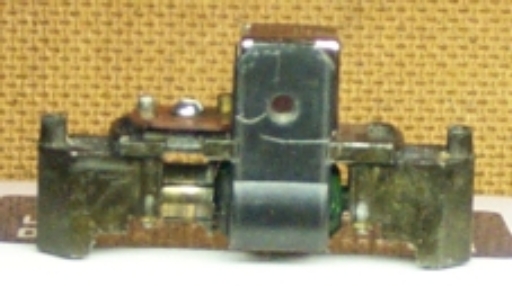

4- Er, I think you may be referring to the MU-2 motor, with the brushes attached to the arms? In that case, I don't know of any replacements, I was referring to the PT motor, the upright type, that has the small flat armature inside with a side plate holding the brushes in. There's no need to replace any arms on those that I know of. Only the MU-2 would need that, and I can't help there. I realize, after researching some of the slot cars, that some have the horizontal armature like the MU-2, so maybe that is what you were talking about. This is a PT, is this the type of Tyco motor you're referring to?

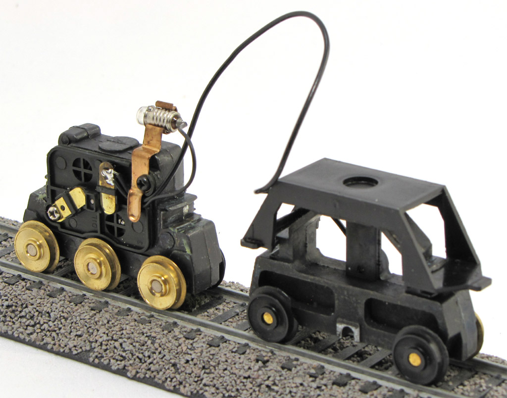

Or, was it number 2, this one? This is the older open-frame type Mantua MU-2 motor.
My chatting about parts has been about the first one, the PT, not the second, the older MU-2 type.

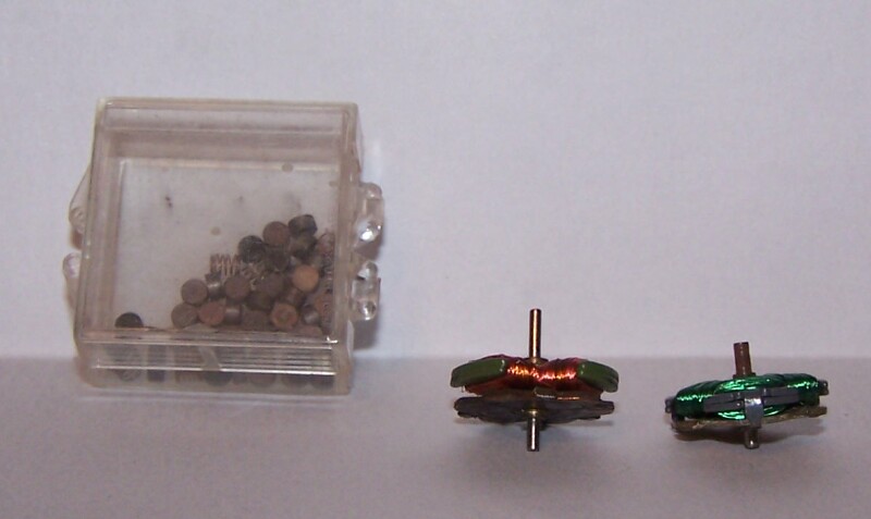

Ok, yes, now it's all making sense. LOL. I mentioned that the armatures in the Tyco PT motor had a longer shaft. Yes, the T-jet armature will FIT into the Tyco engine, but the shaft is too short ( where the small idler gear would fit ), so it won't even protrude enough thru the hole. NOT useable. Fits, yes, usable, no. Which is why I mentioned that you needed to ask the guy IF he could provide a longer shaft ( which will be necessary, no STOCK Slot car armature already made is going to work here, it will have to be custom.)
thanks for the clarification, and make sure you ask about longer shafts. Here's pictures of the PT armature inside a slot car - not gonna work the other way around, though!
As you can see, the Tyco train armature has a much longer shaft than the slot car would have had. Not finding my micrometer handy, it's about 9/16's long with ruler and eyeball.

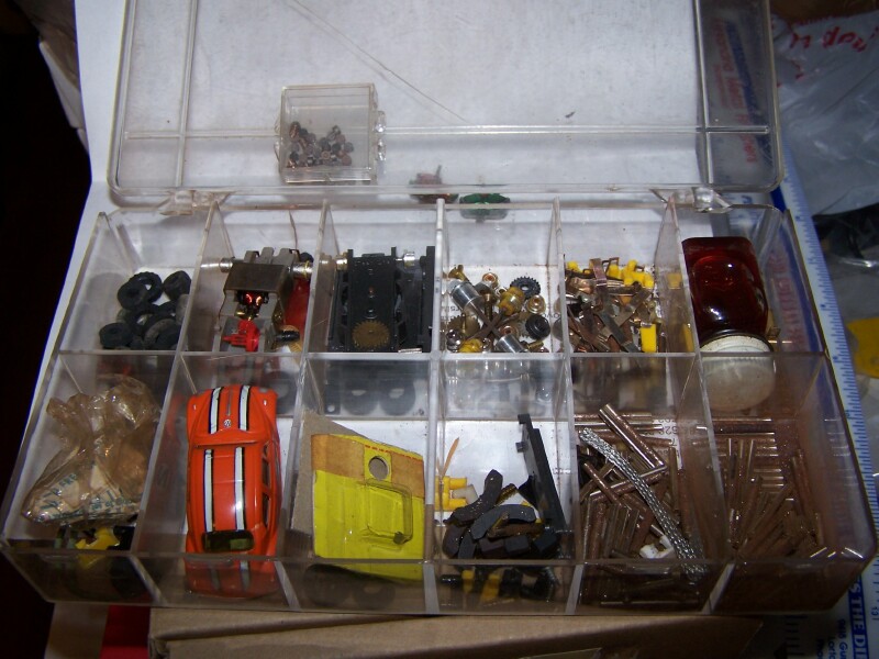

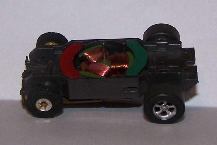

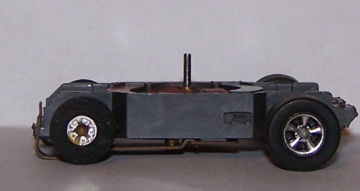

While pushing deeper into my basement's recesses cleaning up and organizing, I came across some of my slot car parts, I think I'd bought this bin off Ebay some years ago. So I am able to grab and photo some of the original type armatures in the older Aurora slot cars. I also found a small bin of the brushes Guess I don't need to buy any for awhile. Anyway, here's a pictorial comparison of the Tyco train armature (left), and the slot car armature (right)
As you can tell, the shaft is both taller, AND skinnier ( didn't realize that at first ). I'll try to find my micrometer Wednesday and measure both armatures for diameter and length.
Here's my bin of Aurora slot car parts. Even have the metal rods and a few of the plastic U pins for the old Aurora Model Motoring track in there, too.
Wonder how much that VW body is worth? I found an Atlas slot car chassis in there as well, with a horizontal armature. Not sure what bodies they had, I'll have to research that, I don't think I have many Atlas HO slot car chassis's.
