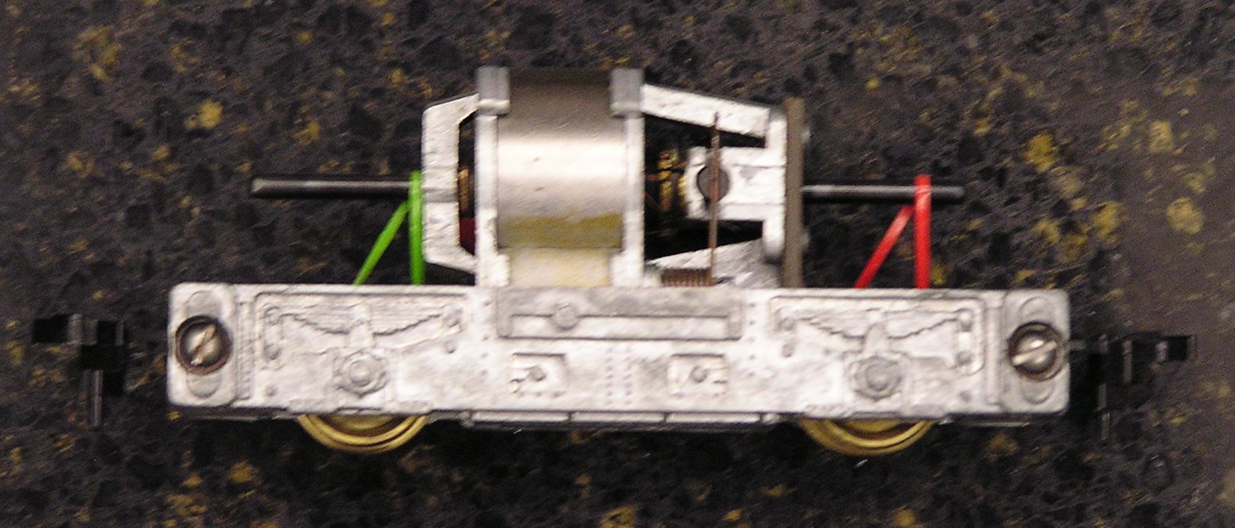

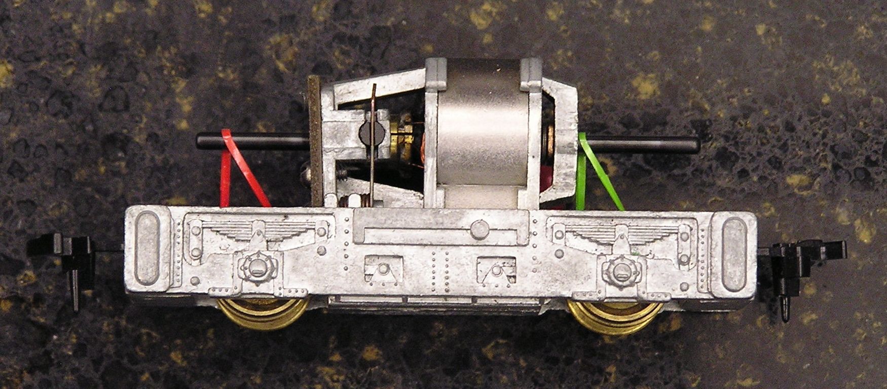

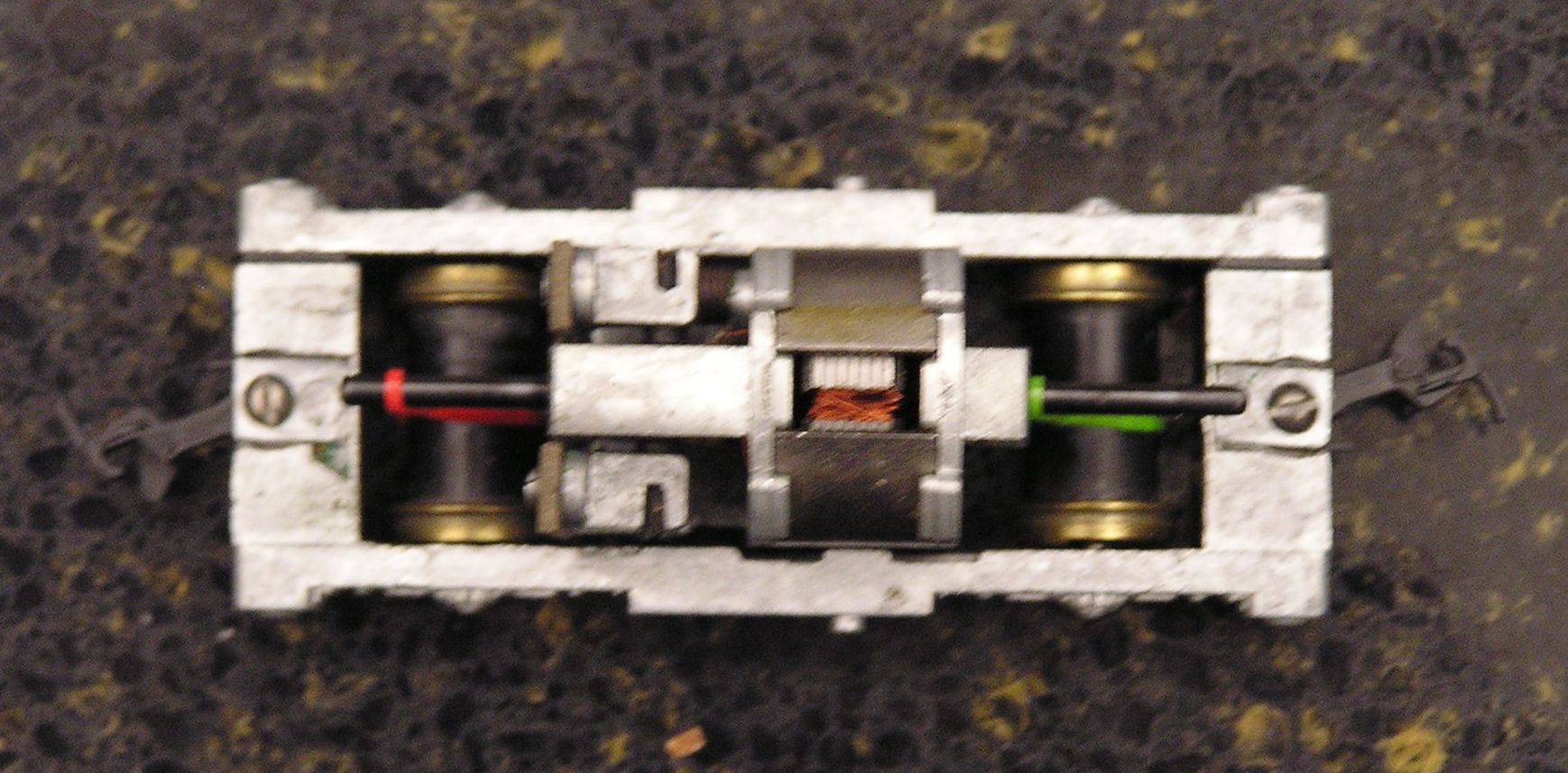

Hello all. I've been working on an Athearn Hustler switcher that my wife had as a kid and after replacing the rubber bands and cleaning it up a bit, I couldn't get it to do anything on the track. Upon closer inspection I could see how the current was supposed to go up through the wheel on one side, into the frame, and then directly into the motor. However, looking at the other side, I didn't see any electrical connection from the wheels and frame to the motor. After looking through these forums for a bit, I added a jumper wire from the frame to the motor and sure enough, it ran! So my question is, how should that other side be connected electrically to the motor? Here are some pics to help out.
Thanks!
Brian

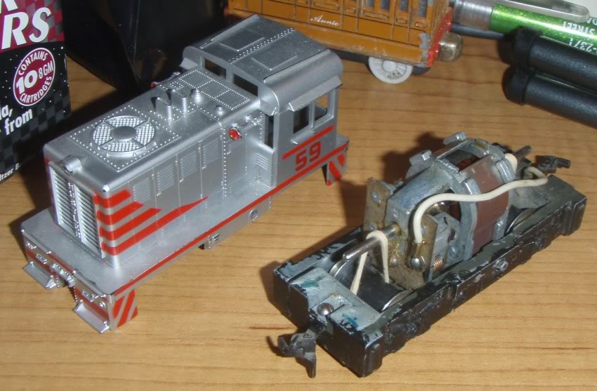

Ok, I was wrong...I was thinking of the non-rubber powered Hustlers having bulbs. Anyway, here's a pic I borrowed off the 'net, showing the wire.
Hope this shows what you need to do, although you've probably already done it.

Thanks for the help. How does it attach to the chassis in the back? I can't tell from the photo.
 Country: USA  ~  Posts: 2  ~  Member Since: December 21 2010  ~  Last Visit: December 24 2010 Alert Moderator  Go To Top Of Page
 Posted - December 22 2010 :  7:52:18 PM Link directly to this reply  Show Profile  Send AMC_Gremlin_GT an AOL message  Send AMC_Gremlin_GT a Yahoo! Message  Add AMC_Gremlin_GT to Buddylist
Originally posted by biker4Christ - December 22 2010 :  7:31:52 PM
I believe it attaches to the screw holding the coupler in place. It's a really tiny ring terminal on the wire.

Its definitely missing the power wire. This is a first generation Hustler. The second generation ones had the metal contact strip. The only lit Hustlers made were the two Athearn created for Lionel. They have a working light on the cab end only. Lionels gear driven carbon copy "Husky" had working lights as well.

Jerry's right...there's a small round terminal end that goes to the coupler screw towards the rear in the picture.
