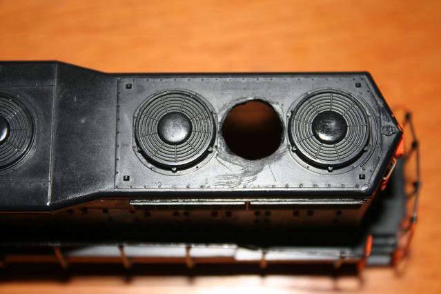

Be adventurous, remove that small fan. The fan above the dynamic brake blister appears to be the wrong size for the loco you want to model. You could replace it with a Cannon&Co. fan.

That does look like the correct part from Walthers. Cannon specializes in EMD GP and SD series locomotives. Since the GP35 was so widely produced you should be able to find all the parts you need.

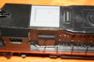

Thanks NC Shortlines. I'll look into that. The small fan has been removed. Great project to work on while the snow keeps falling outside. The snowplows have given up mostly and they are telling people to stay off all roads. With three foot drifts most people can't even get out of their garages or get into their cars if they are unlucky enough to park outside. Anyhow, here's the updated photo.
Too bad I don't have any putty on hand. That will have to wait until everyone digs out from the storm. I live on a snow emergency route so that will be cleared soon but the roads to the hobby shops will probably be bad for a while. <sigh>

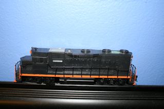

The crews down at the conversion shops have been busy day and night working extra shifts over the holiday on the GP-39 conversion. Happy to report the conversion is done.

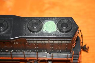

The extra fan hole is all patched up.
A new Inertial Filter Hatch is installed.
She's almost ready to head off to the paint shop for a beautiful coat of cascade green.
The horns still need to be moved but that's about it.
