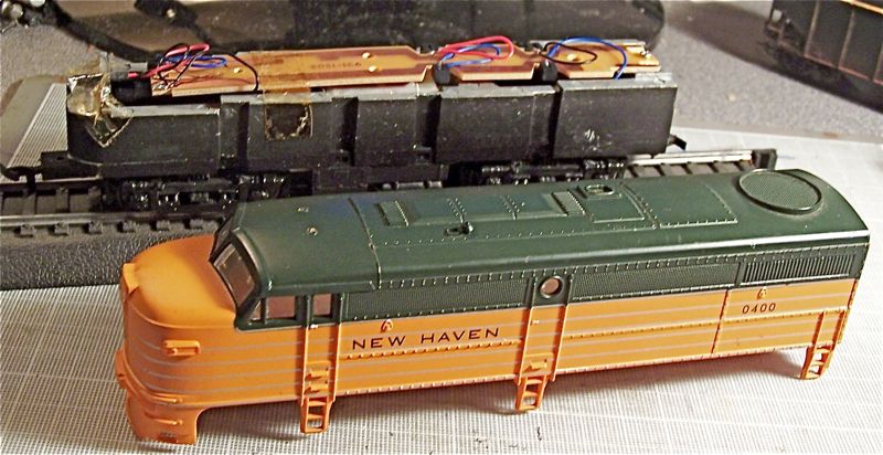

Happily, I picked up this FA (it's not a PA, right? they have longer noses?) for ten bucks at a local antique shop. New Haven only ran this color scheme for about a year. Pretty cool since I focus on New Haven.
Can anyone identify its maker? I can find no markings, though I haven't taken the circuit board off the top yet. I can see a can motor underneath with driveshafts, very vaguely Athearn-like but not like any of the Athearns I have. The chassis is rather heavy. The square structure and tanks on the bottom are plastic and snap on.
Thanks!

 Posted - October 31 2010 :  5:33:21 PM Link directly to this reply  Show Profile  Send catfordken a Yahoo! Message  Add catfordken to Buddylist
looks like a bachmann to me,will check it out ken
 Posted - October 31 2010 :  5:40:16 PM Link directly to this reply  Show Profile  Send catfordken a Yahoo! Message  Add catfordken to Buddylist
e-r (roco)did it i believe ken

Hi Farce. It could be a Walthers Trainline model. or like Ken said a E-R Model. Walthers I believe, bought the company a while back.. Nice find.. Carl
http://www.walthers.com/exec/productinfo/931-223
Numquam Immoderatio Satis Est
(Too Much Is Never Enough )
Edited by - VintageHO on October 31 2010 5:48:55 PM
 Posted - October 31 2010 :  7:53:05 PM Link directly to this reply  Show Profile  Add toptrain to Buddylist
Vintage got it right. That is a stock NH paint job for a Walters train line FA1. There are many B units with the paint out there. There was 2 runs of them. You will see them is Walters catalogs. it is made with the old Trainminature Dies. Yep took a double check. it is the Walters model.

 Posted - October 31 2010 :  10:05:13 PM Link directly to this reply  Show Profile  Add farace to Buddylist
Thank you all very much. Now maybe I'll have to keep my eyes open for a cheap B unit, since New Haven actually had them, unlike the F7s I'm working on.

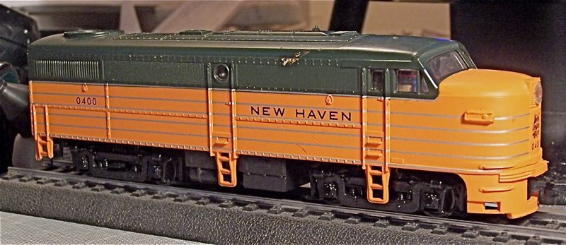

I've been sitting here with a DVM thinking, "it can't be this easy." The motor brush leads are isolated, but the motor casing is not. But that's okay, because the wheels and power are totally isolated from the frame; nothing is grounded to the motor can or the frame. There's a long "circuit board" along the top of the frame (you can see it in the second photo above), and I use the term circuit board loosely because it's basically just two strips of copper. At the rear, the wire from each side of the trucks are soldered onto terminals on each side. At the front it's the same with the addition of the headlight also being soldered to the two terminals. In the middle of the board the motor wires are soldered to two terminals, one on each side.
So really, it looks like all I'm going to have to do is desolder the two motor leads and attach them to the appropriate decoder leads. Then solder the appropriate power leads from the decoder to the terminals that the motor leads were removed from. Remove the headlight and resolder to the appropriate decoder leads (or, in my instance, replace with a golden glow LED). Attach the decoder with some double-sided foam tape and that should be it. If I have time, I may try it tomorrow night. (What appears to me to be an added benefit from leaving the circuit board in place is that it will help keep the wires out of the way of the driveline underneath.)

Did it, put in an NCE D13SR.
Easiest Install Ever.
It went just as I expected and wrote above. Loco runs very smoothly, too.
