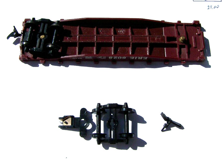

Ah, that's the sticking point, Helm. They are special trucks , if you look at the two loose ones in the photo with the flat car, you can see they're not a solid axle across, they're parallel axles. They actually bow apart to fit over the pin, the center ring that fits around the pivot isn't solid, it's two parts. The ones in the picture also have a plastic pin already in the center pivot point, to fit into the hole in the flatcar ( if there was one) I'm assuming later models did not have metal pins, they used a cheaper plastic pushpin mount like these, or these are of Model Power design for the Marx model which they acquired later. At any rate, you can do one of two things ; find original trucks (good luck ), or remove the pin from the chassis and replace with screws and nuts. Not sure how that would work, as there's no shoulder like on other rolling stock bases for the truck to pivot on. There's apparently also a special designed coupler arm with stiffeners to prevent it from swinging out too far when pushing the car instead of pulling, to prevent derailing. Another unique and successful contribution from Marx, but where do you get those coupler arms? My junkbox buddy who has most everything doesn't have those. So at this point, it's cannibalize other Marx cars for the parts, or luck onto some somewhere. I will probably take one truck with me to a Train show to look for some. OR...since Model Power acquired Marx molds...maybe???? they have them ? Hold on adangminute, I have some new MP work cabooses... checking...pulling flatcar back out....comparing...OohRah! BINGO! In da HOLE! Woooooooooooooooooooooooooooooooooo daddy! They're identical! Well, except for one thing...the new Model Power coupler has a Kadee knockoff, not the old hornhook type And they use plastic pins, not the metal ones. But the coupler and truck should snap over the older metal peg and work. So I think I just solved BOTH our problems, Helm! We'll just have to order entire trucks from Model Power. Ok, so make that we can now do one of THREE things. The easiest being order spare trucks and coupler assemblies from Model power for the older Marx rolling stock. The only difference I see between the old and new trucks is that the Marx trucks seem to be a hair thicker plastic, and it's very smooth, the Model Power work caboose trucks have a more grainy appearance. I can live with that Wheels and axles look identical, too....straight and thick, not tapered in the middle like some axles. Wow, what do they call this thing, an epiphany? Sudden realization? yup! Anyway, so problem solved, just buy new Model power truck and coupler replacements, and we're all set. Now I gotta go online to find some. At least it's a GOOD feeling, when you suddenly realize there's a solution in front of your face. LOL.

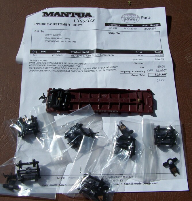

HI; The part is FCT-8001 at $4.00 each. How many do you need ?

1 - parts - what I received , I ordered 6 sets. The one on the flatcar is original. You can only see a slight difference in the plastic patina, pebbly versus smooth on the Marx original. But it fits fine, so the graininess doesn't bother me.

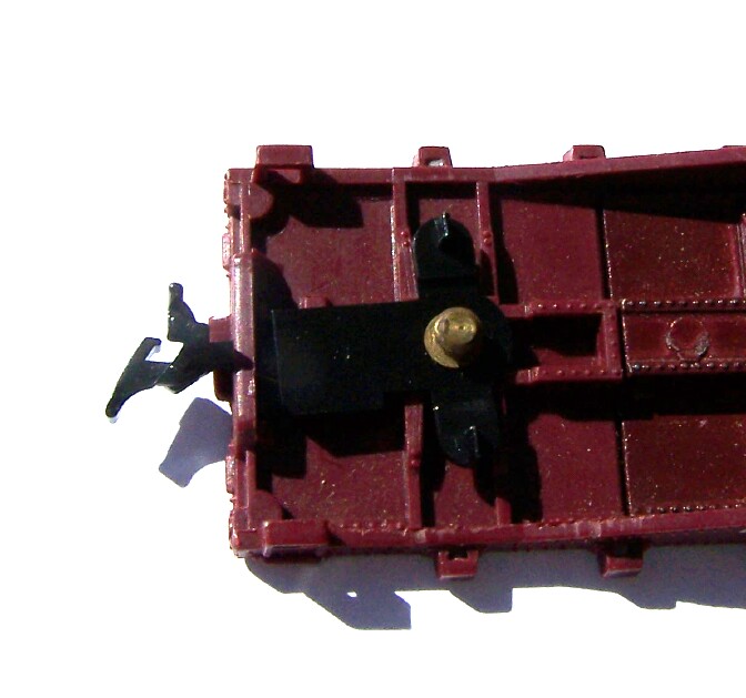

2 - close-up of truck assembly
3 - Installation of coupler arm over pin

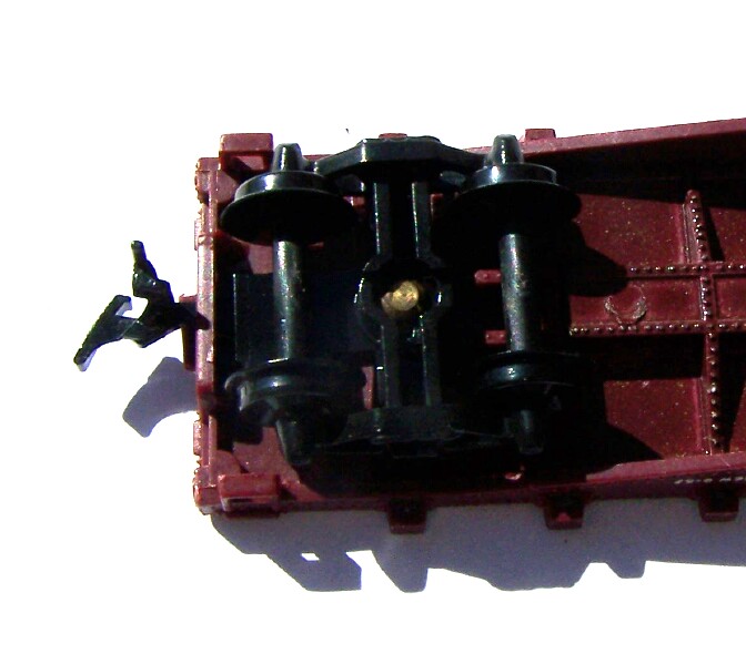

4 - Installation of coupler ( horn hook to match original) - a bit tricky lining it up out of sight.

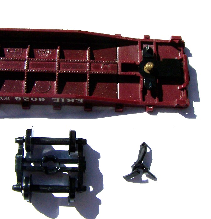

5 - Installation of truck - snap on, presto, it's repaired!
So, at $4 apiece per truck assembly, not exactly cheap, but hey, you can repair your vintage Marx now! Sweet. The P/N is FCT-8001 , that is the truck, horn-hook coupler, and coupler arm. everything matched up EXACTLY ( how often do replacement parts do THAT?!), so well worth it to me. You can find the price list at : WWW.modelpower.com/contactus.html ( in other words, request it via email. I didn't find one online ).
