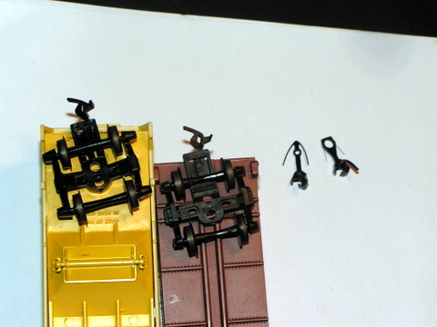

Thanks for the info.
Here is what i have . The box car on the left is Tyco, on the right Hong Hong???
The two couplers is what the Hobby Shop guy gave me. The one on the right with the larger hole is for engines with body mount screw.
The one on the left was suggested for a replacement for the horn type. It requires carefully lifting the arm enough to slide out the old coupler and sliding in the new ( bad picture). I'm not sure in looking at the Talgo adaptor that i can use it on the Tyco or at least i can't figure how it would work.
Bottom line now that i know there are Atlas dead ends i won't waste time and money and possibly breaking the plastic

Unfortunately, many makers from Bachmann to Life Like used Hong Kong manufacturers to make their stuff, but usually put their names on it as well. Model Power I think also used Hong Kong.
The one on the left was suggested for a replacement for the horn type. It requires carefully lifting the arm enough to slide out the old coupler and sliding in the new .... I'm not sure in looking at the Talgo adaptor that i can use it on the Tyco or at least i can't figure how it would work.
there's just a small nub of a plastic pin holding the coupler, plus a plastic tension arm to hold it in. You have to lift that plastic arm to tilt the old coupler up, then pull out, and reverse install the new one. Not sure how big the pivot pin is, but it should be correct. Mine looks small on the BN boxcar and gondola I looked at to compare to your picture. It will be easier to just pull the whole truck off the body and replace it that way.

Okay, cool. You're a step ahead of what I wrote. The one on the left is great. Just carefully lift the tab and drop it in. There's no "harm" in that. They were designed to be replaced if broken. The talgo adapter I pointed out would have allowed you to put the one on the right into the tyco truck. The adapter makes a fatter post for the coupler to attach to. I'd use the one on the left since you have a source for them. Sounds like you have a decent hobby shop. Be glad about that, not all of us do any more.
I don't know what you mean about the Atlas uncoupler "breaking the plastic." They simply unhook the couplers the way they're designed to. But I understand not wanting to invest in outdated technology.

""I don't know what you mean about the Atlas uncoupler "breaking the plastic."""
In lifting the plastic tension arm on a small switcher it snapped. I'll have to drill and tap the lead weight, it's the only thing available to screw into, and use the Magne-Matic with the larger hole..
I've already converted one car and it seems to work
That said I found an Atlas HO scale dead end uncoupler on line, a lot cheaper than investing in knuckle couplers. which is the way I'll go.
Replacing the trucks with metal and body mount couplers is more money than i care to invest.

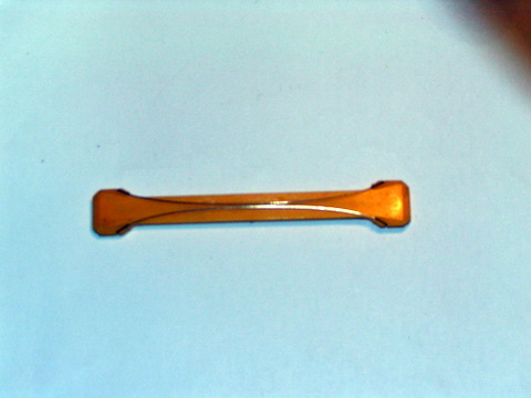

might have spoke to soon.
they stopped making the dead end coupler in 2003. Couple of web sites say they have them but i didn't try ordering
Some where way back in my memory i remember a yellow strip with a wire on each side running parallel. The strip was laid inbetween the tracks.
wasn't that a decoupler?

hey, nice to know my memory hasn't gone.
I dug through all the stuff i got back from my friend and look what i found and it works.
Thanks Ken
Now to find more
