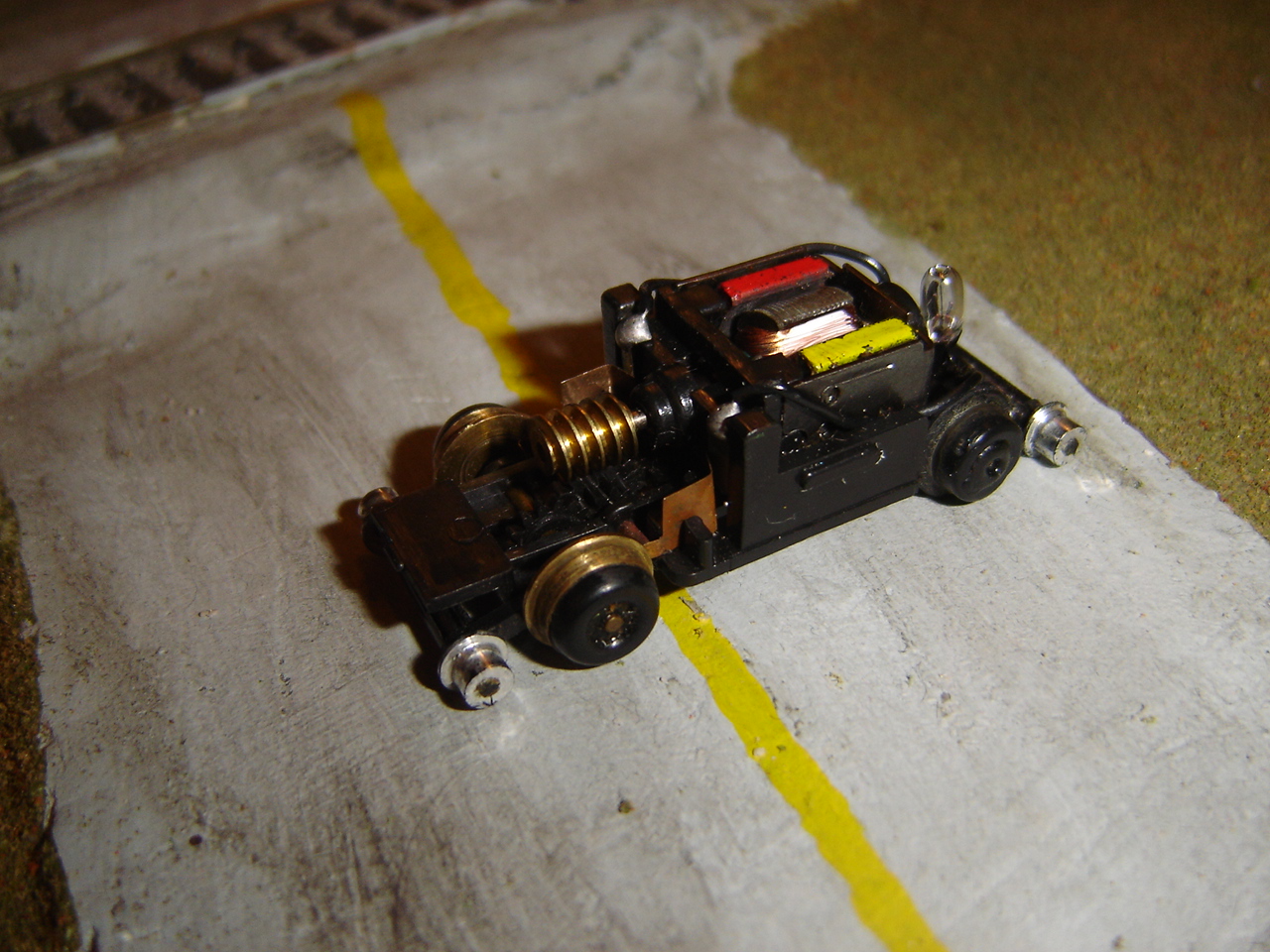

Hey everyone. I picked up a Bachmann Trackster a few weeks ago in really nice shape. It does run, but it's pretty dirty. The metal wheels and wipers need a good cleaning. The motor runs VERY HOT. How does this thing come apart and how should I go about cleaning the motor? Thanks!

Ok, carefully remove the two copper contacts up front with small needlenose pliers or tweezers ( you might want to do this over a big bowl, or white paper, so they don't go flying, they're not springy much,but they have some tension. ) After that is the trickier part - those two black plastic posts on either side of the silver contacts with wires soldered to them, need to GENTLY and SLIGHTLY spread them apart. I used my fingernail to pry upwards on the worm gear, and pulled first one post GENTLY, then the other, apart slightly (outward ), and it releases the front of the motor. Then just pull it up and frontwards to disengage from the loop plastic in the rear which holds the bearing stub. Pretty easy! Getting into the copper contact area of the brushes looks difficult, but not undoable. My gear shaft turns relatively easy, see if you have to work at it to turn it, it should not be stiff or require much effort. If it does, could be the bearings, or dirt, or bent. Or burnt up wiriing. Look for discolored wire, it should be bright copper color, if dark or blackened, could be a sign of overheating, and the motor may be junk. Judging by the picture, though, it looks bright and shiny. Have fun with it! Is yours the Jeepster or van?

The copper wiring in the motor actually has some white build-up on it. You can see it in the pic...it looks like reflection from the flash, but it really is that colour. Hopefully I can clean it

Alcohol should be fine, but don't soak it too long, or it may take the paint off the magnets and armature. The white stuff isn't corrosion, it's some kind of lacquer to hold the windings in place, I assume. Some manufacturers use it, and early Kader did.
