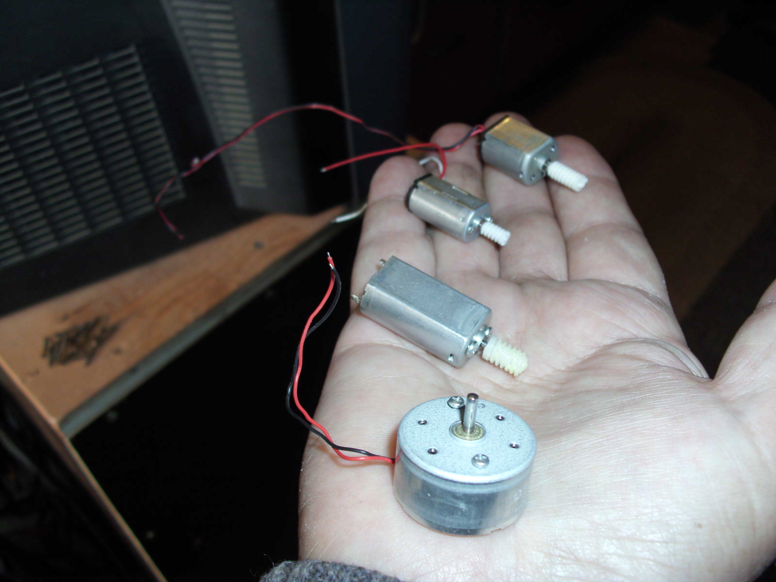

Sorry for the long story. Here's my question. I tried to run the Tyco engine. It ran so so on the steel track 16 inch radius after i gave the track a good cleaning. When i put it on 18 in brass circle it doesn't have any traction. The wheels spin, i give it a nudge, it goes about 2-3 ft and slows and stops, the wheels keep spinning, no cars being towed.. I notice the plastic drive wheels on the tender are grooved. Is this O K or is it from sitting and spinnng from previous use? Any way to give more traction?

All is not lost with your Chat, many of us here remotor them with CD ROM drive motors. It sounds like your traction tire---little O rings on the drive wheels---are shot and need replacing, hence no traction.
