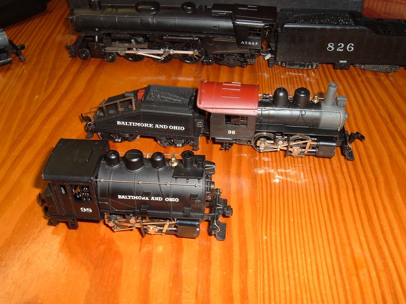

At first I thought the two Ebay engines were tyco Dockside engines, but they're Rivarossi's. I took the first one totally apart, and found in the motor the following :

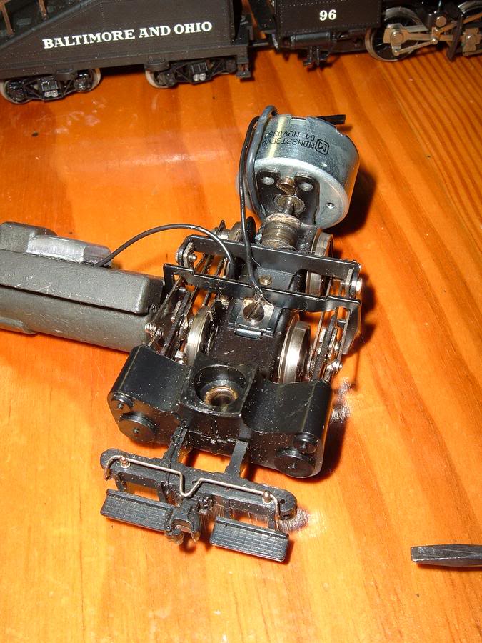

One brush jammed, not moving up and down, not touching commutator.
One brush replaced with a copper wire mesh, burnt on one end, apparently not touching anymore, either.
Well, don't that beat all. I cleaned out both brush chutes, and then got some brass finishing nails,and used those to stick down onto the commutator pads. After cranking the power supply up past halfway, the motor finally turned over and ran rather smoothly. Ok, so I may just need some repair parts for this one. I haven't taken the other B&O dockside engine apart yet, it didn't move either. PRobably something similar. Since I now have experience on one unit, may as well tackle the other one to see what's wrong with it. Both look clean and unabused, although the mesh trick was rather funny. I guess it'd work ok for awhile.
Is there any source for generic brushes, or would I have to look for Rivarossi types, you think? They don't look much different than the Athearn types I got to repair some of my other diesel engine motors. If I can find my leftovers, I may try them. No telling where I put those extra brushes right now, though.
While taking it apart, I also removed the little driver rod shoulder screws,and took off the main rods. Now I have a more prototypical British steam driver system, and I'll have to find that Lady body I wanted to power to see if it'll fit underneath. More fun ahead!

Can you measure the brushes with a micrometer and post the dimensions?

Hi Guys. The Rivarossi Part number for the brushes is: 109-550 and the AHM part number is P-120-032. you get one of the wire mesh brush and one solid brush Approx. cost $3.00 a set. They pop up on eBay from time to time. Carl

Why a wire mesh brush? Most motors use two solid brushes. One self-cleans the commutator pads? Maybe...interesting.
Anyway, I found a vendor/ seller on Ebay, name of :
http://stores.ebay.com/K4-Supply-Company?_rdc=1
He has more than 10 sets of 4 brushes each. I just bought 2 sets, 8 total brushes , $5 per set of 4.
As far as measuring the brushes? I had to dig out the solid one with an Exact-0 and pick tool, so it disintegrated, it would not budge in the housing. The wire mesh one came out easily enough, though. since it gives, doesn't do much good to measure it, although I could do an approximation. But since I found a seller for Rivarossi / Athearn brushes, and he showed pics of several motors, one of which was in my 0-4-0, then I'm certain it's the right ones. Another happy Ebay customer! LOL. Thanks for supplying those P/N's Carl. Always handy to have the correct #'s.
 Posted - April 04 2010 :  04:33:59 AM Link directly to this reply  Show Profile  Add NickelPlate759 to Buddylist
The brushes K4 sells are both carbon, which IMHO is probably better. I can only assume that Rivarossi used one mesh brush to polish the commutator, but I don't really see the need. Commutators get fouled either by oil, or brush dust packed into the slots, and neither situation is going to be remedied by mesh. It's just another one of RR's interesting quirks, like their early ball bearing motors.

Guess it was worth a shot experimenting. Never seen a mesh brush before in a motor. I'd think it'd wear out long before the carbon type, it sure was burnt on the end.

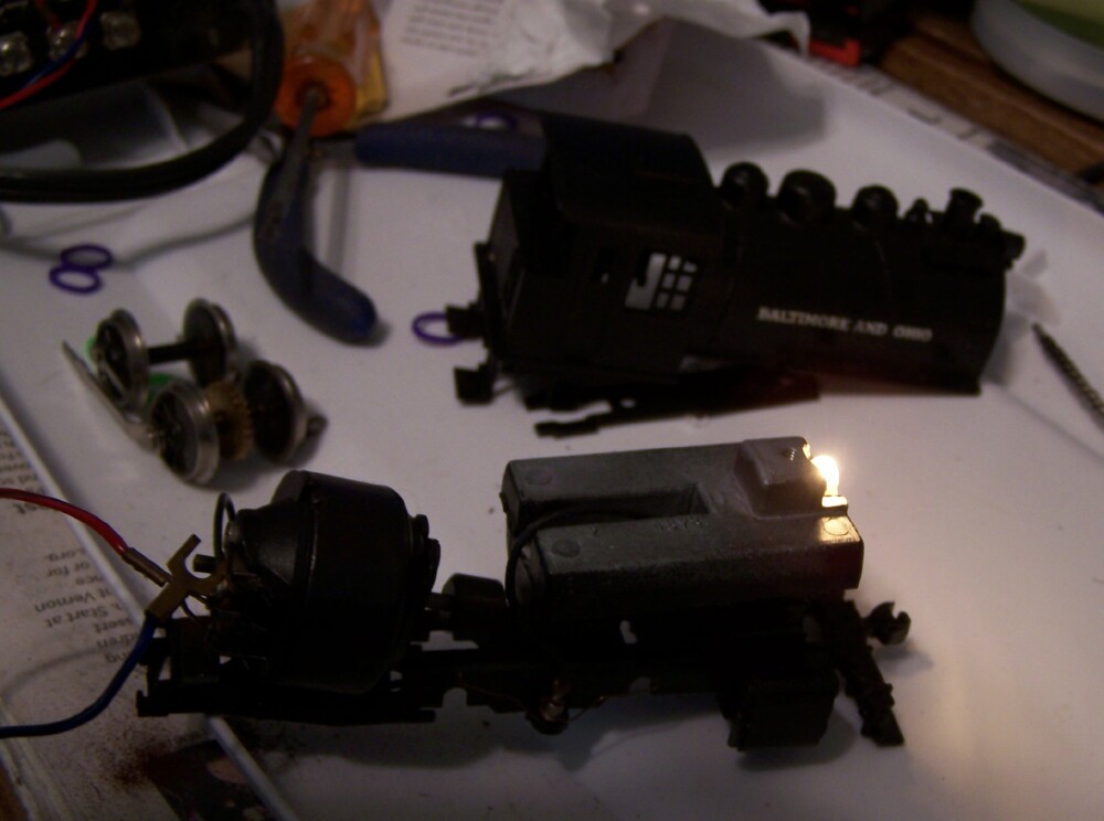

2nd 0-4-0 Dockside maintenance review - I started taking it apart right before bed, the motor was locked up, some rust on the outer casing, probably stored in a basement Anyway, I took my pick tool and got the armature moving, although it was doing a bit of grinding when I finally broke it loose. That was enough, it at least wasn't totally seized.
Got up this morning, let the coffee out, started the cats, waitaminute that was the OTHER way around...anyway, had some waffles, then got back on #2 . Sat down at my PC keyboard shelf to work on it. Spun the armature around with the pick tool a bit more, then hooked up a transformer to it ( he wasn't happy being woken up, either), and lit the electrical fire....had to crank it up to 3/4 power and spin the worm gear a bit to get it to move, then it took off and ran, so I just let it go, it ran rough for 10-15 seconds then started to smooth out. Light bulb up front even still works in this one! A bit noisy, but with a drop of oil on each bearing, should probably be alright. WOrked the throttle back and forth, it seems to do ok at slower RPMs now as well. I'm rather pleased with this one, even the driving rods are nice, they were bent on the other unit, the inner ones, these are all straight.
(sipping Folgers) Wow, I'm suddenly getting good at starting AND finishing projects! Amazing. I think #2 should be running the oval today without question. #1 Dockside B&O will have to await the arrival of K4's brushes i bought last night, to see if it'll also be revived. Glad it's just a cheap fix, and not requiring a whole new motor ( although that would be fun, I'm looking last night at a website that sells surplus small DC motors, I'm thinking of getting a lower RPM unit to repower some of my Hustlers and now maybe these steam engines ).
( Immediate update ) Just oiled the two bronze bearings, now it's really running smooth :
Amazing what a little maintenance can do. I'm happy. I'll let it break in a bit on the repair bench, then reassemble it and see how it works on the tracks.
One brush is a copper wire mesh, burnt on one end, apparently not touching anymore, either.
Originally posted by AMC_Gremlin_GT - April 03 2010 :  8:27:31 PM
UPDATE on repair :
I got my Athearn / Rivarossi brushes today from K4 Ebayer, they're little hollow-core solid units, no mesh ones with these. Size is 0.094 inches by 0.256 inches, hollow on one end for spring. These are looser than the originals, although that might have just been due to crud. I started to reassemble the motor, and the first spring sprung away, somewhere on the floor....ARGH! ( insert cuss words here ). Took me awhile, but I turned off the light, got down with a flashlight, and finally saw it laying in a plastic lid on the floor under a box. Whew! Retrieved that little guy, and held it over a box AGAIN ( was trying not to lose it, it sprung away anyhow ). Got them both on, and hooked up my Model Power power supply with mini J-clips to the connections. Motor sprang to life at 1/2 throttle, and ran fairly smooth. Did have some up and down rpm idle issues, but otherwise it ran ok. So I think it's going to work, and I'll reinstall it in B& O Dockside engine #1 tomorrow night and try it. Looks like these Riva motors are fairly easy to fix, once you get them apart and oiled / cleaned properly. Not real happy with the little tiny spring contact, not much contact area. I noticed the other unit's motor was hot after just 10 minutes of running. Maybe that's normal.
Anyway, another Rivarossi Dockside will hopefully be running around soon. That's all for tonight, I think.

They tend to run a little warm, but I've never had one burn up. They seem to run cooler after they've been well broken in.
