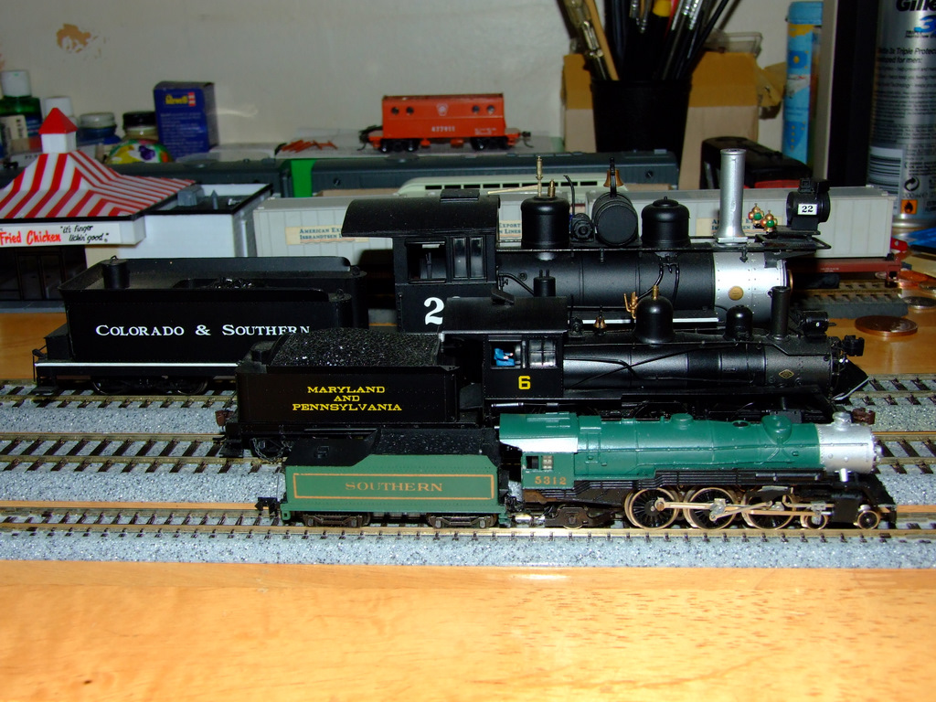

on30 is o gauge running on ho gauge trucks,but hon30 is ho running on n gauge trucks as is hon3,the difference is that 30 depicts 30 inch gauge and 3 depicts 3ft gauge ken
left on30,o gauge body,ho trucks,right ho,cannot understand why it was called on30,would make more sense to call it oho30

 Posted - March 16 2010 :  3:46:24 PM Link directly to this reply  Show Profile  Send catfordken a Yahoo! Message  Add catfordken to Buddylist
on30,ho,n gauge scales
