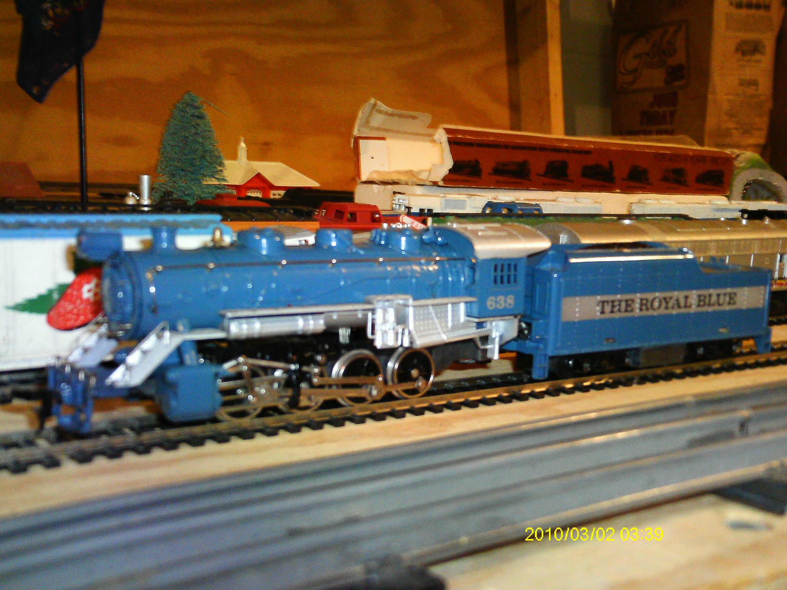

My father dug out his royal blue today(we each have one). It has not been run since 1987. all that happens is light comes on and motor hums.I am about to take it apart.It has never been opened up since new(1977)wondering if suppose it probably needs a good cleaning. I even put power directly to the wheels-same results.

It's probably got a good case of peanut butter grease, so it should be fine after a good cleaning and lube.
 Posted - March 02 2010 :  5:14:55 PM Link directly to this reply  Show Profile  Click to see DaCheez's MSN Messenger address  Add DaCheez to Buddylist
+1 on the cleaning. If its humming, it may just be that the armature is stuck. I've fixed one or two humming engines by taking the wheels off and then rotating the metal gear with a toothpick.

well i popped it apart and the metal frame in the tender fell apart-it was cracked. anyway the motor is locked up so im getting a junker chattanooga for parts and im gonna rebuild it then.funny,it sat in my dads drawer for 20 years in the original box,away from everything.oh well ill get it running soon.thank yous all for your input. J.

"Locked Up"...as in rusted or..? I've had an Athearn engine that's armature was rusted inside the magnet, but I've never seen anything like that on a Tyco O_o FYI, if it is rusted, you should be able to free it by soaking it in some rust remover...the name of the stuff I used escapes me at them moment
From what you described however, it sounds like a junker loco is probably your best bet.

I tried the took pick trick,no good so im swapping motors from a junker chattanooga. should be up and running soon-when everybodys asleep,when i can do my work undisturbed lol.

Several of us have had great success with CD ROM drive motors, something you might want to consider...I'm still looking for a junker for its shells myself...
/tyco/forum/uploaded/shaygetz/remotor2.jpg
/tyco/forum/uploaded/shaygetz/remotor3.jpg
They run really well...
http://s126.photobucket.com/albums/p96/1shaygetz/videos/?action=view¤t=PA060189.flv
I do have an assortment of Chat drive parts that you are welcome to, you should be able to salvage the various missing screws, gears and clips from the other one you have.

I got her up and running again,thank you guys for all your input.-J.
