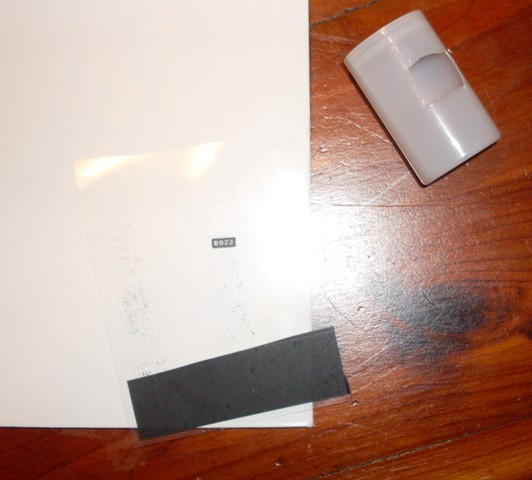

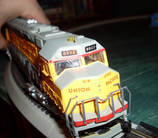

I fixed my problem today. I took the other numberboard to work and put it on the photocopier. I made a copy onto a transparency sheet...that's the clear "paper" teachers use on the overhead projector. That came out nice, but was too clear. So I cut out a piece of translucent plastic from a film can and glued the copy to it. Then I cut the whole thing to fit. The printing is not quite as dark as the original, but you can only tell if you stare directly into it while it's running.

Here are some quick pictures. The first one shows the board with the loco at full throttle and lit up strong. You can see that I need to make the transparency darker. You can also see some glue mess I made...I'm kind of a slob some times. Without the lights, they look identical. Eventually I will redo this with a darker transparency.
Of course, the camera flash brings out all the little flaws you can't see in normal light.
This second pic shows the materials. That's just a leftover scrap of the copy-safe transparency sheet (8.5 x11) with a copy of the number board on it. I ran off three in case I messed one up. The film can is the one I used for the backing. It added some opaqueness and gave it a body. The plastic flattened out easily.
It's not perfect, but it works. I'm sure someone with better modeling skills could do an even better job.

neat job Also it matches the real one in North Platte, NE
