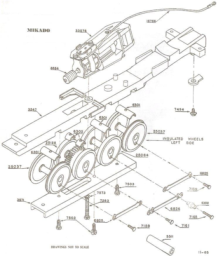

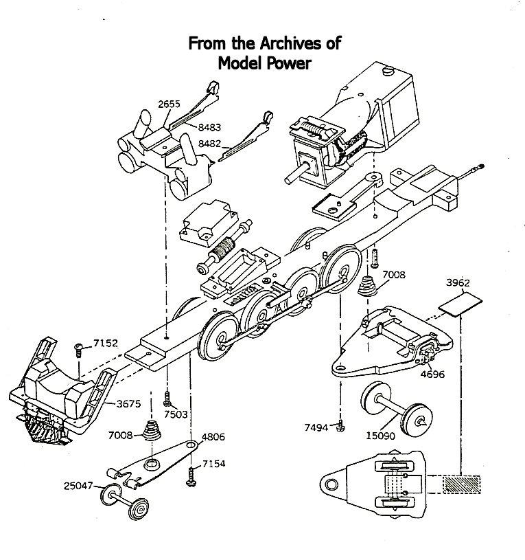

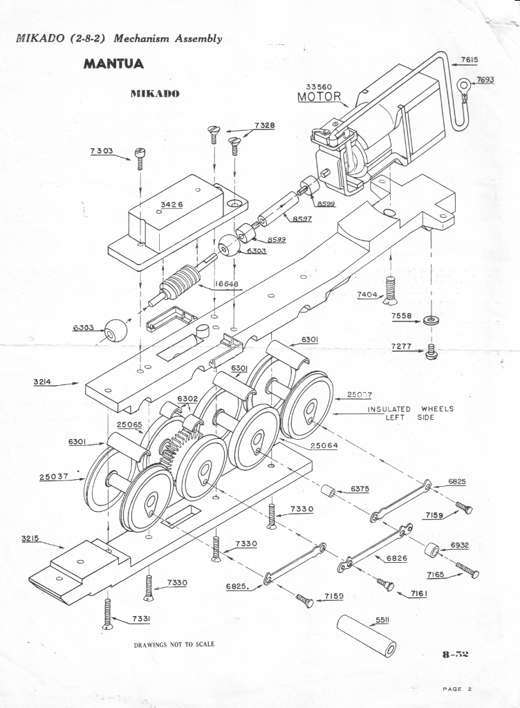

Mantua had three different drives on their larger steam engines. On the brass boiler Pacific and Atlantic, they had a fully enclosed gear case, very nice, very pricey. On the early diecast Mikado and Pacific that Todd speaks of they had what the parts book calls a gear cover (3426) which held a short shaft with a nylon 48 pitch worm gear (16648) running in self aligning bearings (6303) driving 26 tooth gear.. Sometime after the launch of Tyco RTR the cheapening of the product began. This gear cover drive was eliminated along with the larger motor that drove it. I have never been able to pin down the exact year this happened nor have I been able to date the adoption of the plastic cab and tender shell. I do have a 1955 Tyco set that features the Mikado with gear drive cover but 1965 parts manual shows the Tyco Mikado with a small motor and a 56 pitch worm driving a 34 tooth gear.
It appears that Yardbird part D8124B is the same as the Mantua gear cover (3426).
To mount this part it appears that you would have to layout, center and drill and tap 3 holes.
If your gears dont match up it appears you would have to mount a new drive gear and re-quarter the drivers.
Even in the best of times I would have had difficultly doing this modification. Now, with bad hands, its impossible. So, Ive cast around looking for options Of course you could contract with one of our fellow Forum members who are mechanical geniuses and take great delight in doing this sort of thing Or why not acquire an older Mantua-Tyco with the parts mounted and so all you have to do is install a can motor

The D8124B isn't the same as the Mantua gear cover (3426).
It is the same as the 80s Power drive gearbox and mounts with 2 screws into existing holes in the frame.
http://www.hoseeker.net/mantuainstructions/mantua282mikadopdinstrpg4.jpg

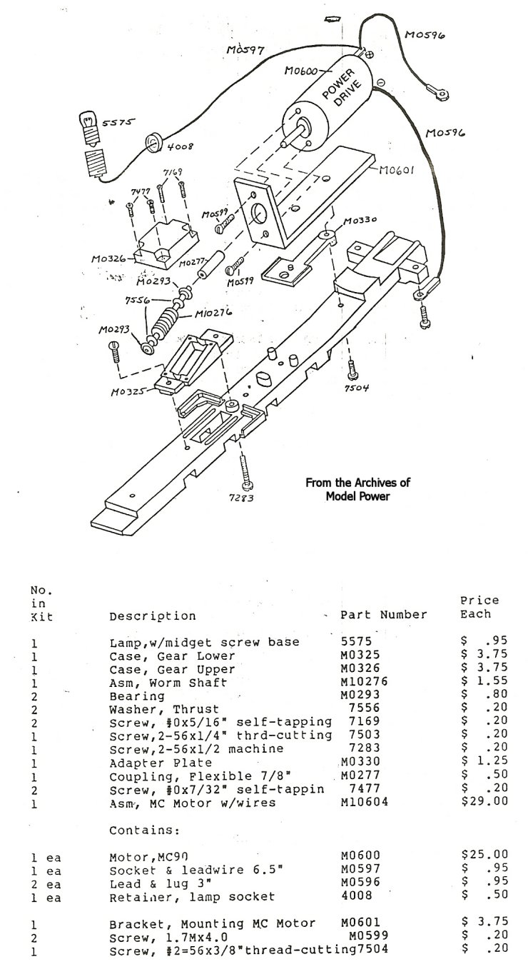

The gearbox castings are die casted metal.
I'm guessing the same as in the retro fit kits.
http://www.hoseeker.net/mantuainstructions/mantuaretrofit811pg2.jpg

In the instructions of the earlier retro fit kit (#810) It says that some frames may need the front hole drilled out.
The front hole is the same hole that is used to screw the bottom plate to the frame from the bottom. (second screw from the front)
Apparently some were drilled all the way through and some were only drilled part way through. So some frames will require drilling. The screw provided with the gear box is a self tapping screw.
