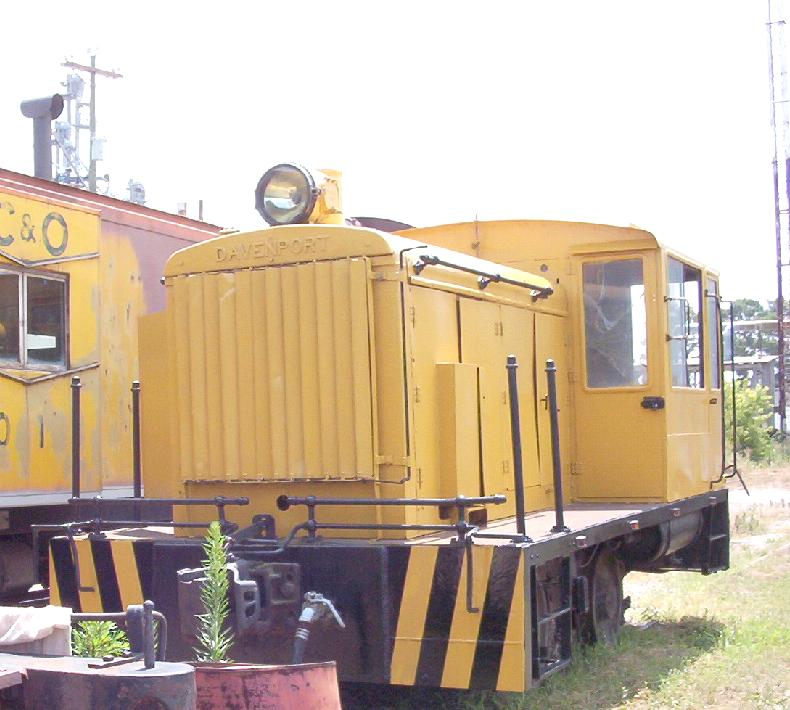

I'm looking to strip the paint off my Davenport, I didn't realize just how poorly I had painted it until I got around to mentioning it in LOTW again!

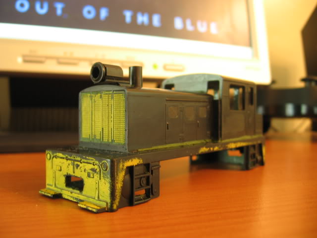

I figured there would be some PineSol around at least. I did find some oven cleaner though, and it is working quite well. I'll see if I can post a picture or two when it's done.
I'm not sure what the new paint job will be just yet...I might make up a paint scheme, or follow one of these pictures:
Decisions, decisions!

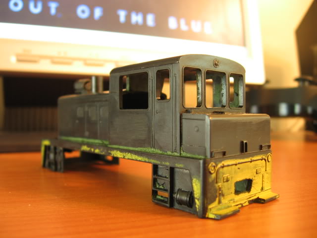

Here's how it turned out:
Keep in mind that it was coated in a thick, ugly green spray job before:
The remaining yellow paint is quite smooth, so I will probably just sand it a little bit and paint over top.

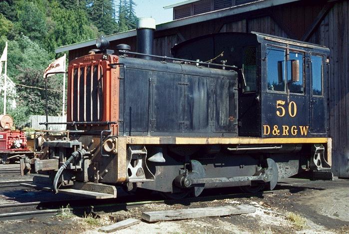

hey MM 1498 that #50 D&RGW is avalible in G Scale
MM 1498
ICRAvatar
 Posted - June 20 2009 :  6:00:38 PM Link directly to this reply  Show Profile  Click to see MM 1498's MSN Messenger address  Add MM 1498 to Buddylist
That's pretty neat. Hopefully it will be in HO soon enough.
