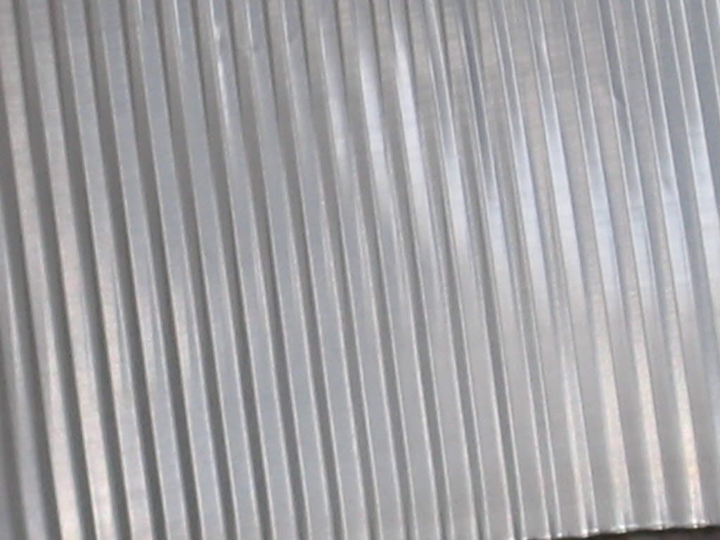

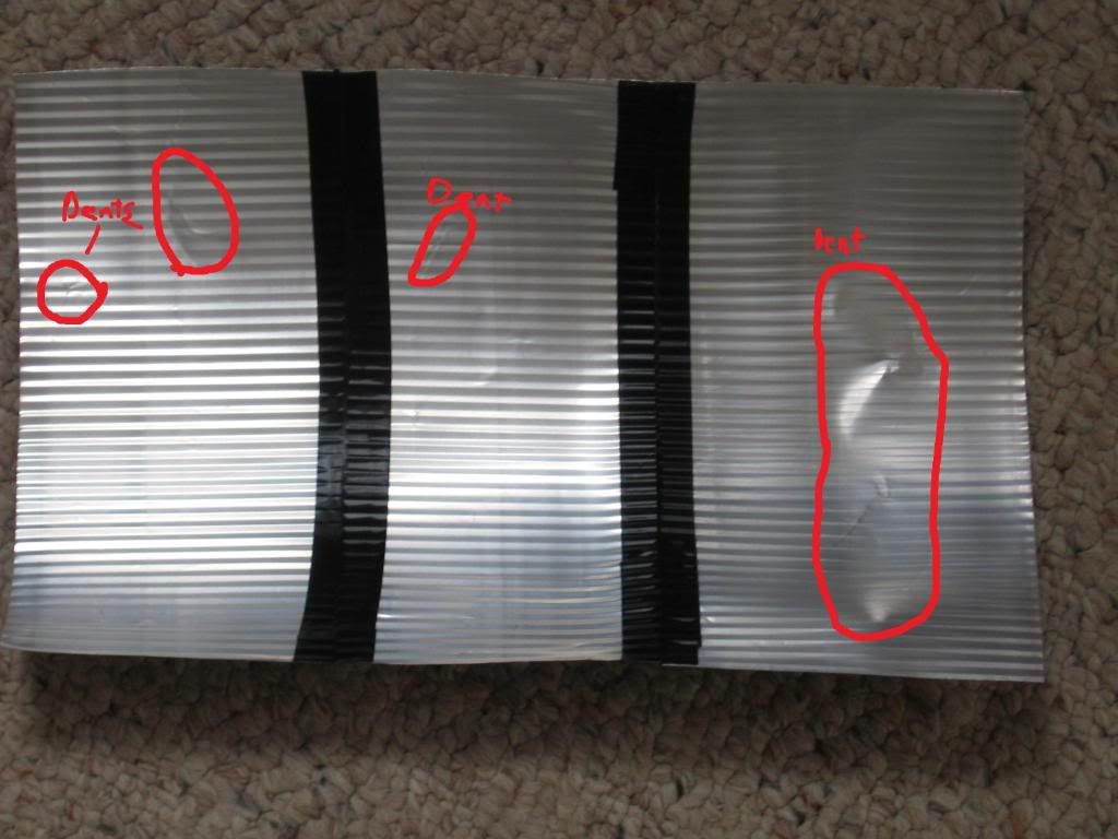

Ok, I got the pictures, but first I have a question: How to join the sheets together? As of now I just taped them with electrical tape, and it looks kind of like a modern building (what I was trying to build), but not very realisitic. Maybe I could solder them or hot glue them? One other problem is that they curl up when you crimp them, but I think this could be solved by squeezing them in some kind of vice jig before crimping. I'll try this and post my results. Here's the pics:
Several sheets joined together with electrical tape (the dents are circled):
Up-close of my best sheet so far (no dents whatsoever):

Another great discovery! Good news and bad news. bad news is that the vice jig didn't work too well . . .they straightened a little bit, but not much. the good news is that I found a different way to solve the problem of straightening the sheets. It also fixes one other interesting problem. I think that when they make pop cans, they make the outside sort of like a "C" shape. In other words, the middle of the sheet of aluminum that you get when you cut the top and bottom of the cans off is raised up higher or down lower than the surrounding material. This proves to be a problem, but as I said before I found a solution! Ok, so what you have to do is cut the aluminum sheets (after you crimp them) into 2" x 2 3/4" rectangles. Then you hot glue them onto strips of balsa wood, or any other kind of wooden strips. This makes sort of a fence, but when you overlap different strips you get one big sheet, that looks pretty realistic. Plus this solves the problem of the "C" shape of the metal because the pieces are so small it doesn't matter if the middle bends out a little bit. By the way, I will be away from the forum for three days (April 6-April 8) so don't hold your breath for pictures
