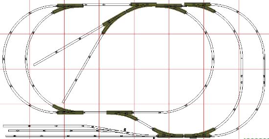

 Posted - March 13 2009 :  11:48:07 AM Link directly to this reply  Show Profile  Click to see MM 1498's MSN Messenger address  Add MM 1498 to Buddylist
I'm strongly considering this plan, unless I can find something else that looks even better.
Because there are lots of different sidings, I could wire them seperate and leave a train parked there while another goes around the loop.
The small freight yard at the bottom would be great too, since it is right at the edge I could uncouple cars easily by hand.

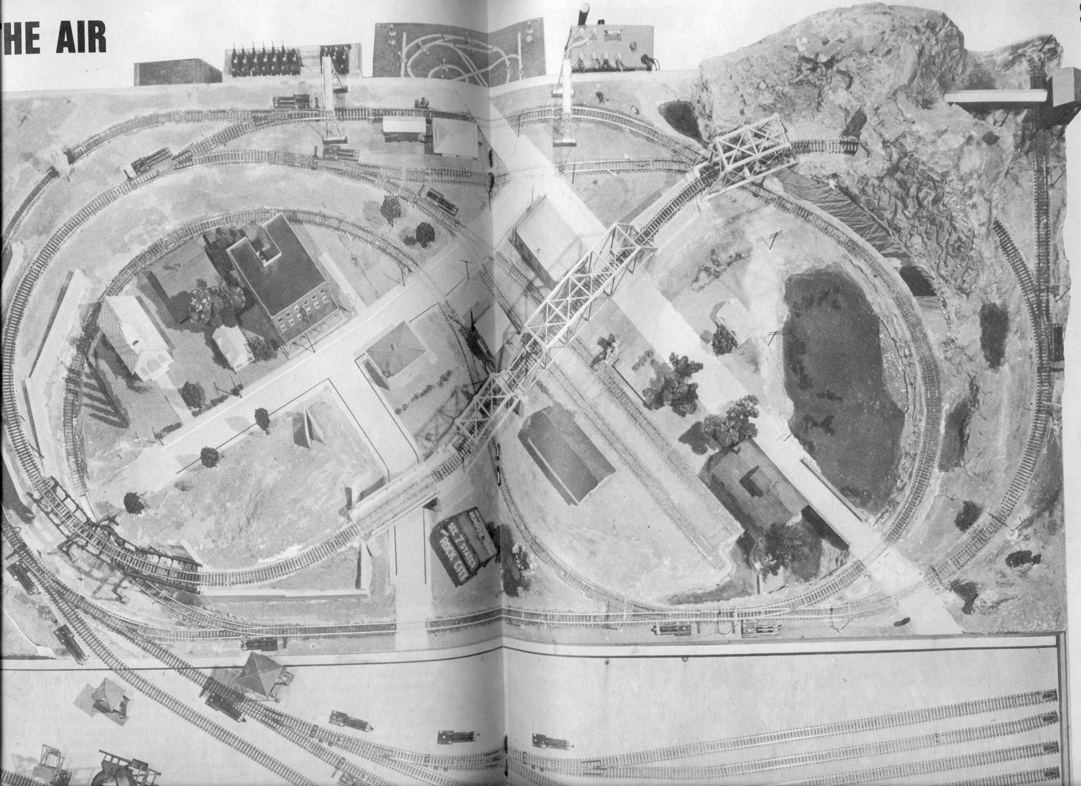

 Posted - March 13 2009 :  2:40:50 PM Link directly to this reply  Show Profile  Add romcat to Buddylist
Hey Pal:
I have a old book by the 50's editor of Model railroader , can't think of his name; Linn something. anyway the book is a how to from beginning to end witha skyline route and all sorts of fun...
I'll try to attach a diagram...
I found it, Linn Westcott.
Hope the diagram helps?

 Posted - March 13 2009 :  5:19:57 PM Link directly to this reply  Show Profile  Click to see MM 1498's MSN Messenger address  Add MM 1498 to Buddylist
Hey romcat, that is along the lines of what I'd like to do. Track plans form the 50's seem to be made so they're fun to watch, instead of simpler to look more realistic.
If you find any 4' x 8' track plans, let me know would ya?

 Posted - March 13 2009 :  5:41:13 PM Link directly to this reply  Show Profile  Add romcat to Buddylist
Hey:
Except for the fold down yard, that is a 4x8... Your library may have the book the the Ho Model railroad that grows in the system. Check their catalouge....

 Posted - March 13 2009 :  9:06:18 PM Link directly to this reply  Show Profile  Add Mike to Buddylist
Hello Gareth, I have a few of Linn Wescott's books, "HO Primer" and the picture you have is from "HO Railroad that Grows".

 Posted - March 13 2009 :  11:14:12 PM Link directly to this reply  Show Profile  Add GoingInCirclez to Buddylist
The track plan you posted looks somewhat similar to the Red Wing Division plan that I picked for the STC. The corner yard, the triple-tracks on one end, and the internal spurs are all similar.
Only trouble I see with that plan is curved passing siding on the left end. It's going to be compressed such that what, maybe 4 cars would fit... unless your era calls for shorties.
One thing to keep in mind is car lengths. If you don't plan to run cars longer than 60' in length, that plan should work. But if you do, you'll ideally want 22" curves wherever you can (at least for a mainline run).
The STC is compressed to 18" on that narrow end by the yard... the 89' cars will run there but it gets hairy sometimes. And only 2 of those would fit in a theoretical passing siding there.

 Posted - March 13 2009 :  11:26:08 PM Link directly to this reply  Show Profile  Click to see MM 1498's MSN Messenger address  Add MM 1498 to Buddylist
The longest cars I plan on running are my 72' Con-Cor passenger cars...I know 22" radius would be better for appearance and performance, but I would be okay with 18".
That left siding is actually identical to the design of the track I had down previously. I had no problems with it, other than that space was limited as you said. But it was the perfect size for a small switcher carrying a few cars.
