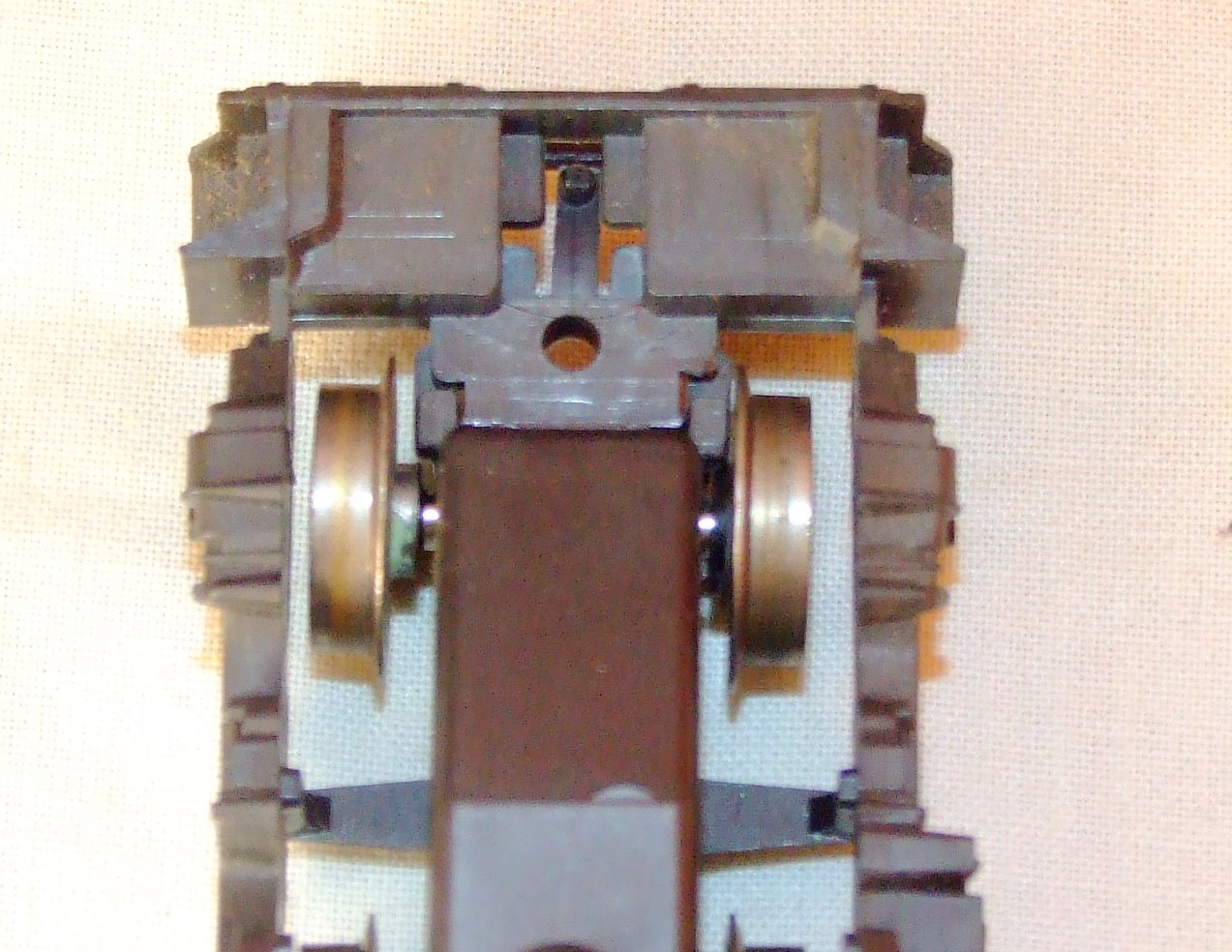

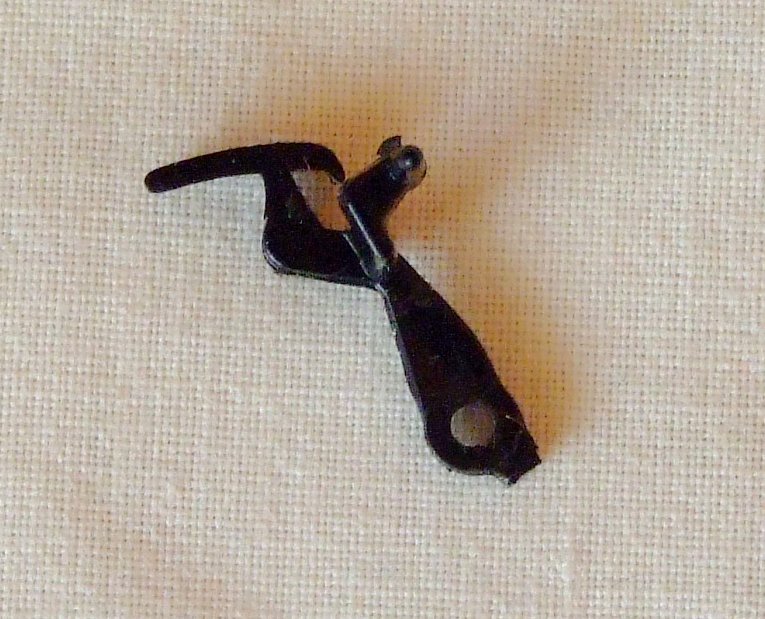

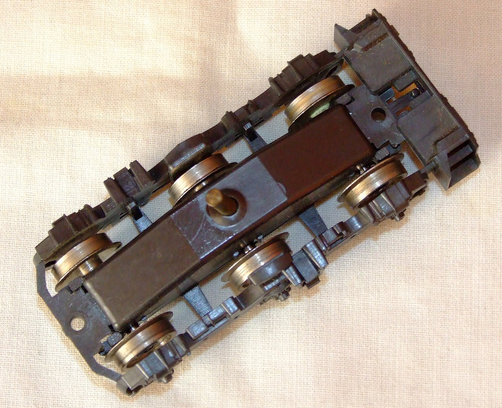

right here goes i have a lima fp45 which i want to fit bachmann ez couplers to,so tried tyco style to see if i could firstly get it to fit,yes it does but only if i cut return spring (the little plastic extension) off,do not want to alter the frame if possible,anyone got any ideas ken

hi mm1498,thanks but still leaves me far to much overhang at rear of the hole ken

If the hight of the coupler is right then you could use an Athearn or MDC coupler (or bachmann ez couplers) with one of the KD bushings.
